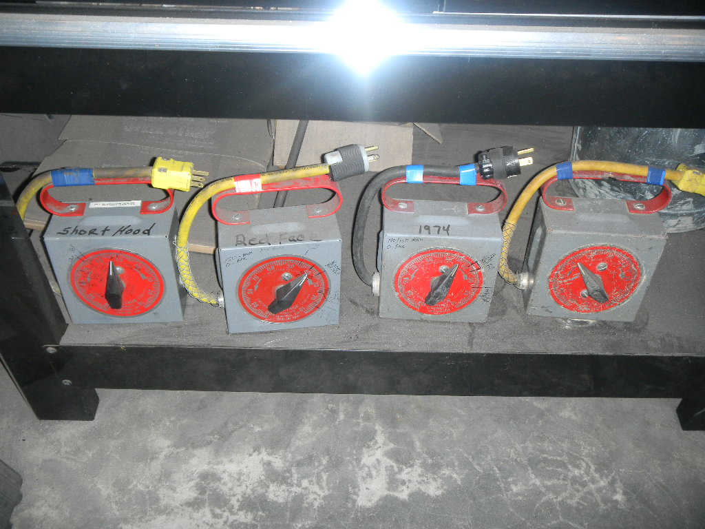

im wondering if I can take a simple 12v dc motor (say autmoboile power window motor) and wire it up to a transformer weldors output (rectified side of course) and use that motor to adjust the weldor? would it be too much voltage for the motor? im guessing open circ voltage might be 30 volts? im not sure the idea is to use chain and gears or belts and pulleys to use the motor to turn the adj crank on the welder. thus I would be able to just use a up/down button to adj the welder and be easily made a wireless remote from there? anyone do this? or have any idea on this? the weldor isn't always easy to get at and a system like this would make life a lot easier. of course this would only be used when your not welding and theres no current draw on the system.

You want to power it from the welding leads? Miller used to have an amp set "pen" that I think did that on their industrial machines. Open circuit volts is normally in the 60 to 80 volt range. I think using any kind of motor to adjust the amps, it would be very hard to set the exact current you wanted. Depending on the machine, you might be able to set up a remote rheostat that is connected with an extension cord. I was trying to hook up a windshield washer motor to turn the throttle up and down on an old welder I had. It would have been easier because I could use stops and wouldn't need to set it in between settings. What machine to you want to hook a remote to?

You guys have more knowledge, and energy than I do.:cool: I just buy a machine with a remote.:)
