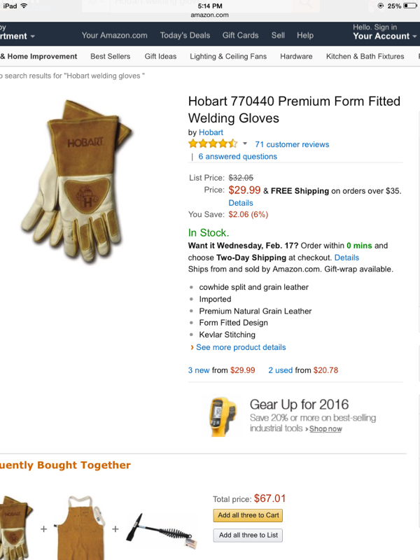

   / Welding Glove suggestions #7
I have a pair of Hobart gloves. I like to drag my left hand on the workpiece to support my other hand. I'm cooked after a few minutes of welding. If you hold farther back they work fine, but then my weld suffers. I have another pair I wear when loading the wood stove. Does anyone have any suggestions for protection for my arms? I have been wearing just a short sleeve shirt ( don't give me to hard a time, I'm just a newbie welder ) and my arms get "sun" burned every time I weld for more than a brief period. It seems my mig is more eager to "sun" burn me vs the stick.
