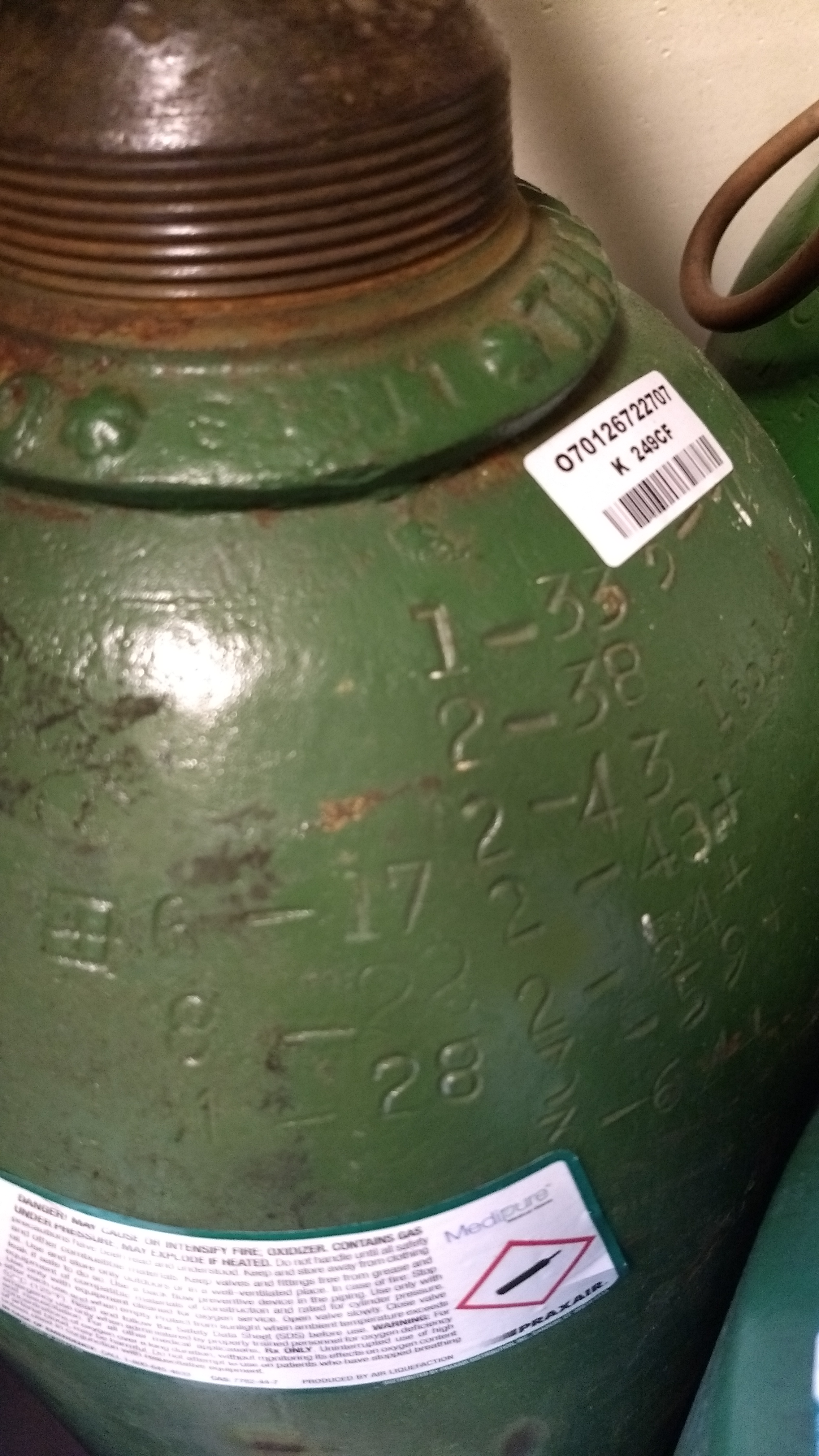

^^^ Yep... I still see those in the oxygen banks at the Hospital... if those Linde cylinders could talk!
Here is one dated 1917... that came through rotation last summer.
