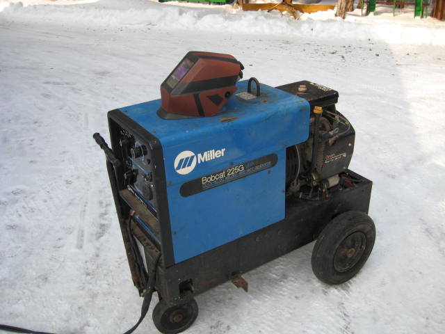

I have a miller 225 bobcat ac/dc, 8000 watt, 16 hp engine. I am very happy with it, I have had for 10 years bought used, never a problem.
Have you ever experienced TIGROTBNT (Things I Got Rid Of Tuesday But Need Today) Syndrome?
All the time:D
