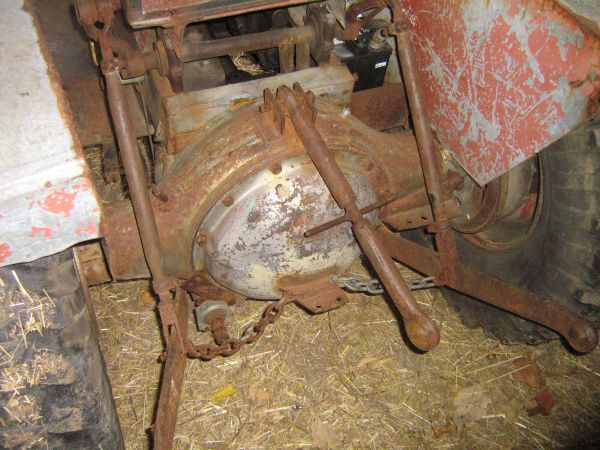

How do I weld shortened axles like this? How strong will they be? The attached picture is of a Chevy truck axle that was shortened to make a small tractor. Are those axles case hardened steel? Besides alignment tricks is there anything special about welding these? Thanks

I can't ever remember doing anything like this before. I would guess you'll need a specialty rod, proper preheat, and post heat. Along with the post heat, it will need to be a controlled step down, most likely over at least a 24-hour period.

I've seen lots of homemade garden tractors with welded axles. I don't think there is enough power or weight to break a decent weld. Just keep it straight.

When I do mine the plan was to cut and weld.
On the Land Rover Salisbury axles I have the axle is splined both ends and there is an internally splined drive member that bolts to the hub at the outer end.
My plan was to cut the outer end of the axle and bevel it. Then grind out the splines in the drive member and bevel the outer rim.
The axle will be pressed back into the drive member so that it is the right length and squared up. The beveled end of the axle can then be welded making the outer end of the drive member into a big plug weld. The inside edge will also be welded around where the axle fits into the inside of the drive member.

I welded the shortened Chevy axles on my 4wd garden tractor. They're case hardened and very hard on the outside. I used 308-16 stainless rod and a little preheat. I used my old Sears buzz box ac welder. I didn't see any cracks and the axles have not broken. I've had good results using stainless rod on hardened steel like grader blades and axles. I'm not a pro welder, so not an expert.
