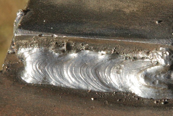

This is 1/8" 7014 at 130A on top of come cruddy 6010 beads. They have that feathered flat look that I saw earlier, so I thought I'd post'em up.
/ Weld Critique Plz #26
Nice looking welds, Ian. 7018 makes a good looking weld, better appearance than the 6010/6011. About the only drawbacks are the requirement for clean metal, tough to re-strike, and dry storage if you want to make x-ray quality welds with it.
I use either 7014 or 7018 almost exclusively, normally I can get the base metal cleaned up before I weld. If I'm into repair work, I'll pick up some 6010 or '11 for that.
