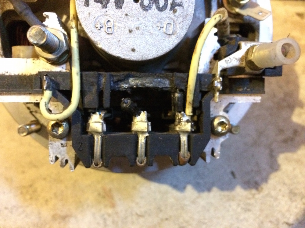

Sheesh. I just realized I never finished off this thread. The attached picture is of the old alternator. It was indeed fried as you can see from the middle gizmo which is burned out of its housing and only attached at one end. I'm thinking it's a diode.
I eventually threw in the towel and sent the 1850 by truck back to Taswell and had them do a front to back overhaul. At the same time, I bought another one so's to have a backup. The new one came and I was so blown away by how much better the steering was that I mentioned it to Terry and he retrofitted my old one with a plumbing change that makes it as easy to steer as the new one. All the little wires, fuses, etc. are in the pink and the original PT is nice and happy.
