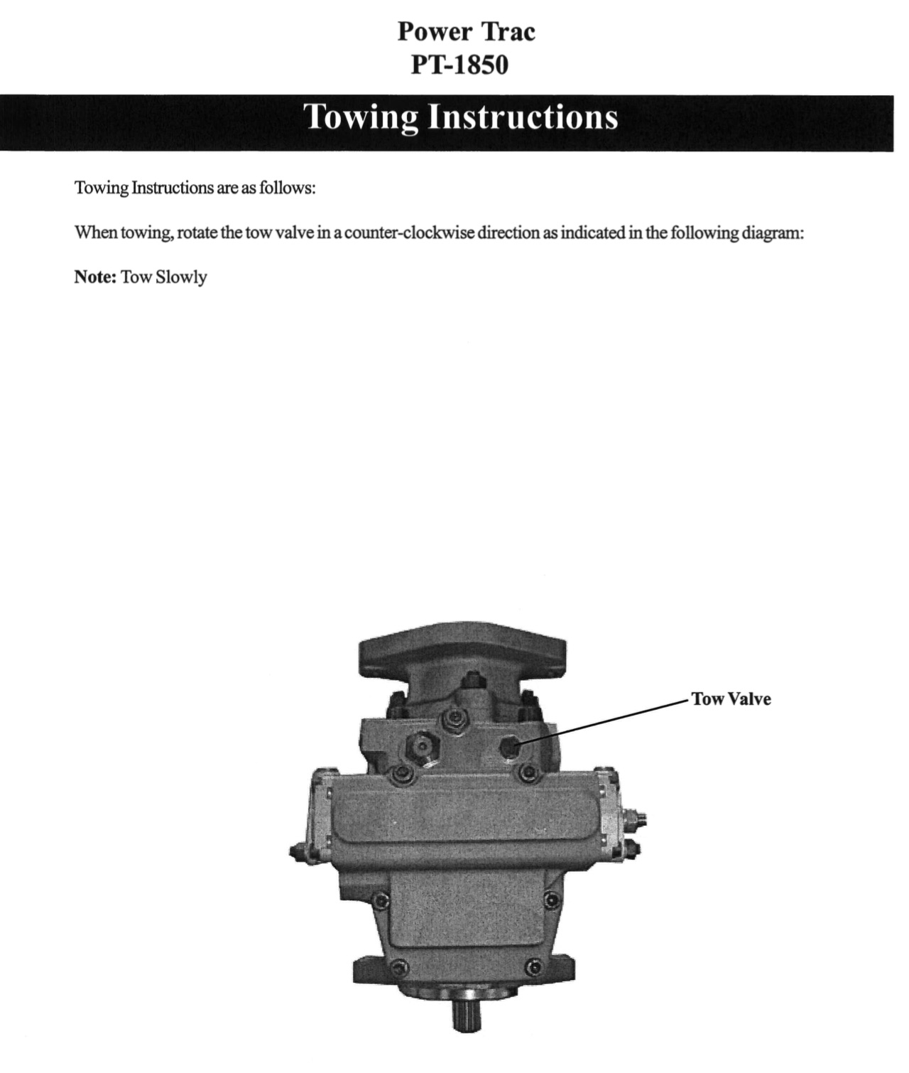

From the manual for what it is worth:

Releasing the brake is a two stage operation. I'll definitely call Terry for a refresher course if I ever have to do it for real. First, use the handle on the Brake Tender to manually pump the pressure up above 1000 PSI (after 500 PSI you need a lever to do this, Terry recommends a 2x2). Second step is to loosen the Tow Valve per Ken's post just above. But Terry got pretty specific about how many turns (not many) so I'd check with him before attempting to tow. Since I have a blade on mine right now, and since the blade won't stay up with that tow-valve open, I'd have to tow from the back. I'm glad my solution didn't require towing -- I got it in the barn about 10 minutes before a burst of freezing rain went through.
