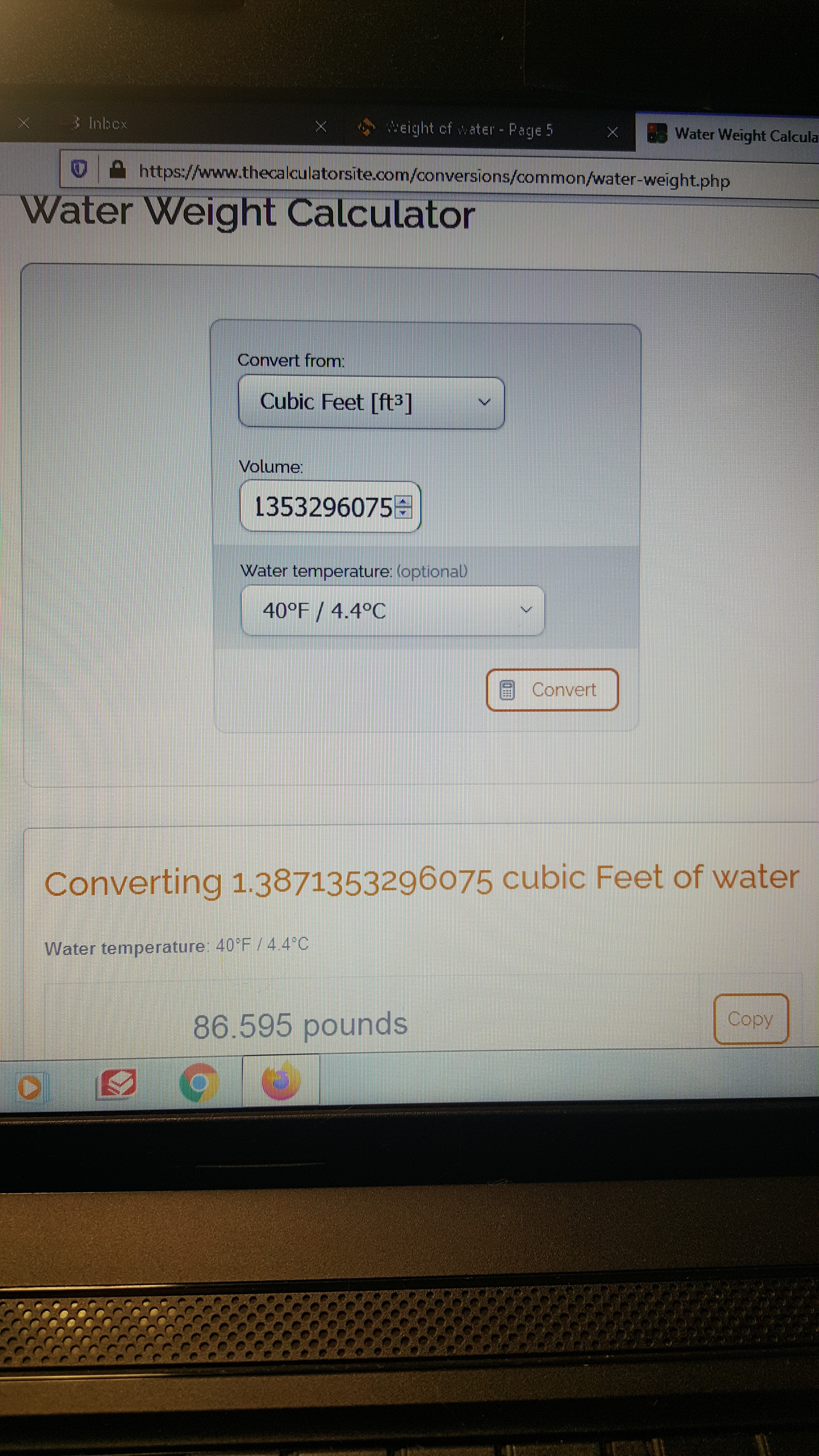

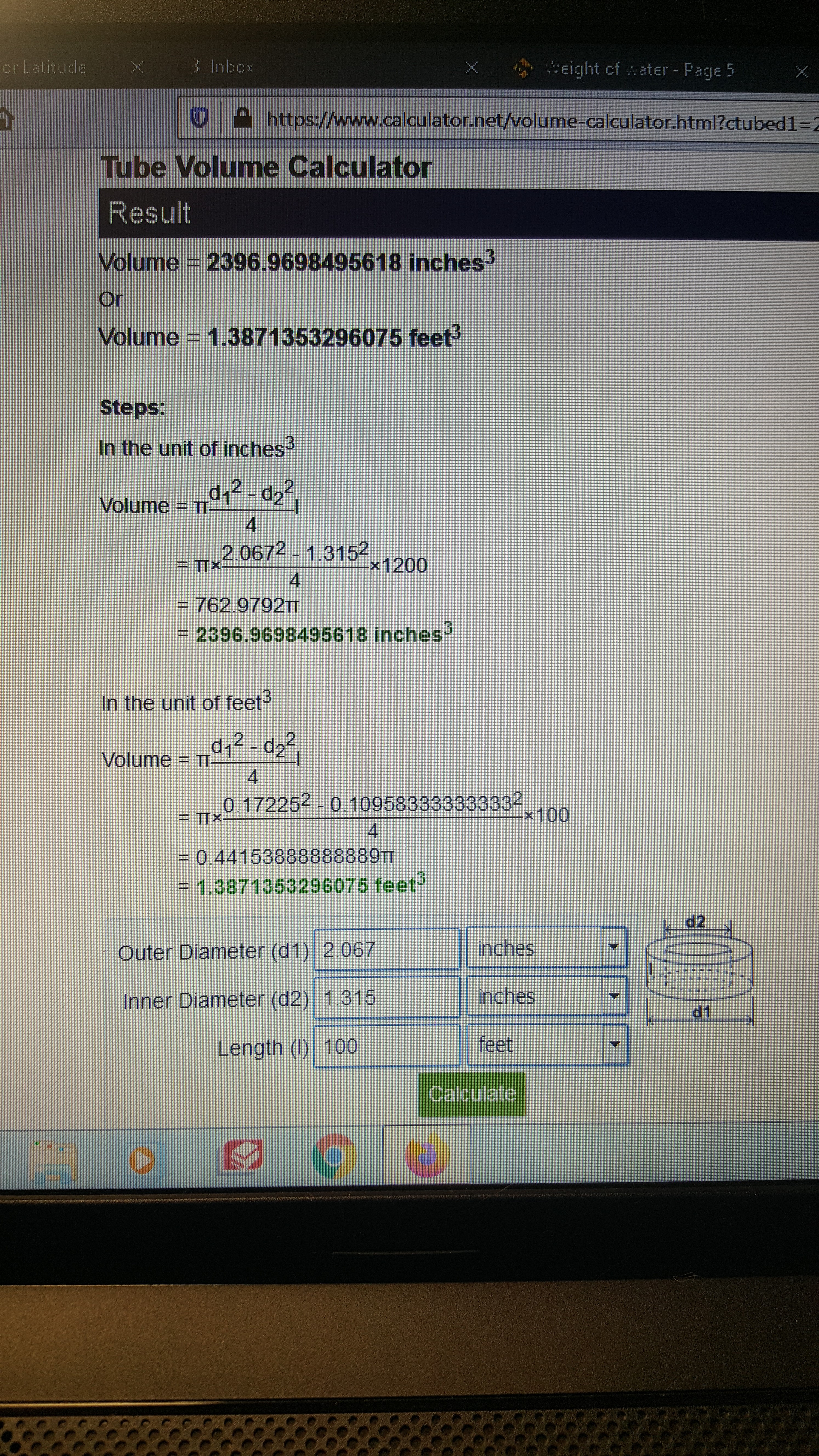

So I use a couple of on line conversion calculators to get the weight of water (at 40 degrees F is just a guess for a well) and the answer I come up with is 86.595 pounds.
First is for a "Tube Volume Calculator": where d2= 2.067" and d1= 1.315" and the length is 100' which equals to 1.3871353296075 cubic feet.
Second is for a "Water Weight Calculator" : where 1.3871353296075 cubic feet equals 86.595 pounds of water at 40 degrees Fahrenheit.

edit: for the water weight calculator you will have to change the "convert from" to Cubic Feet [ft3], and add in 1.3871353296075 for the volume, and change the water temperature to 40F, and then convert to get the pounds of water answer of 86.595, because the link has wiped out this information.
I only entered a few numbers and values and hit "calculate" to come up with 86.595 pounds of water at 40F as shown below on the 2 attachments.
KC
