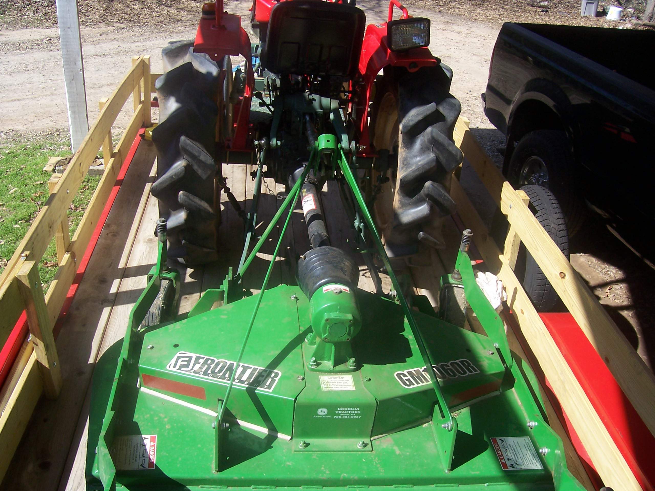

No doubt about that. I had to add 100Lbs. Front Weight just to keep the Front end down while driving on my Gravel Rd. with a 5'FM. It's well built but can't weigh much more than 500Lbs. If that! And I still leave the rear wheels down to take the weight off when driving in High Gear.The Manuel doesn't provide the weight Specs. but here's a pic to give you an Idea.

No doubt about that. I had to add 100Lbs. Front Weight just to keep the Front end down while driving on my Gravel Rd. with a 5'FM. It's well built but can't weigh much more than 500Lbs.If that! And I still leave the rear wheels down to take the weight off when driving in High Gear.The Manuel doesn't provide the weight Specs. but here's a pic to give you an Idea.
I run a 6ft bush hog brand finish mower behind my YM2000 and i have close to 180lbs of weight on the front bumper, but that mower is 700lbs!!! It is very light in the front but i can still ride like that i will run down the road and through the yard, the bumps in the yard with it up will kind of get a wheelie every now and then.
/ weight lift on ym2000 #9
Wrong!!! I Found my Manuel and the weight spec..Your Running 180
Lbs. up front and 700 rear and I have about 100 Lbs. up Front and 611 Lbs rear. Thats why I leave my Rears on the ground. A little to old and beat up for any Thrill seeking Wheelies. So Norms weight 550-600 is pretty much dead on the mark for Rear weight and with no Front weight lifting the Front wheels. The 6' of My JD/Woods is 678 Lbs. 7'-774Lbs.
