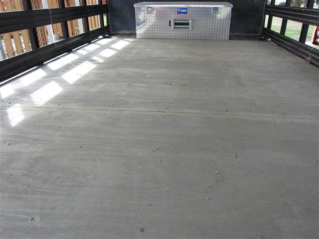

I did something similar to spread the load on my 2004 Isuzu NPR/EFI 8x14 ft stakebed using a few sheets of 3/4" thick plywood and some deck screws.
The NPR is for hauling my small parade tractors (about 3500 lb max).
