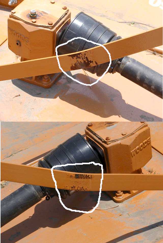

Had TC25D, now JD X310
I did 2 hours of rotary cutting this morning with my Woods BB60, only knocked down 2 plastic step in posts /w3tcompact/icons/laugh.gif. Please don't tell my wife, I'm going to blame it on the horses. /w3tcompact/icons/wink.gif
Since I was spending plenty of time looking back at the mower, I noticed the 2 places the paint came off first {see attached}. Once I thought I saw this area flex /w3tcompact/icons/shocked.gif so I got off the tractor to look at them. They hadn't flexed but it gave me a start!
A potential problem?

Remembering your thread on cutter setup back in April. The matter of whether the top arm (link) should swing through? I think you are seeing an example of when it does not. To me, some of the information you were given was not correct, but then to some, it was probably right. Did you change it so the top arm (link) would swing through, or leave the bolt restricting the swing through?
Those areas are signs that these brace arms have been bent under compression, due probably to the fact that the rear of the rotary cutter deck raised (went through a ditch, or backed the cutter up a bank), causing the top arm (link) to be in compression (too long) as well. The weakest link in the system are the braces. They look like the braces on my JD513. Sometimes I back the deck up a bank that is just too much for the slack I have at the top point. A chain in place of the top arm (link) would be better.
The trick is to get the top arm (link) adjusted so there is room for the rear of the cutter to raise and lower without picking it up when the rear tractor wheels go over a bump or rise, and without forcing the rear down when the rear tractor wheels go into a depression (or some combination of the same things happening when the front wheels go into a depression or over a rise).
/ Weak Spots On BB60? #3
Most designs include these lft straps being made of thinner/weaker material so that when the limits of the flex link are exceeded the straps bend rather than bending or breaking the hitch itself or the top link. Most people would prefer straightening and repainting these straps to repairing or replacing hitch, deck or tractor parts.

<font color=blue>Did you change it so the top arm (link) would swing through, or leave the bolt restricting the swing through?</font color=blue>
The bolt is still there. Should it be removed?
If I understand correctly, with the cutter and tractor on level ground, the swinging toplink on the cutter should be slightly less than horizontal when connected to the tractor toplink? This will allow the swinging toplink to rotate down as the deck rises, either from being raised by the 3ph or because of motion of the tractor.

My first thought was going to be to ask if you still had that bolt in that prevented the toplink from swinging back through. But it looks like Beenthere has already beat me to it.
Personally, I don't think that bolt should be there, but I know some knowledgable people told you before to leave it. Mine doesn't have it and I do mow some ditches. I have found it works much better to back up to them and let the tailwheel ride up, but when I do this, the toplink does swing through a couple of inches. So far those support straps don't seem to have bent at all. I cut about 7 acres with it Saturday.
I have my toplink set as you suggest, just slightly less than horizontal, just enough tension the rotary cutter doesn't bounce much, but most of the weight sitting on the tailwheel.

I noticed the paint had chipped off these 2 areas before I even used the cutter, which seemed odd. I have some ditches to cut and I will probably take the bolt out since it's working OK for you.
Do you keep the 3ph in the float section of the scale while cutting? Initially, depending upon the contour of the ground, the front skids made marks in the pasture. After a few passes I determined the height the 3ph had to be to not do this and set the stop.

Those do look like flex points. The paint is very tell-tale.
