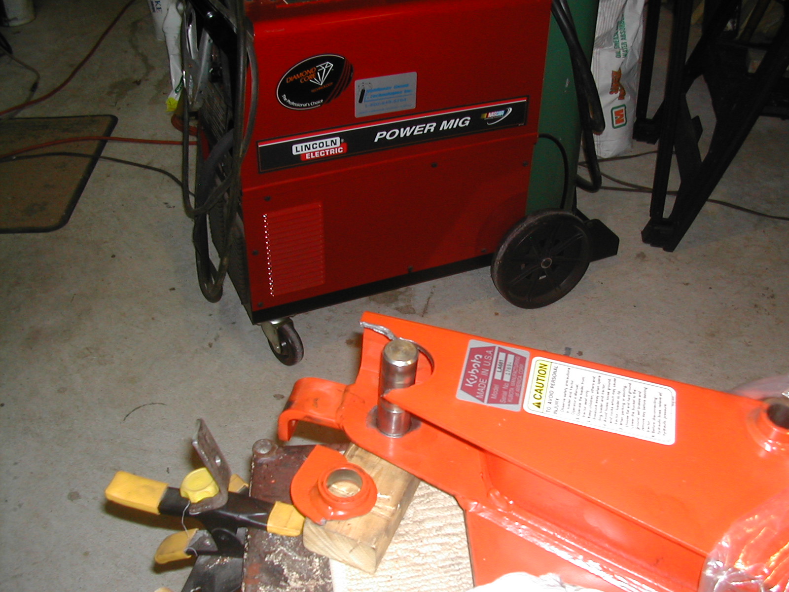

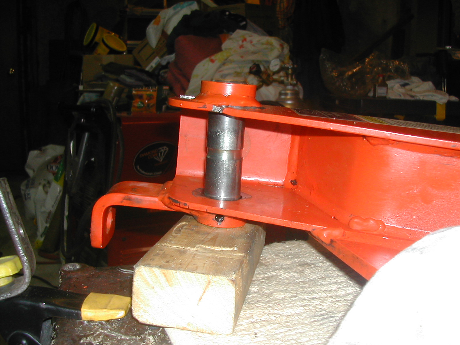

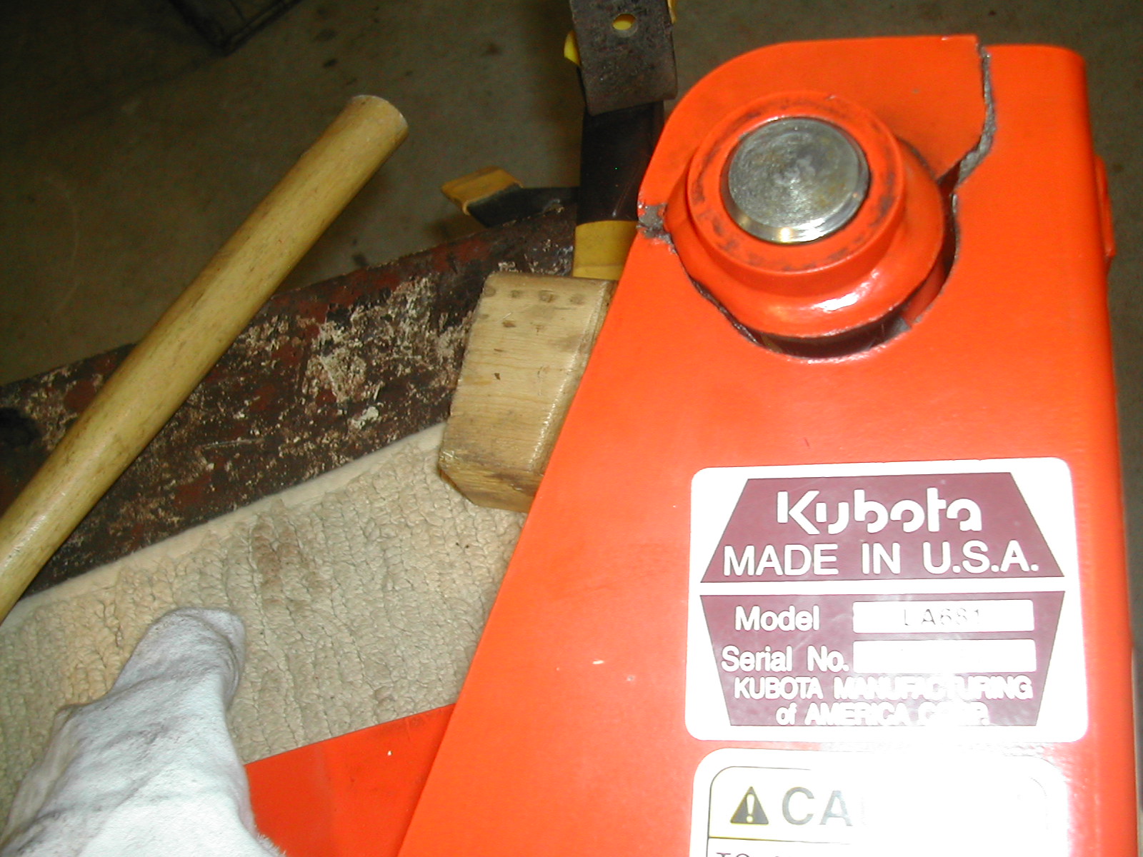

Somehow I broke the hole out of the top of loader arm support (see pics) for the arm pin. Nothing seemed to be bent it just broke out. I am not sure how I don稚 recall hitting anything harder than normal. Anyone know if this a weak point of this loader? I am planning to weld it back together any problem there?

thats the problem with tractor loaders they are built too light for the machines the loader on my m8950dt has stress cracks that ive welded upusing artic 223 welding rod.but 7018 would do the job also is there room to fish plate it on the inside to strenghten it up if so that would help or the out side i see you have a buzz box there is it ac dc capable if so weld it on dc as you will get a better weld

Looks like a materials flaw.
I'd wrap it and zap it.

There's the trouble , right in the third pic, Kubota, Made in the USA, the part from Japan was fine !

Anyway, it looks like the original weld was bad. I'd wager the crack propogated around the weld, then out to the edges.
I'd suggest showing this to your dealer before you attempt to weld it. For one thing, you might end up causing a bind on the pin which could stress the rest of the loader.

Similar cracks started on my loader. I caught the cracks before they got too big and welded with a stick welder. So far after a few years it's been fine.

Looks like a factory defect to me. Looking at picture 3, it shows what I would take to be the starting point of the crack, right where the welds meet, it most likely over heated the metal and weakened it to the point it failed with enough stress.
If the unit is not too old I would call Kubota and complain. (Maybe they might fix it or replace the part. Ok so I tend to dream alot :) )

Thanks Good suggestions, I just emailed the pictures to the Kubota dealer. Although the TLB (3710), is 2000 vintage the Service Manager said he would talk with the Kubota service rep. about warranty or a good will adjustment, so we will see what Kubota thinks. Do you think it was made in the USA or assembled in the US? I think I was a bad weld, maybe overheated, I don't know if these are human or robot welds.
