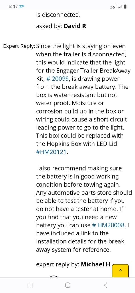

Noticed trailer brakes are weak.
Battery box says “recharge” on battery, but battery is only 2 months old and electrical tester reads 12.4V
Brakes work, but don’t do a lot, even with brake controller fully cranked to 10.
The trailer is only a year old and brakes worked well when I first got it.
What should I start looking at? Wiring connections seem fine
All lead acid batteries have the following voltage after they have rested (have not been charged or loaded in 30 minutes)
Fully charged =12.78Volts
3/4 full = 12.50
1/2 full = 12.25 Do not use battery here for any length of time otherwise damage to cells internally.
So rull of thumb for every 1/4 volt the battery drops the battery also drops 1/4
Rememeber 12.75,12.50,12.25 those are easy to remember.
A charging battery should be roughly 13.0 to 14.0 volts during charge.With engine on measure across terminals.Anything less is either bad connections,bad battery or alternator/regulator

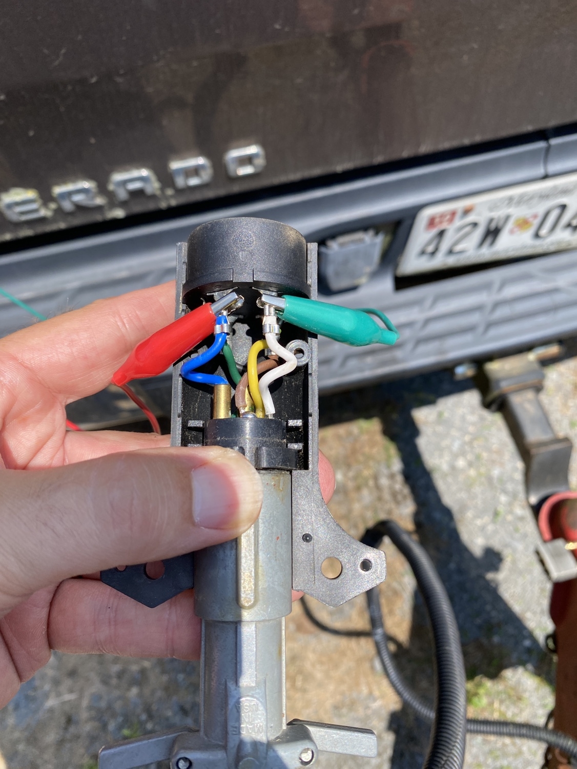

I just checked my trailer, my ground is good. It has welded on stud, I took wire off and wire brushed and reinstalled. I just checked and I’m getting variable voltage from my brake controller. I removed 7 to 6 pin cover to access brake and gnd wires.
Tires still not braking. I only have brakes on back axle on 7k trailer, but normally don’t haul much over 2k.

I went through my old 10 000 lbs trailer last year with no brakes. First thing I did was lift it up on the side so I could easily access wire connection points. Then tested each wire with a battery for continuity and replaced old wire connections. Still no brakes so then tipped it upright and checked the brake solenoids and found some with broken wires. Replaced the 4 backing plates with new ones and connected them up. Cleaned the drums and reinstalled. No more problems

The ground connection should be in the plug on ANY OEM or aftermarket trailer plug, as I said before, if you are relying on your hitch and ball to provide a ground for your trailer no matter if you have a 4, 5, 6 or 7 pin trailer plug you're doing wrong
