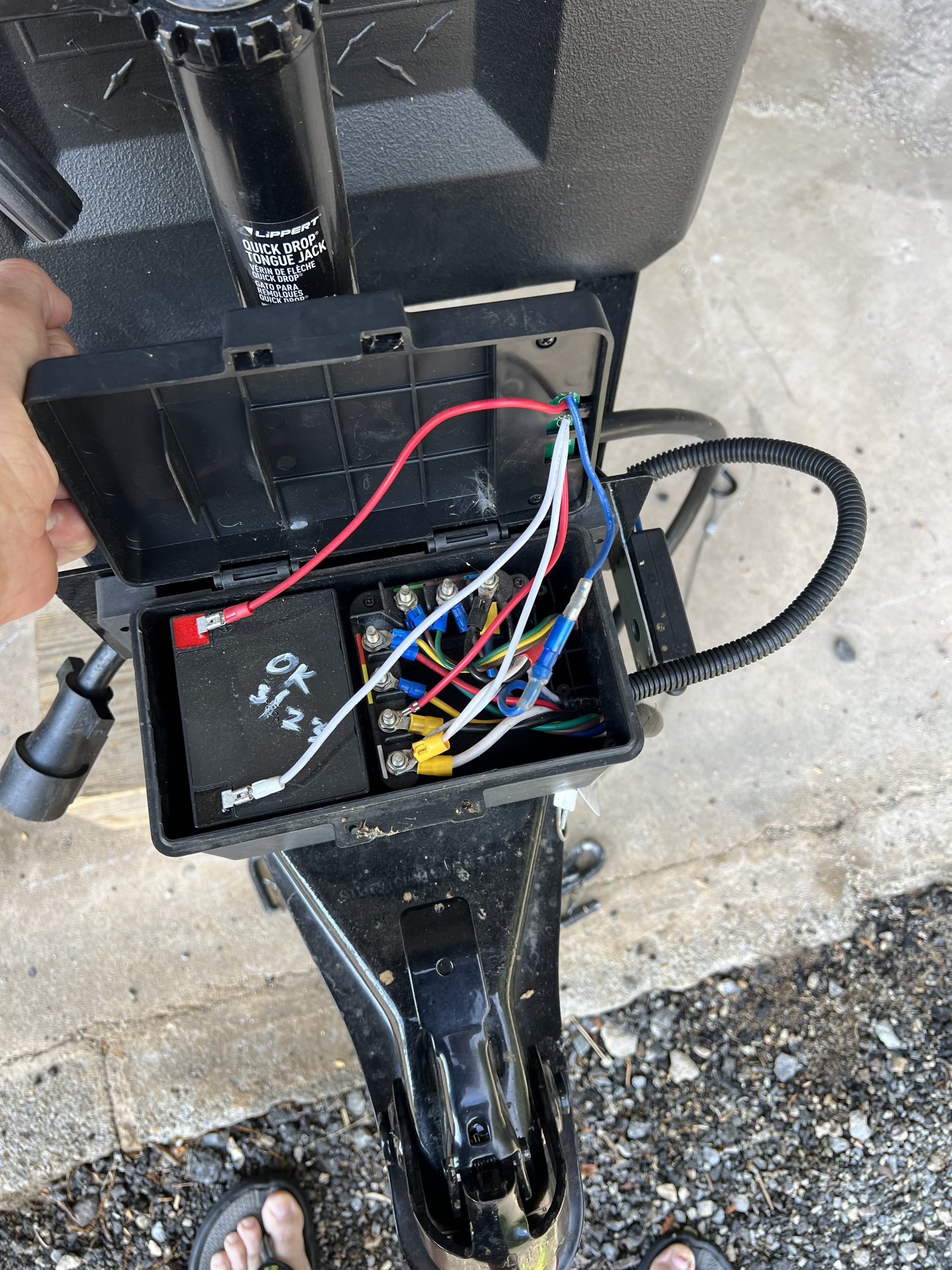

So around the world we went. Got a little Ford v. Chevy v. ram in, some opinions and some really good help.
It was a bad ground wire. Visually, it looked ok, then upon further inspection, it wasn’t screwed in tight.
All fixed.
/ Weak brakes & battery box confusion. #133
So around the world we went. It was a bad ground wire. Visually, it looked ok, then upon further inspection, it wasn’t screwed in tight.
All fixed.
Yeah no kidding. It’s all too often guys ask for help on here and then forget to follow up with finished photos or respond with the fix they went with for the problem they had.
As busy as you are I’m glad you were able to get it taken care of and keep us posted as well.
