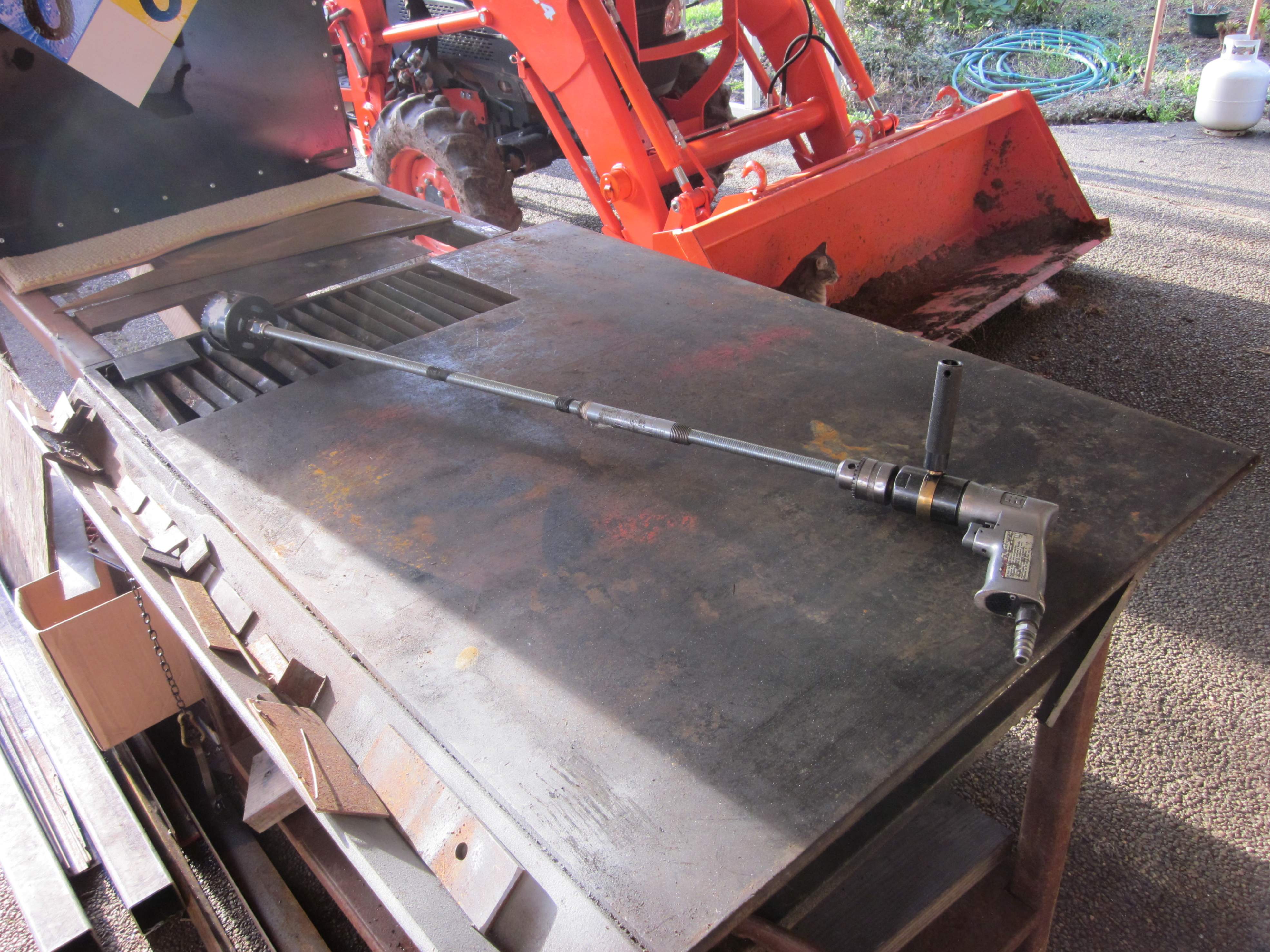

I did something like that but a little cruder.:eek:
Went to Lowes early this morning and got a new 3 1/2" whole saw, some non-shako nuts and a 3' piece of 5/8 all thread. Used a die/peanut grinder with a bur on for the first few inches to get started. Then I assembled all new stuff and plus a piece of pipe on the all thread for a hand hold. Chucked it up in a drill and went to reaming. After a while I held it at a angle so the blade was only cutting on the weld and 30 minutes later the tube is sliding all the way thru. Thanks :thumbsup: Everyone for all of your thought process to come to a solution. When the wife gets back with the camera I will post some pictures. Thanks again!:D

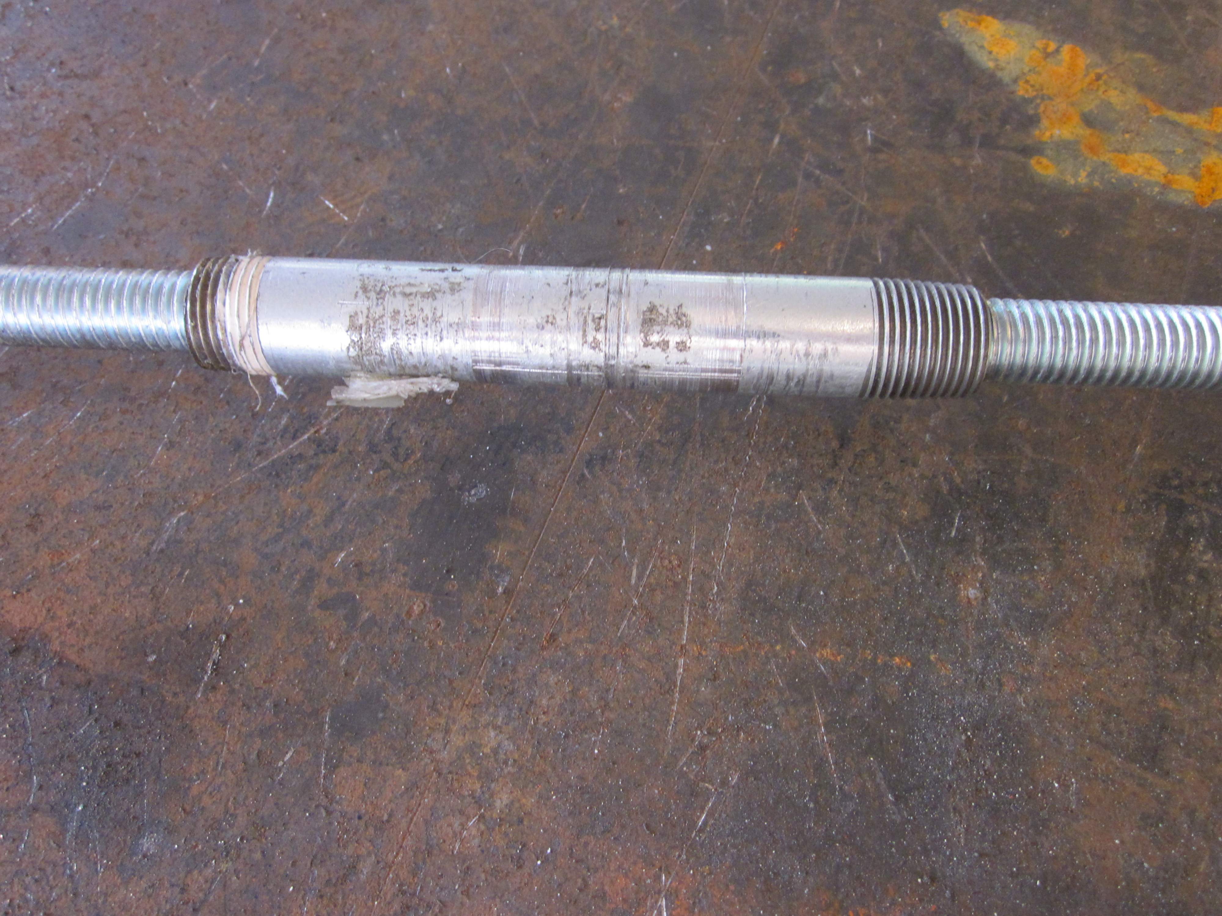

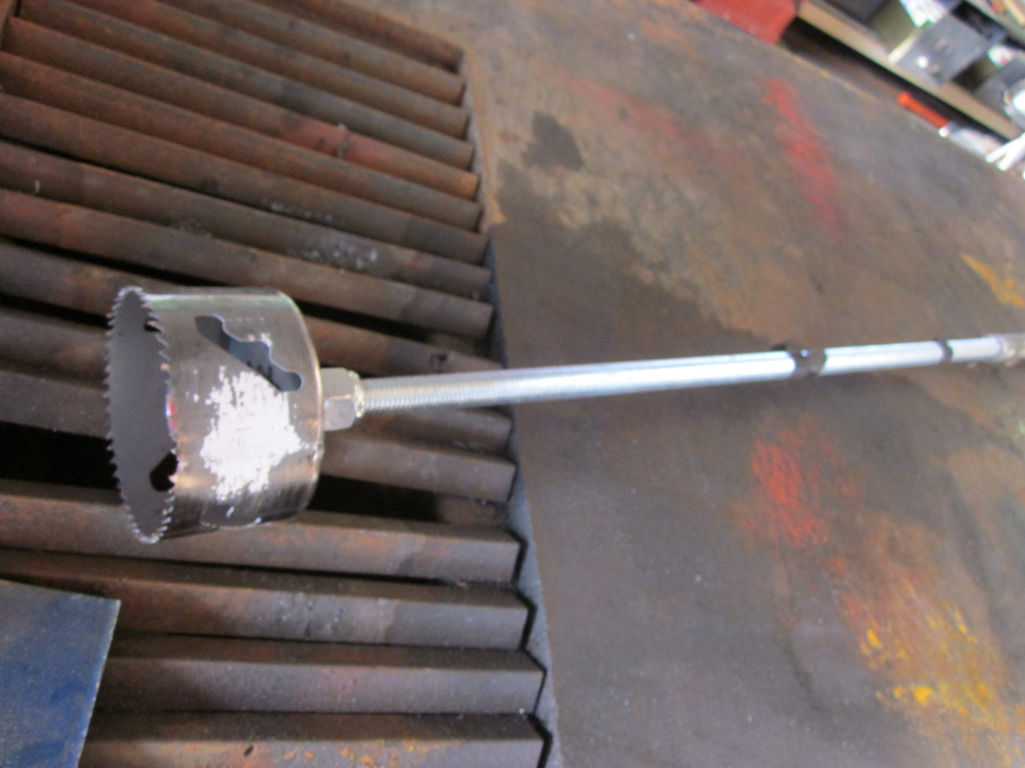

Finally got pictures of my home made boring machine! :thumbsup:
