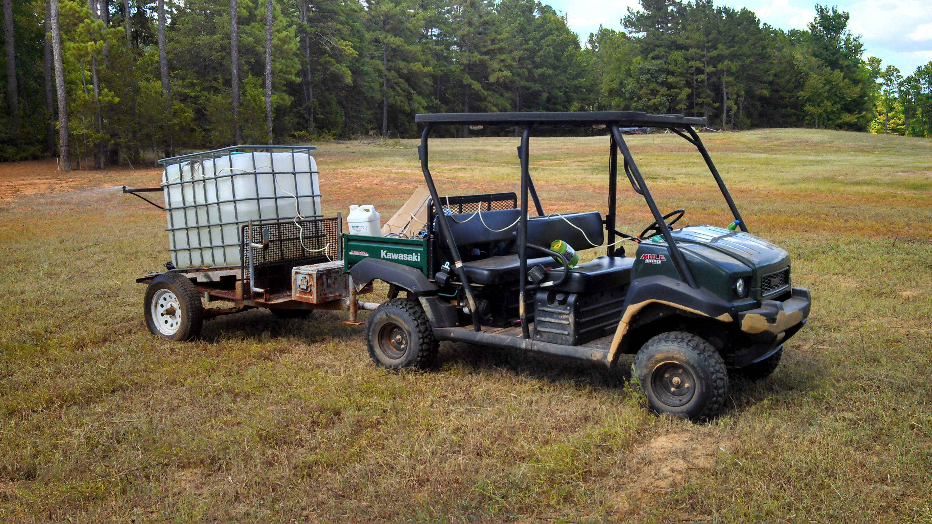

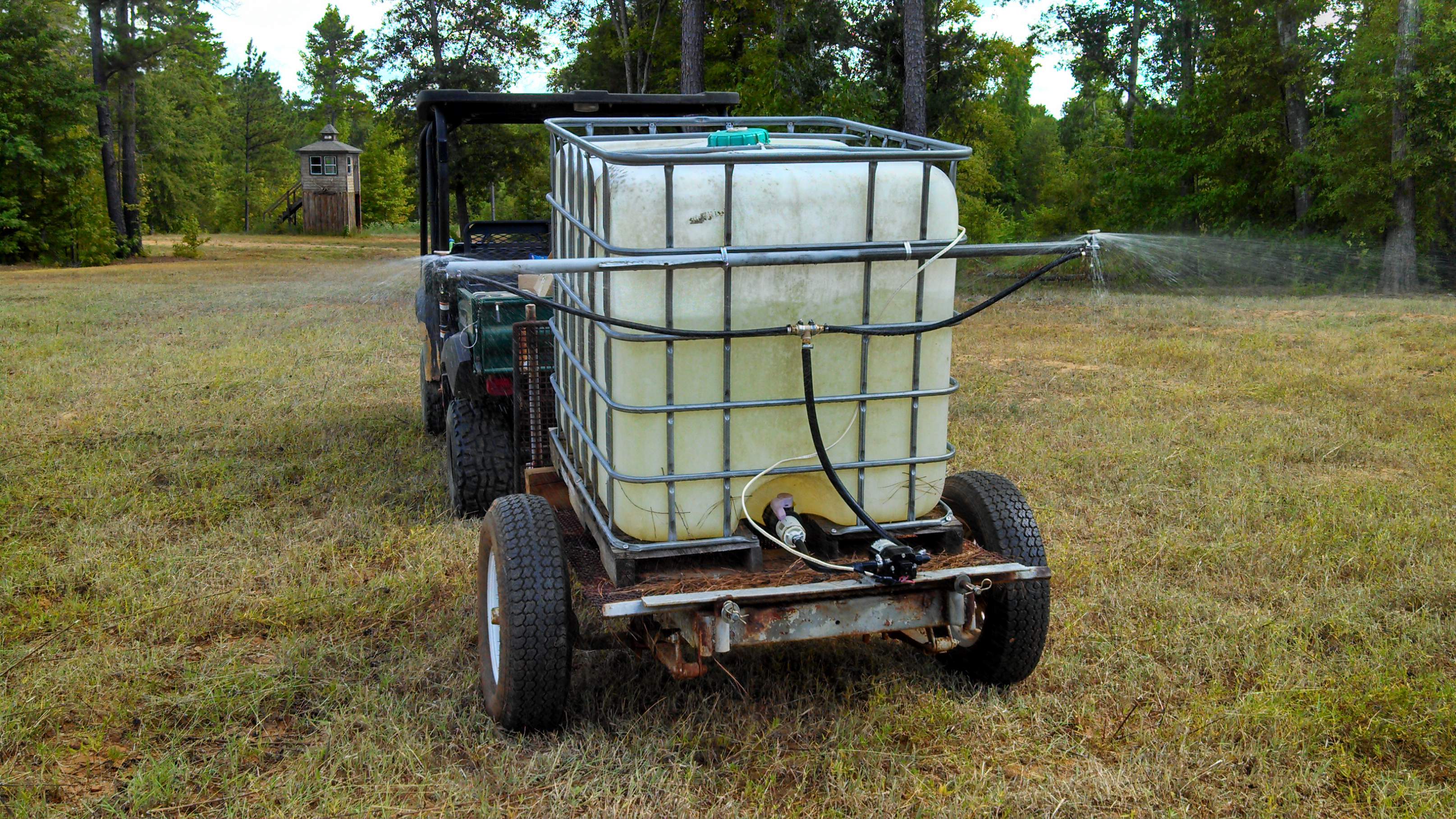

I put a 300 gallon plastic tote on the back of a trailer I found. I had to put new tires and a 2 inch hitch onto the trailer, but otherwise, it's like I found it. The tote just sites there. I have to be careful when filling it to make sure it's balanced, so I don't rub the tires. I put a coulple of 6x6 blocks under the front of it so everything drains out, but if you have a taller vehicle to tow your trailer, that wont matter.
I have a 12v pump on the back of it that I plug into a cigarette lighter connection on the dash of my Mule or my tractor. I added one to my tractor just for this reason. The pump is kind of slow for spraying, so when I wanted to water my food plot, I disconnected the pump and just opened the valve at the back of the tote, then drove with it pouring out. This worked pretty good, but you really need a lot of water to get anywhere. I filled my tote a dozen times and it took a good part of the day to get that much done.
The real problem is in how long it takes to fill the tote. It's very time consuming.
Eddie
