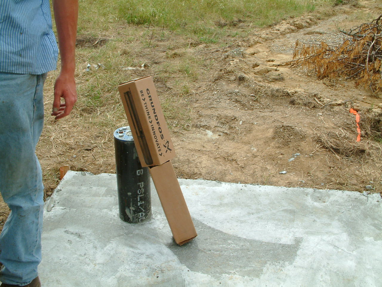

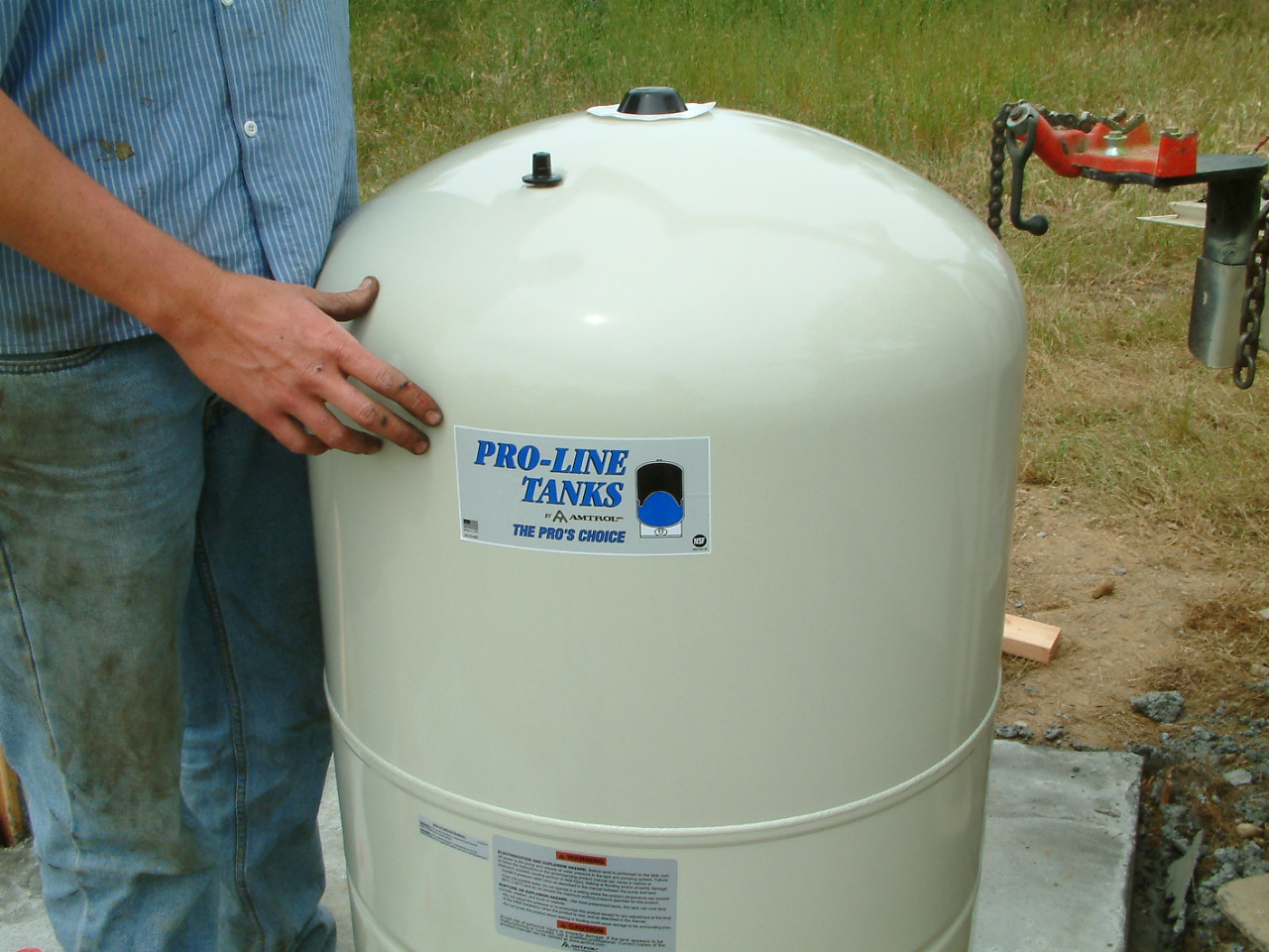

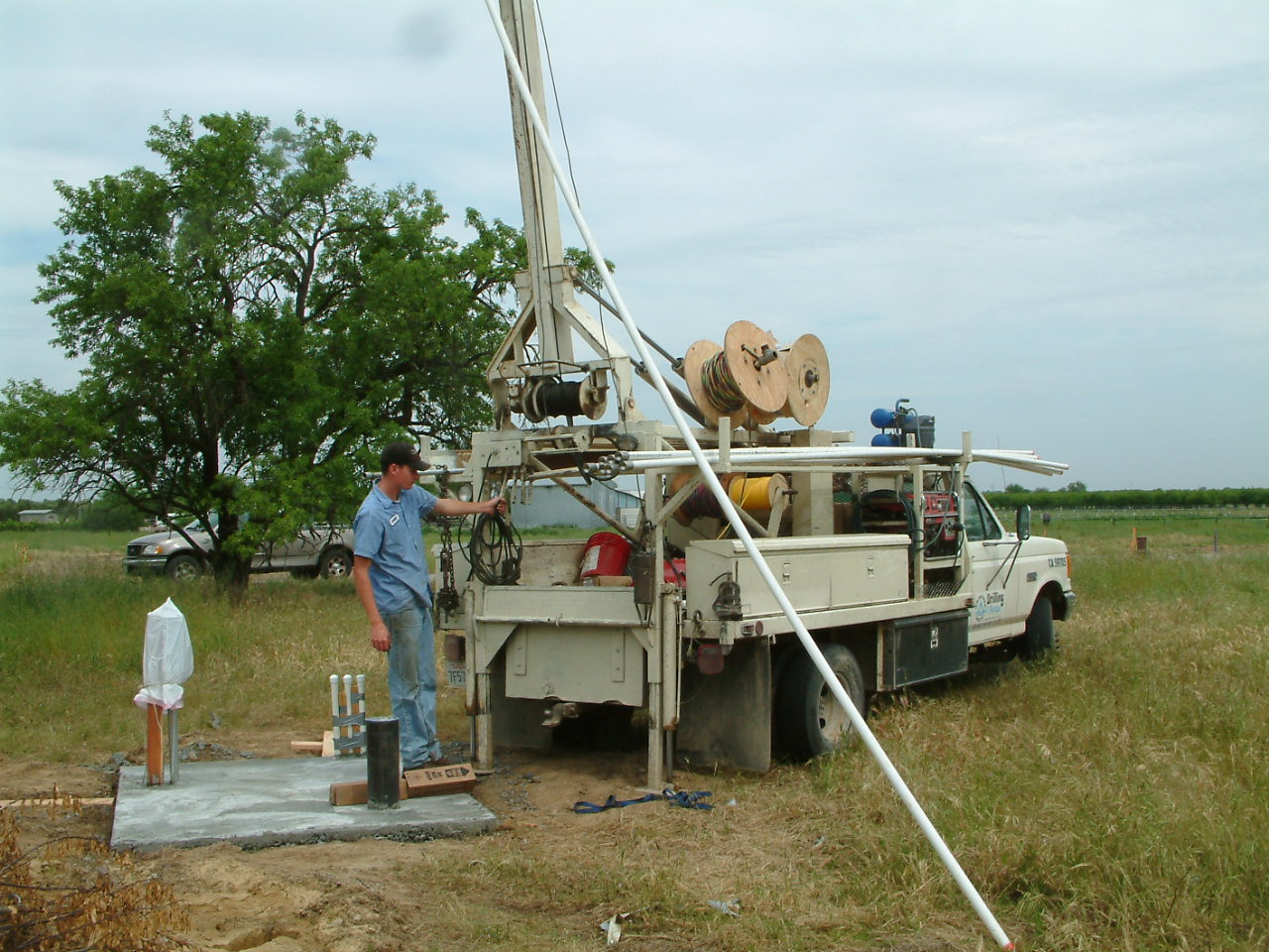

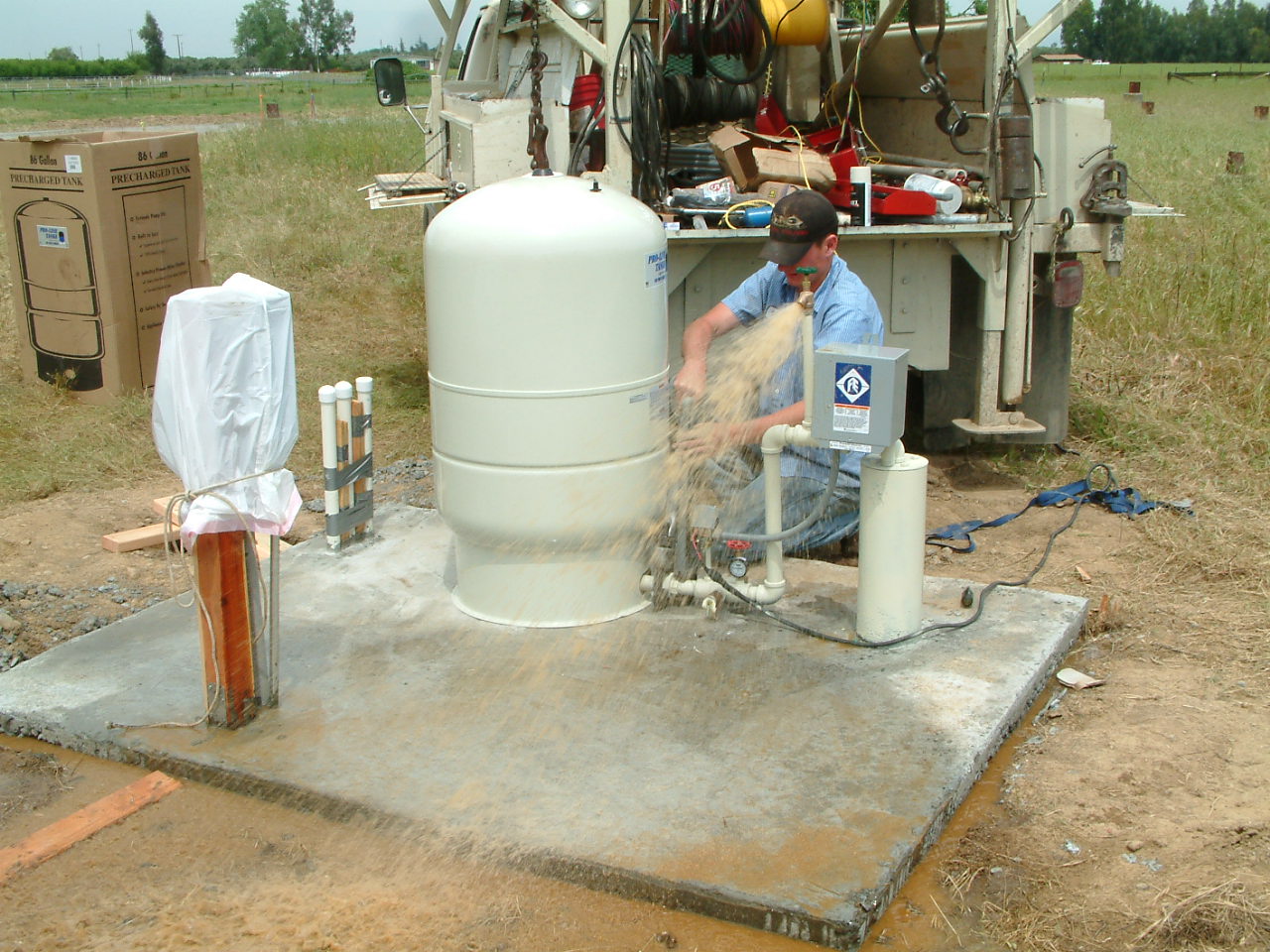

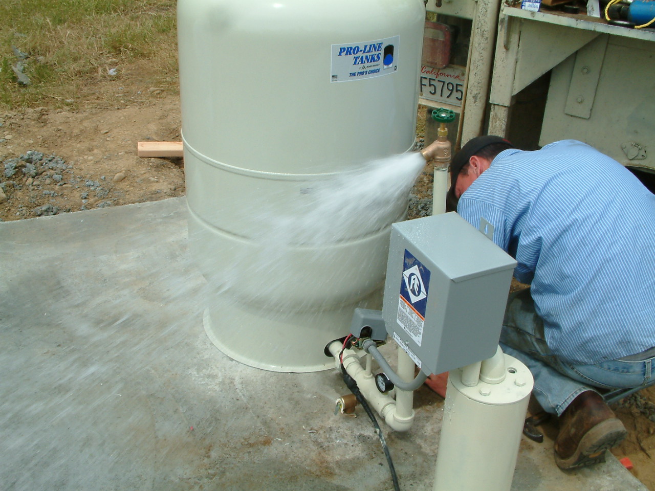

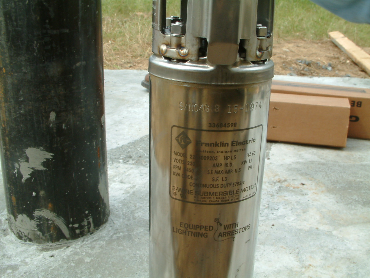

Here are some photos showing my well installation in May 2005.
Well is 154 feet deep. Pump is 1.5 hp at 120 ft. Water level in well was 53 ft. Well blew out at over 100 gpm.
Get 30 gpm with that Franklin pump. 30 gal pressure tank set at 65 psi.
Poured the concrete slab myself.
Good luck
