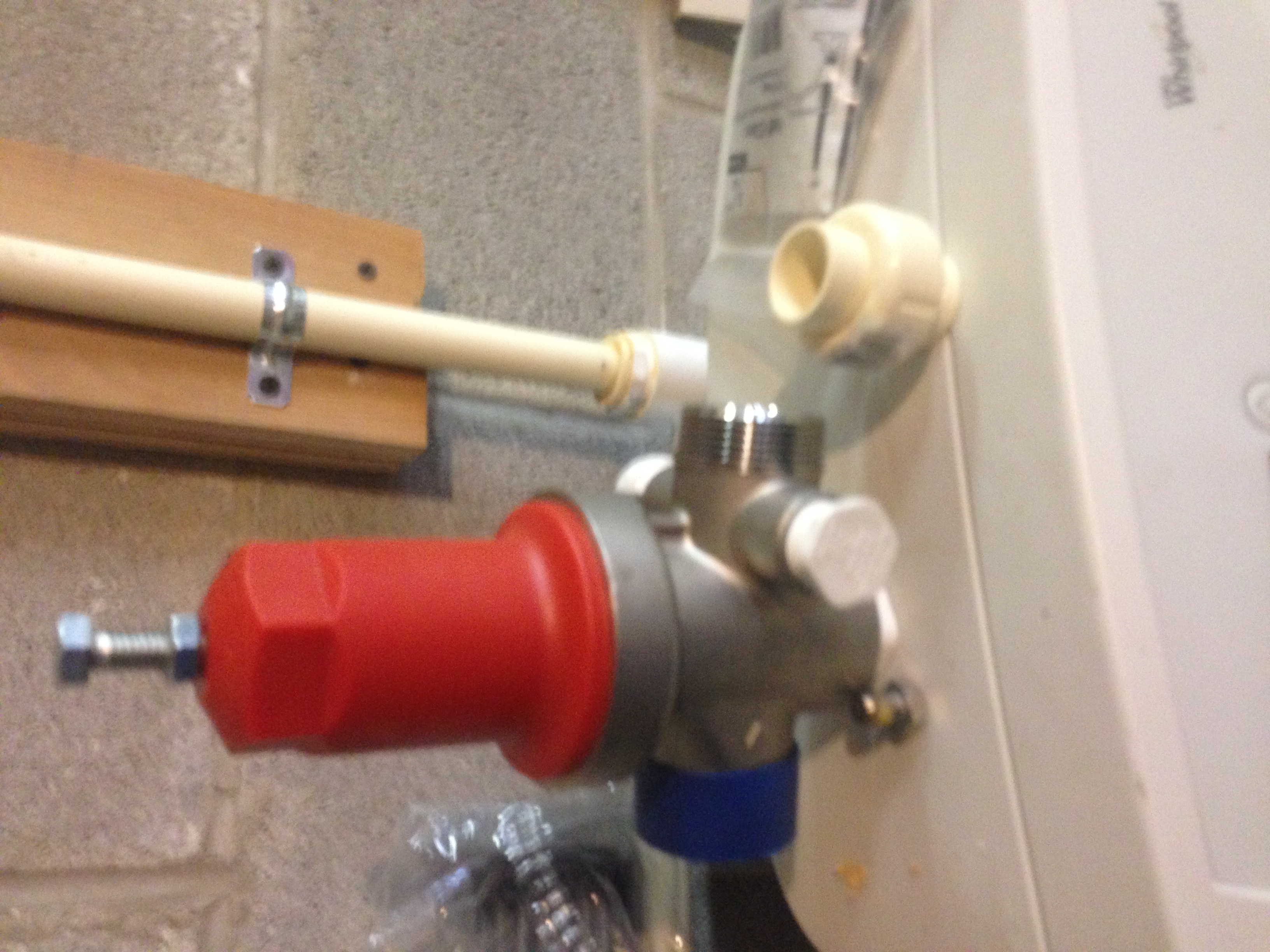

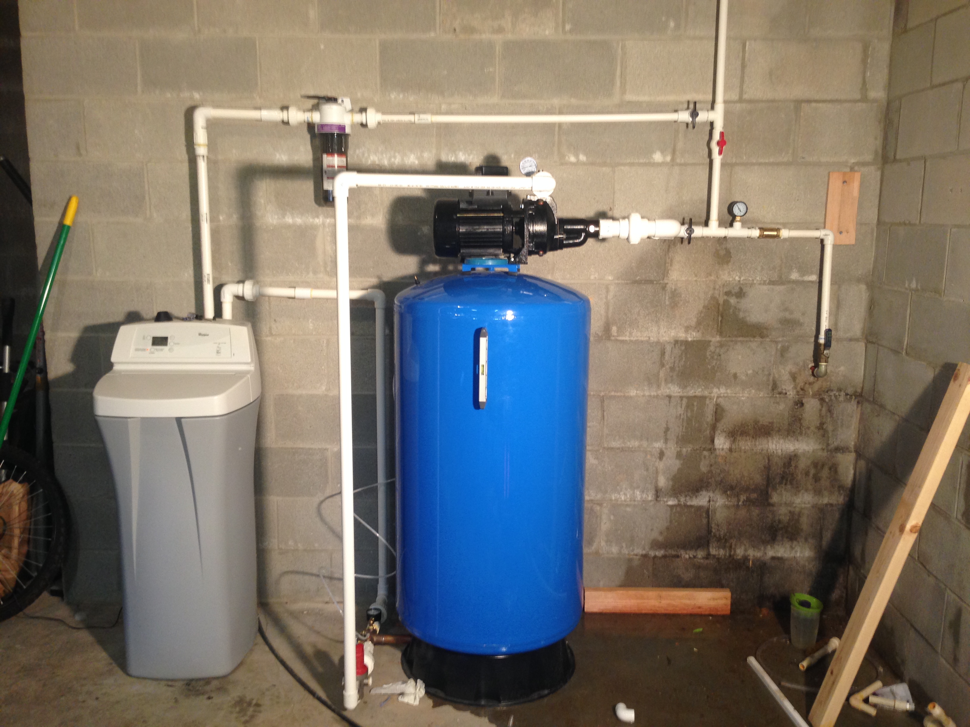

You can install you own storage tank with a simple float cut off valve that is filled from the public source. You would only need a tank equivalent to you daily usage. It would refill during the period you are not using water. You could then connect that to a booster pump and a pressure tank to boost your pressure to what ever you want it to be.
I had a similar problem and installed a 1.5 hp pump with a 35 gal pressure tank. Ended up installing a CSV. I also installed a couple bypass lines for maintenance along with a connection direct to the public line since it varies so much. I am at the peak of the hill so I get varied fluctuations. My set up cost less than $600.image.jpegimage.jpegimage.jpegimage.jpeg
