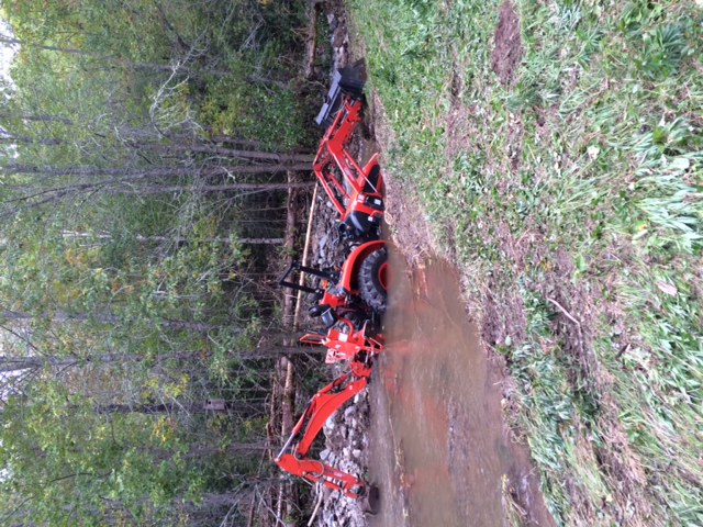

Slide my Dk35 into a creek and locked up motor , got machine out and removed injectors . Drained out water and changed oil , now when I start machine I am getting white smoke out of number 1 cylinder. Swapped injectors around still number one cylinder . Pulled head no bent valves all looks good. Any ideas?

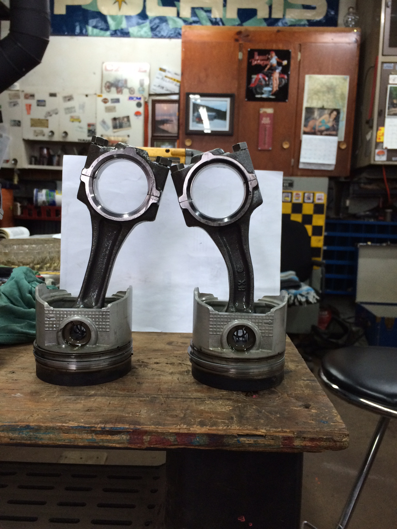

Compression and leak done was good, removed head looks like bent rod number one :( . Piston not coming all the way to the top like the other two. Will now have to figure out how to get the oil pan off. Wish I had. Service manual. Thanks for the input.

Thanks for the pm , I questioned my compression test results and had cracked injectors and #1 was dead, I swapped injectors still dead , then I removed exhaust and #1 was putting out white smoke . When I removed cyl head #1 piston was only coming to about 1/8 inch to top deck and the other two were level with top deck.
   / Water logged DK35 SE #8
Sounds like a bent connecting rod for sure. If there is no piston, bore, or crank damage the fix shouldn't be too bad. Good luck.

So the one on the left is the good one. Water and internal combustion engine don't mix. Totally my fault . Thanks again for all the input. image.jpeg
