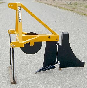

/ Water line installer #9
Here is one....but the company is in NZ. Anyone know of one like this in the US?

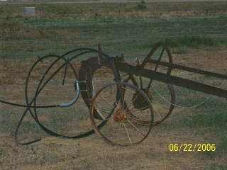

Here are a few photos I saved some time ago from a TBN thread. It gives a good idea of what's involved in the sub-soiler approach to this chore.

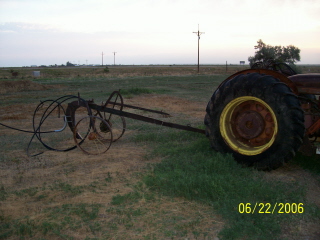

/ Water line installer #12
Last image.
