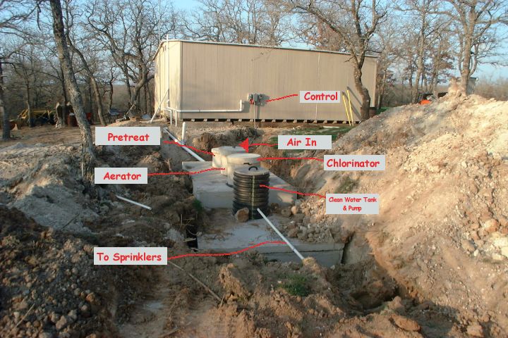

Bird, I think my system was a little more expensive because of the concrete tanks and it was not a local (TX) design. Your system also combines two actions (aerator/chlorinator) into one large tank. I suspect these are the main costs involved.

My B-I-L installs Hydro-action systems. He showed me one that he was fixing to install setting on top of the ground. It comes with all the tanks strapped together where he can just lower the whole shabang down into the hole at once.

Thanks for the pics. The website makes it look like this might be three separate holes with tanks set. Your system looks like one long tank. The prices you guys are quoting are scaring the heck outta me though. The new system I had installed last year had a 1000 gallon tank with 480 square feet of inflitrator laid in 1 long run of about 90 feet or so. Sure looks funny to have the inspection riser so far out in the back yard. Total cost with permits was about $2,000.00. ($150 permit fee including core samples). /w3tcompact/icons/smile.gif I'm also glad to hear you guys talking about sediment in new wells. I've dealt with hundreds of new houses all with new wells and nobody EVER talked about funny colored water. My new well (126ft with 67 feet of standing water and 10 gpm submerged pump), was connected last month. /w3tcompact/icons/cool.gif I almost freaked when I flushed the toilet and it filled with red water. The I read the drillers log (Michigan requires I get a copy of it) and realized that it had to be something like sediment because they had gone through a layer of grey clay and a couple layers of red clay. It has cleared up quite a bit, but there's still a little sediment in the toilet every now and then. I expect when I run the water long enough I'll get rid of it. And the chlorine. The guys are required to dump a gallon or so of chlorine down the well when they hook it up.

SHF - My system has three tanks in one large concrete container, with each being sealed from the other except for the designed flow piping. The final tank (with the black riser)is on the clear water collection tank (500 gallons). It has a submersible pump and a float valve that turns on the sprinklers between the 250 and 300 gallon level. I you go to http://www.norweco.com you can check out more detail on the Singulair system which mine is. In their brochure, they do not show the clear water collection tank.
