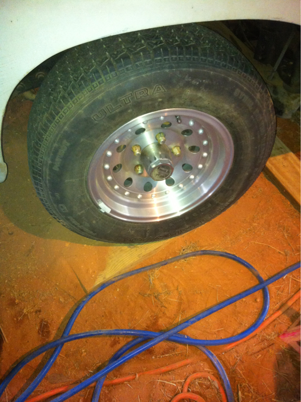

I found a nice set of aluminum rims for it last week. American Racing Outlaw II rims and tires, $150 for all 4. Made me feel a little better about the engine woes. Not sitting on 4 flats anymore.
