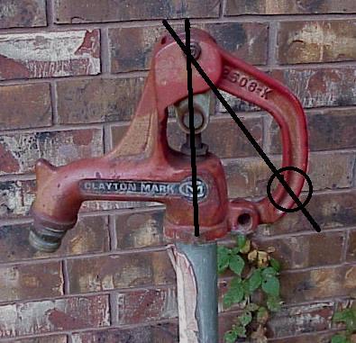

You may find the plunger has failed to some degree. I've found that from the factory, the handle is adjusted way tighter than need be and eventually the rubber is cut / fails around the seat edges. Very little downward pressure is required to prevent leakage through that small hole even at 60 psi. I can hold the rod down by hand to add packing at the top end. For adjustment, the instructions sometimes gives the angle we should feel the plunger touch and I've found less plunger pressure will do the job just as well and not cut the rubber plunger.
A small crack won't cause an operation problem of freezing until it fails to a point the leak is beyond the drainage potential but that's a fine line to draw. Locating repair parts isn't much fun and I've resorted to replacing the hydrant. Not all are created equal so look for quality. The extra 10 or 12 bucks you might pay will often make a huge difference in the operation aggravation.
A couple of ways to determine if it is draining. One mentioned, a cup of water held up to the spigot opening and watch the water be siphoned out of the container. Can actually be timed/measured. Another is to place the palm of your hand over the opening and feel / hear the vacuum. If you leave a hose connected and in the horse trough it will siphon all the water from the trough if the trough is at a higher elevation than the hydrant drain. Been there - done that.
