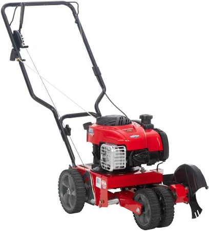

It’s called a trencher. What is your exact use? How far do you have to go? Would one of those sidewalk edgers work? Some of those are gas powered on wheels.
   / Wanting to "cut" a slot in the ground #3
Good point one of them would work, bet there used ones readily available
Just in case here is a random pic of one
   / Wanting to "cut" a slot in the ground #4
If you decide on an edger don't get one with a vertical engine because the belt will need to have a twist in it to power the blade. It will eat belts. Get one with a horizontal output shaft so there doesn't need to be a twist in the belt.

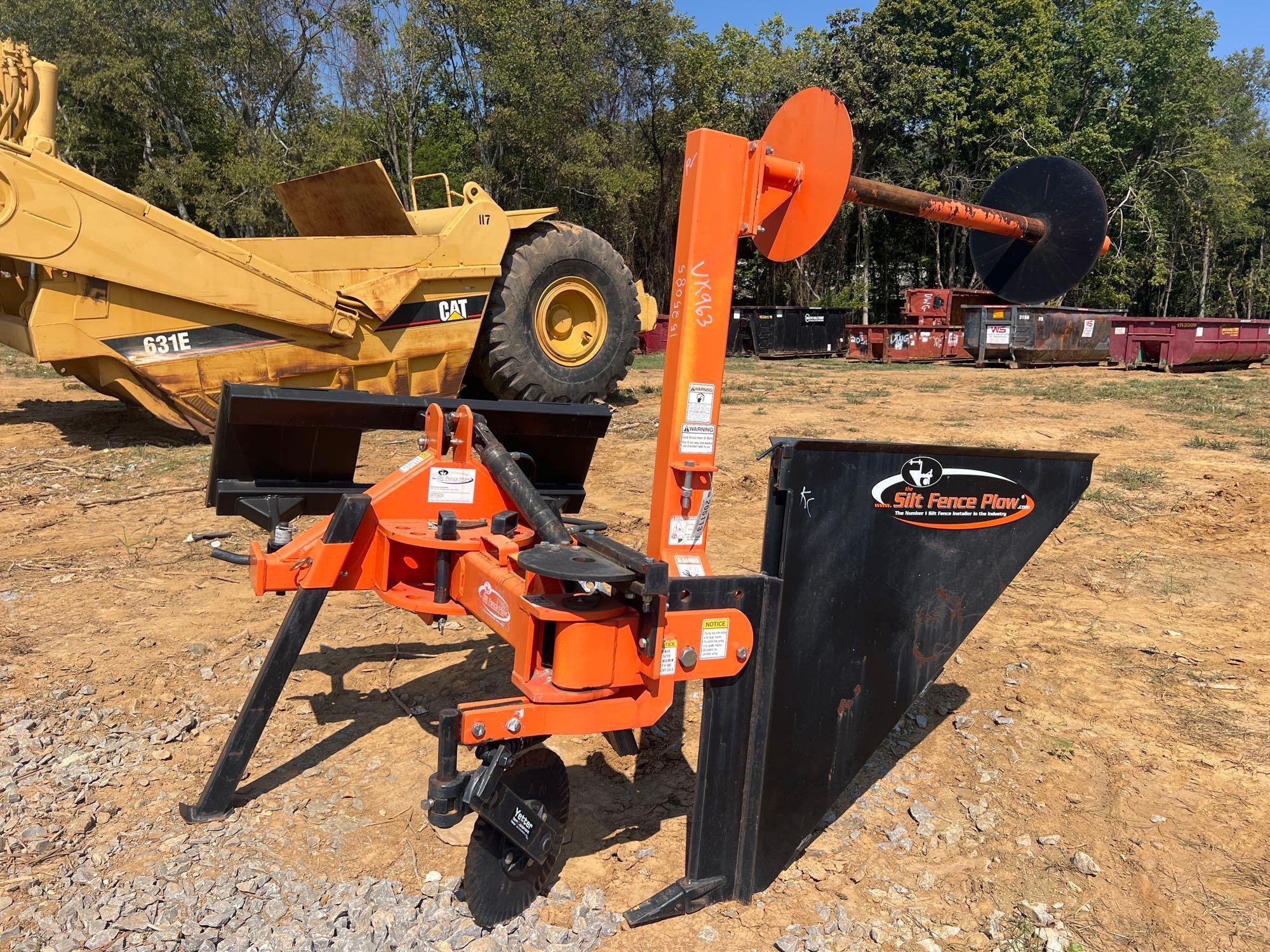

Maybe look at silt fence installing attachments for ideas.

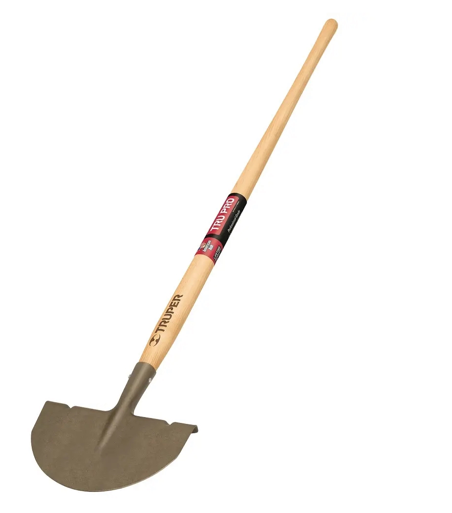

Most of the time I just use a tool like this...

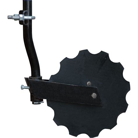

A plow coulter would possibly do what you want. Cheap to try as used ones abound.
Would also be easy to mount to side of your bucket.
