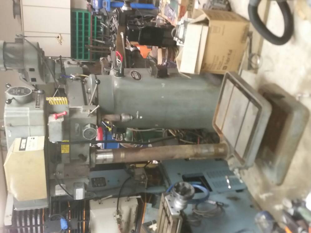

20170114_181745.jpgI picked up this Clausing 2276 last year from a surplus auction, needs a little cleaning but appears to have little use and was still cheaper then the 20in HF press plus it's a lot more machine.
I have 2 mills, a turret and a bed mill, I thought when I bought the first mill 5 years ago I wouldn't need a drill press again but quickly found out I was wrong. Mills are great but aren't a quick/easy as a drill press for a lot of things.
And as stated, tooling can easily be 2-5 times machine cost for things like mills and lathes.
Don't let 3phase scare you away from a good deal, motor changes, vfd's and rotary phase converters are all viable options.

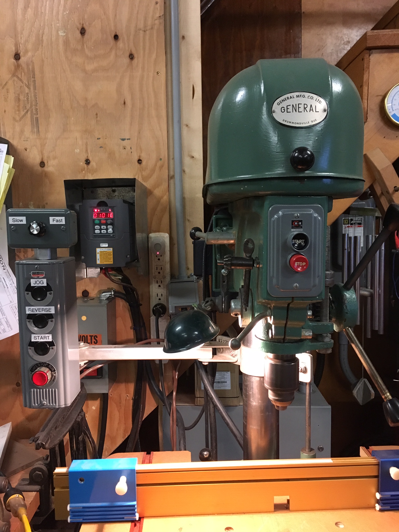

I have three presses, a General (Canada) 340 15 floor model with a 1.5 hp three phase motor and a VFD for electronic speed control, a Buffalo 18 tin top floor model beast for larger chores, and a Buffalo 15 tin top bench model. All of them are good solid North American machines that will outlast me, the most expensive one was the General at $300 because it came with a machinists table and the mortising attachment. I added a foot feed and the VFD and it is extremely handy for all drilling needs.
