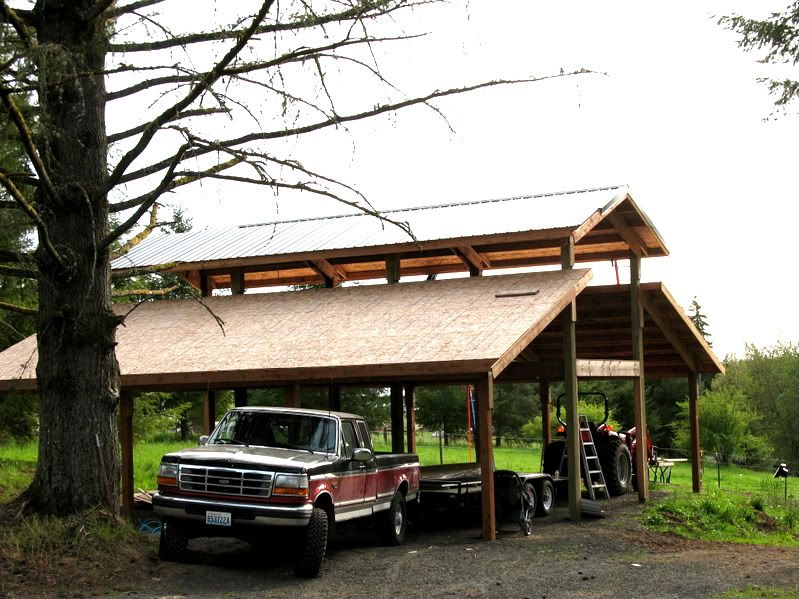

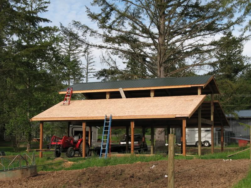

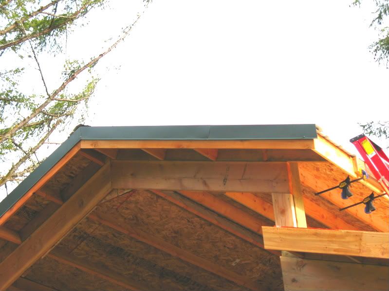

At any rate, here's a few pictures. I got all of the center section metal sheets up, and a good portion of the trim. I still have one section of ridge vent to put up and one entire side of gable trim, plus one section on the north gable end. I also have 6 entire rows of screws to put in this week. Right now the panels are just fastened at the top and bottom. Also have to get the last few pieces of cedar trim up...I shorted myself two boards doing the calculations on the fly when I found a good deal on those trim boards.
Looking east, ignore the torn up dirt section, this was the area I scarificed for the horses "winter" area. It will eventually be paddocks off of the barn. Just need to move over the fill and get the neighbor to bring the Cat over and grade it out.
Looking west...
Section of finished gable trim, I'm pretty sure this is what I'll go with on all the ends. The lower roofs will be a bit different as those will have gutters.

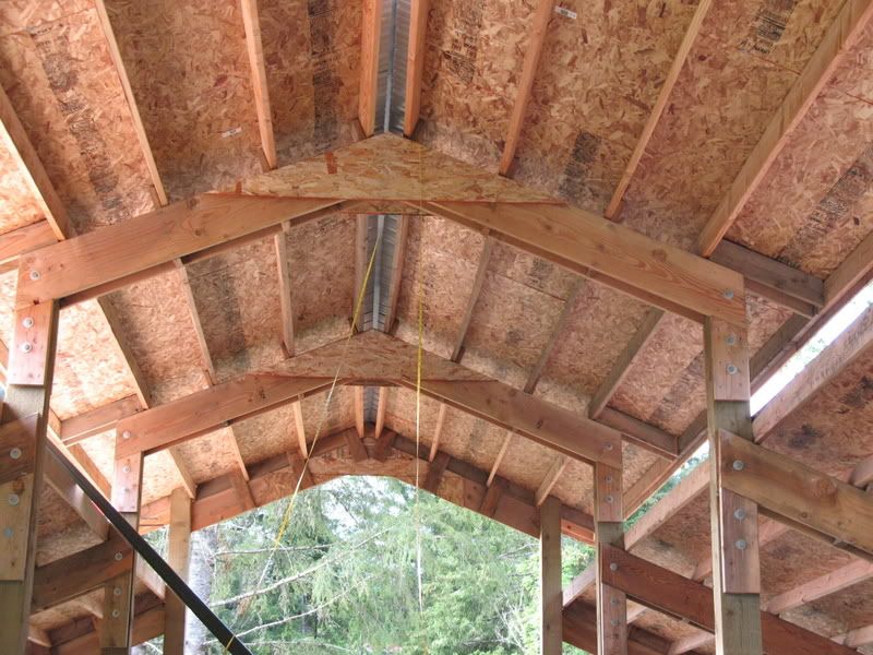

View from inside the loft...
