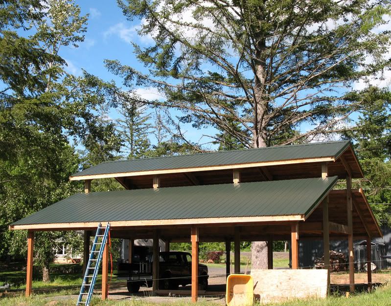

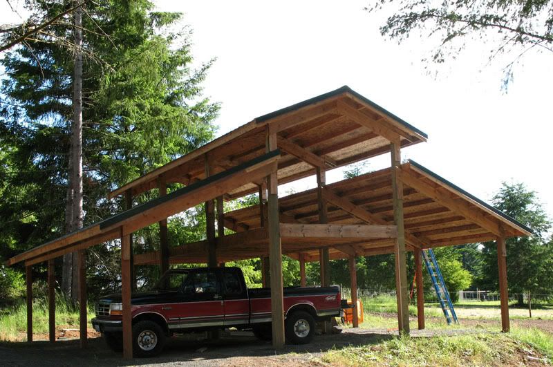

Quick update for those following...
Got all the metal on, it sure was nice having the OSB underneath and not having to worry about where I stepped. I have most of the gable trim on, only one side unfinished. Have a few more screws to drive here and there, but for the most part the roof is complete, and not a day to soon. I have the lumber list for the framing roughed out, and will probably pick that up this week or next weekend. I hope to start on that in the next few weekends.
View looking east...
Looking South...
Looking west, showing the relation to my other building...

SteelDust said:
...Got all the metal on, it sure was nice having the OSB underneath and not having to worry about where I stepped.
I know that some manufacturers specify using OSB or decking under their metal roofing, but it's pretty rare and only on certain types of panels. What type of roof panel are you using?
The one concern about using decking under metal is condensation. There needs to be a water proof layer between the metal and the wood. Most often, I've seen regular roofing felt paper used for this.
The roof looks like R panles, which are normally sealed at the ends to keep out bugs and moisture, but with decking underneith and the condensation issue, I wonder if you can seal the ends up? Getting the water out and not having it trapped would be impossible with the ends sealed up.
I put my purlins on 4 ft centers, and once screwed into the wood, are very stable to walk on. The profile of the metal creates allot of strengh and can easily support a person walking on it once attached. With one panel in place, I can walk and work from the top of it while doing the next panel.
The barn looks really nice. I like the design and use fo the second story. Very cool.
