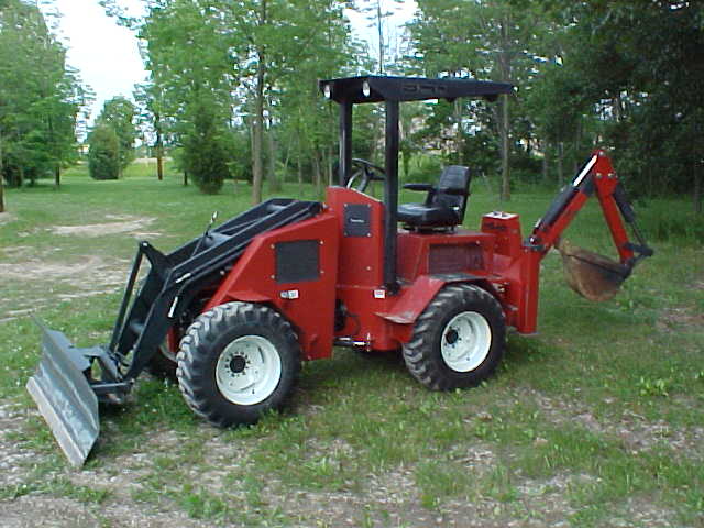

Do you have the backhoe on your unit - if so how does it mount? - Is the backhoe itself alot bigger and heavier than the smaller green unit - how much does it weigh
Also do you know of a way to quiet down the engine

Yes to the backhoe...pic attached. I have yet to remove it as it seems to serve as counterbalance...and I kind of like the rear weight, especially when moving dirt and rocks which is most of what we have been doing. Backhoe removal is via four pins and two hoses...not a big deal at all.
I'm not sure about weight, but would guess at least seven or eight hundred pounds. When removing, you just lower the standards so as to create a tripod with the bucket, unhook the hoses and pins and drive off. I'm waiting to finish the (in progress) shed so that we have a dedicated flat surface to leave it....would not want to try to muscle it around to line it back up to reattach.
Re: the noise of the diesel.......the main issue is that the Deutz is air cooled, so only so much can be done...even so, I thought of trying to do something with an additional muffler, but there is absolutely no room on my rig...the pipe is tucked up in the fender within a couple inches of the tire, and I don't want anything "outboard". I have found it to be not so bad....I just wear my "pro-ears" (per MChalkey's long thread on ear protection) and plug in "Dire Straights"
