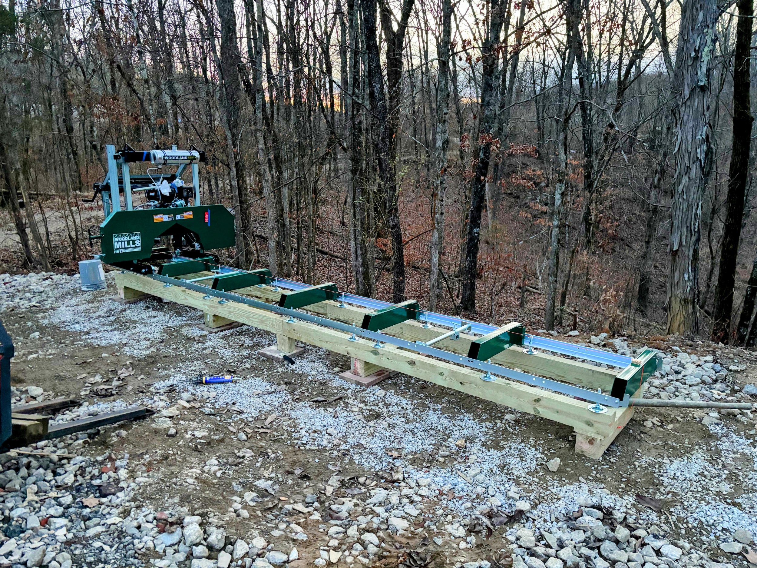

Getting closer!!! I will be milling this week for sure!!
That's great! I can't wait to see it in use.
For longevity, you might want to paint a little coppertox (copper naphthenate) on all of the cuts in the pressure treated to seal it against rot. Pressure treatment really only does the outer 1/8-1/4" of lumber, and cutting exposes untreated wood. I would probably put a little something over the but joint as well, like butyl caulk.

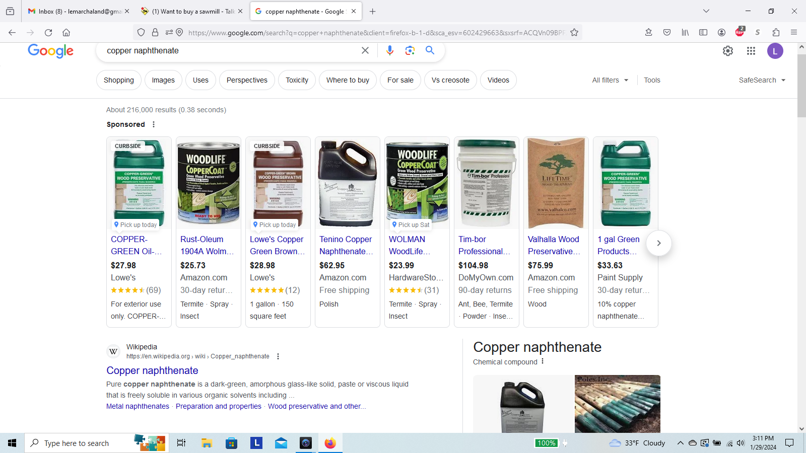

Are you talking about Coppertox, the stuff they use for Thrush and horse hoof issues? That is the only Coppertox I can find online.
   / Want to buy a sawmill - Talk me out of it! #173
If you look up copper naphthenate you will find several wood preservatives.
Sorry, yes, the Coppertox brand is used on horses, but it is the same stuff. Copper naphthenate comes in a pure, or a concentrated or a diluted oil (diesel) version, as well as a dilute water based version. I prefer the oil based formulas.
I buy the Tenino brand 17% (2% copper), which is the stronger of the diluted versions. Amazon carries it. Here, the local stores only carry the 1% version. I put a tray under the cut wood ends and paint it repeatedly until the cut quits absorbing the solution, and then come back a day later for one more touch up.

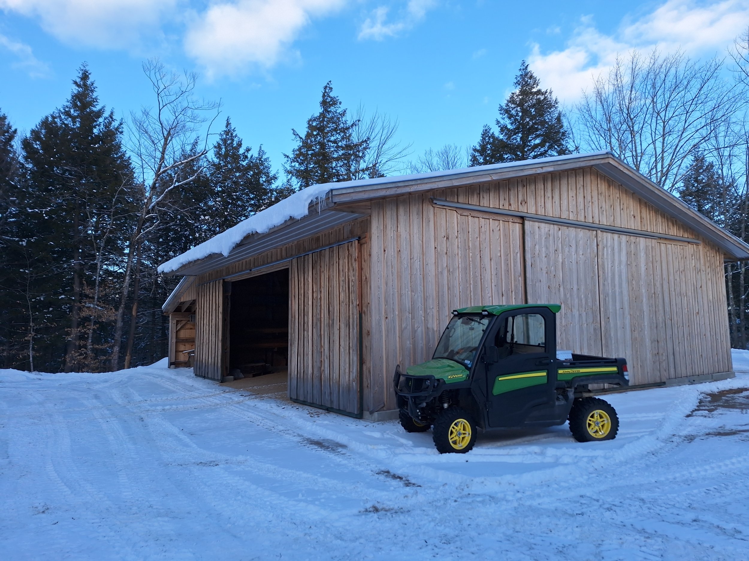

I cut this building for the mill.
Does that mean you bought it!?! If so congrats!
Yes, and cut it's new home also.
I've been building all of my life, sawing out your own materials is incredibly rewarding and kinda completes the circle of the process.
You'll love it!👍
#178
Yes, and cut it's new home also. View attachment 849382
You'll love it!👍
YES!! That is amazing!
That is a great way to look at it! I have been around sawmills a bit and have ALWAYS loved watching a stack of beautiful lumber taking shape. Maybe that is a big part if it, the instinctual builder in me seeing that the circle is now closing.
