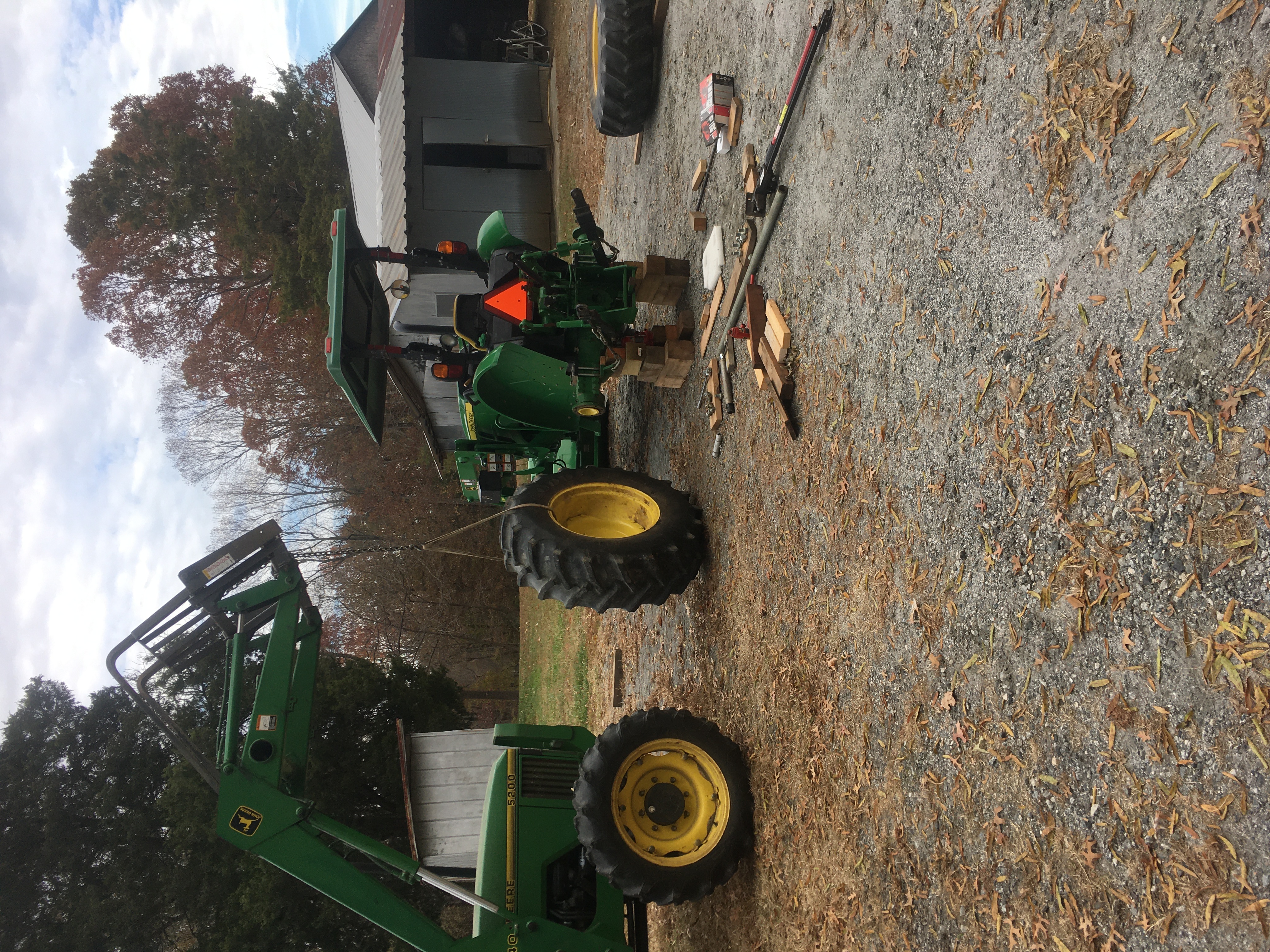

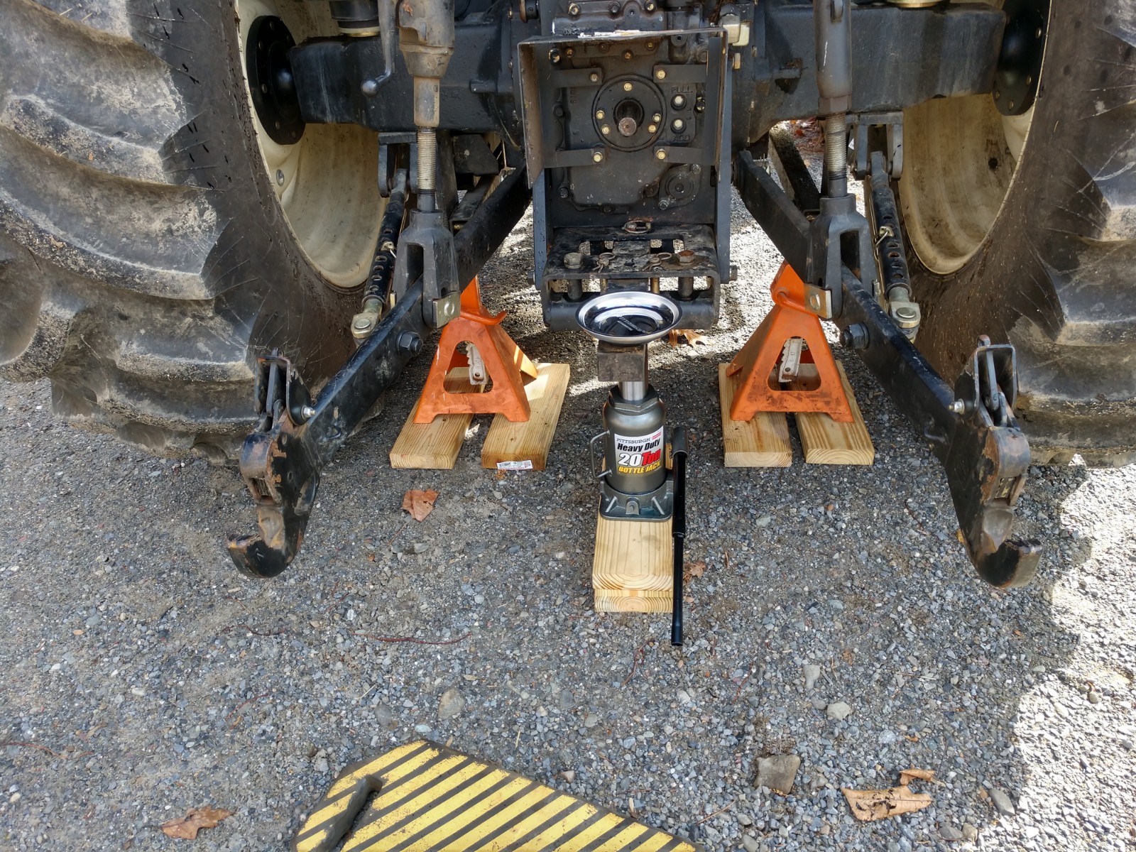

What we do whe moving a heavy tire and wheel assembly is to get the tractor ready to be jacked up.
If you are going to pull both of the same axle have blocks and wheel chocks in place.
Once you get the lug nut off and the jack adjusted so the wheel is loose on the lugs it can be carefully walked of the hub and away from
the axle were it can be carefully rolled to a safe place to rest it.
As long as you are carefull and keep the tire upright you can handle a large loaded wheel and tire if it starts to get away from you you have to be willing to step back and let it tear up whatever it wants to.
Also an engine hoist works good for holding a tire up right,
I built an engine hoist a few (several) years ago ad we have pulled a few wheels off using it, usually have to use a couple of bars or a come a long to get it to move as the castors are hard to roll.

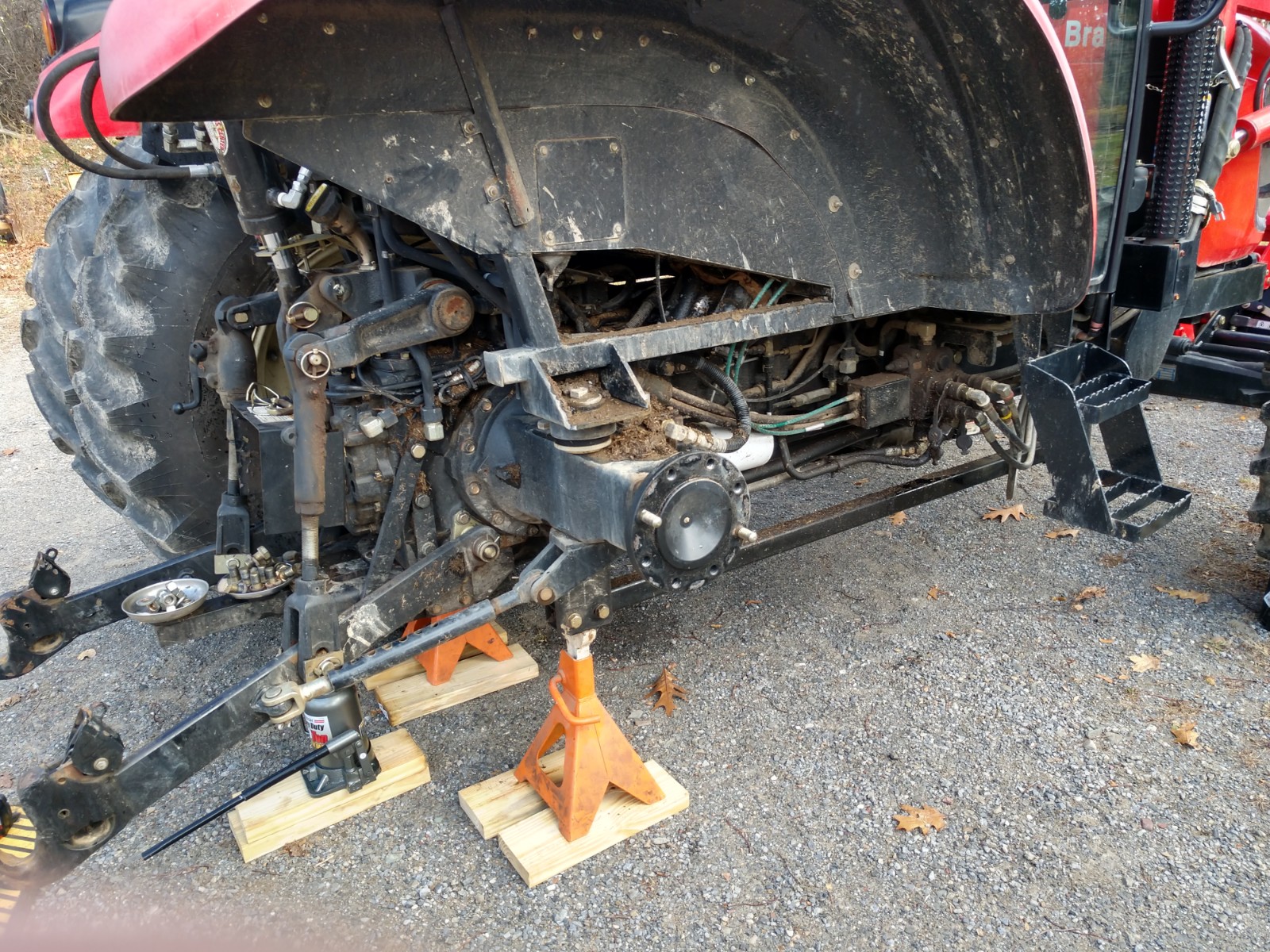

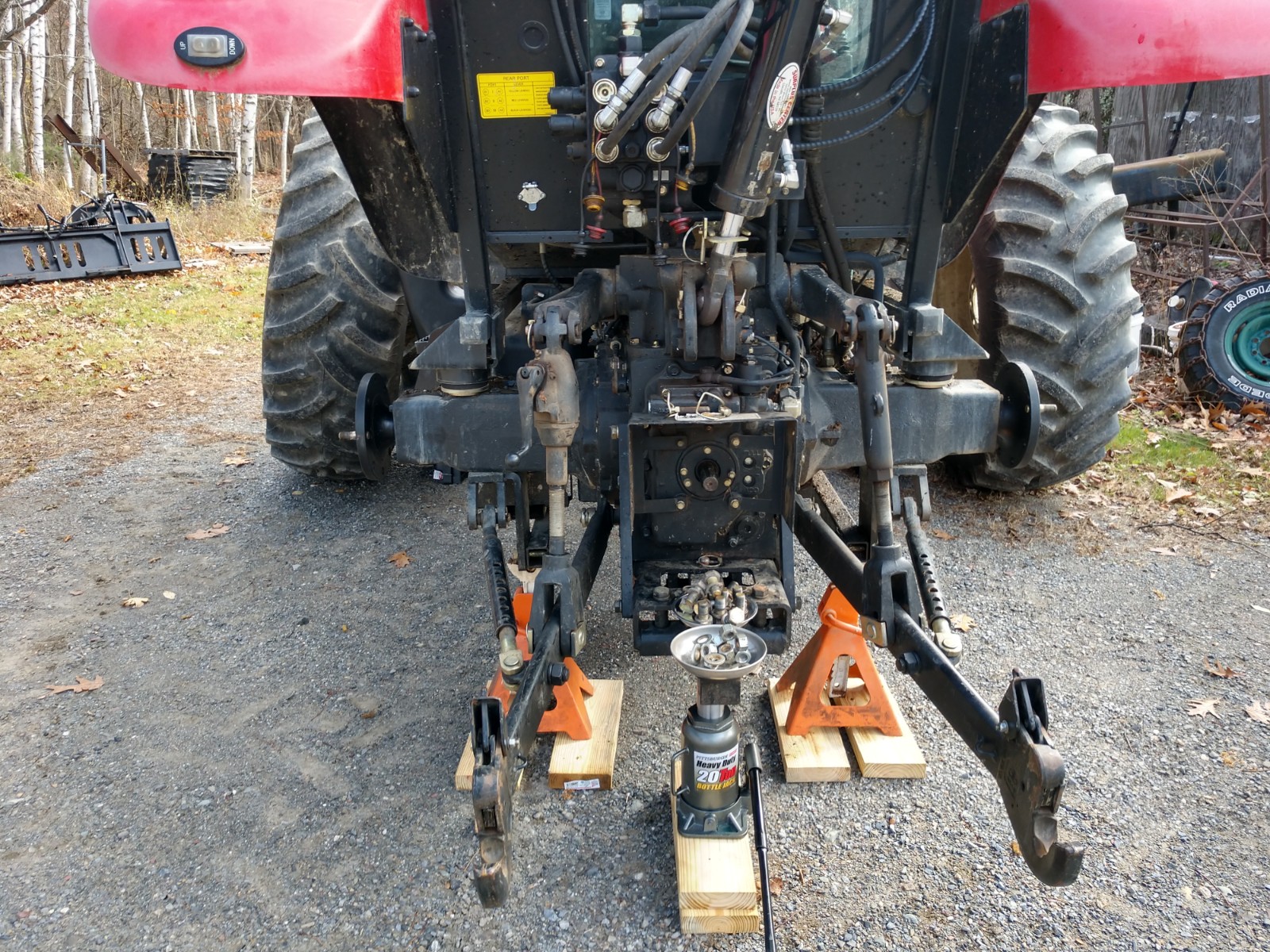

   / want get rid of calcium in tires #42
I suppose that will work with a backhoe and a smaller tire/tractor,
I know most of the hoes that I use the stabilizers are ot fine enough for me to just get the tractor weight off the lugs and not get the tire weight on the studs.
getting ready to jack.jpg ready to jack
one tire off.jpg one tire off
both rears off.jpg both off and leaned against the fronts, they are 18.4-30's

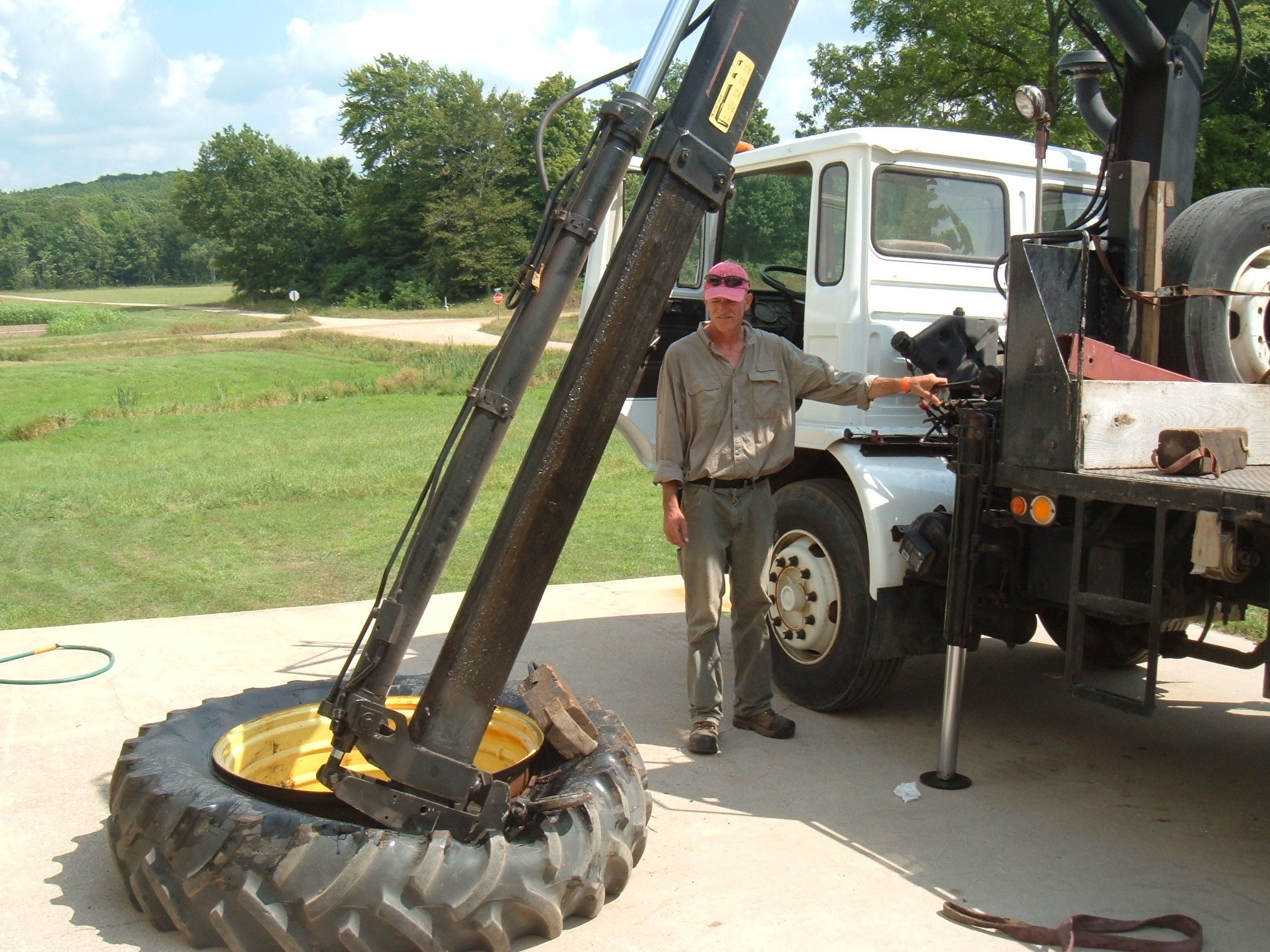

Safe and easy way to handle loaded tires 16.9 x 28 Notice the tire laying down has a spacer block to get the strap on.

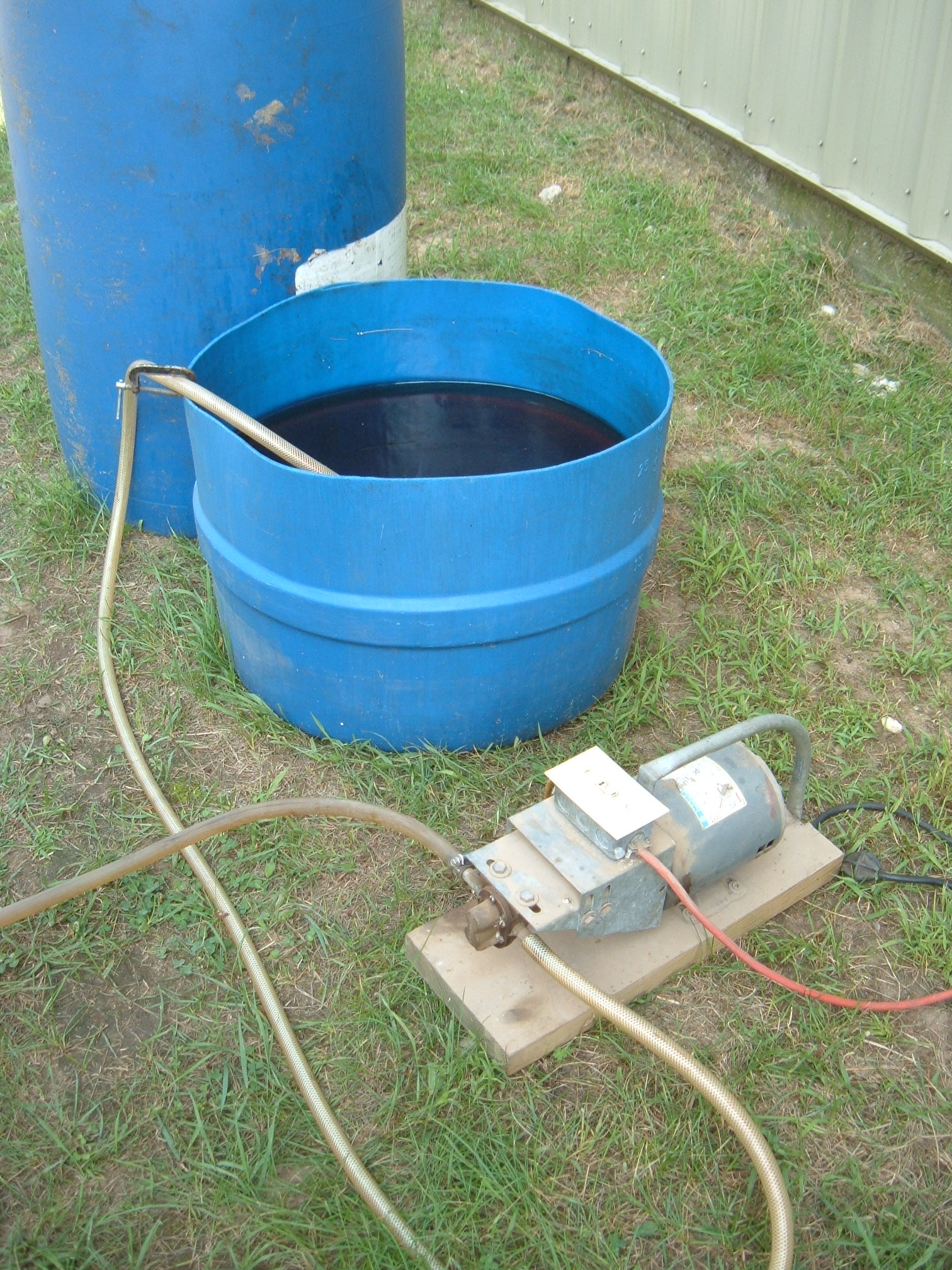

I diy too.

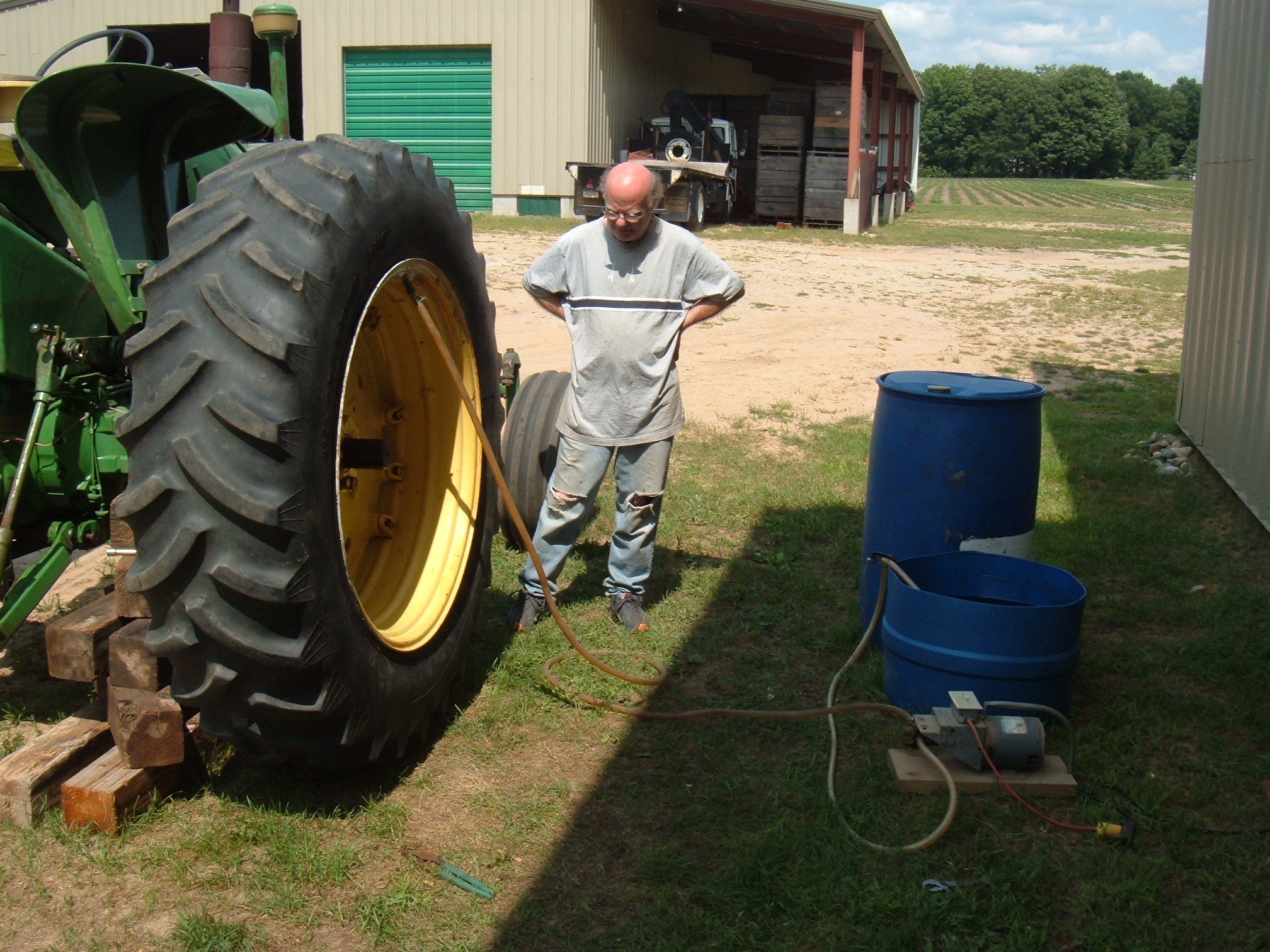

Any suggestions on how to get tires off the rims and back on?
When I changed out my tires loaded w calcium, I first got a cheap Harbor Freight pump and pumped all the calcium out.
Northern tools sells a set of "tire spoons" 30" long that i used to dismount the tires.
I got a 2x6 board, layed it across the tire and drove my pick up onto the board that was on the tires to break the bead.
I left one of the tires with the pick up on it all night and by morning, the bead was broken.
The spoons got the tire off and put it back on.
In the meantime, I brought the rims to a local welder and he tigged the two dime size holes in the rim caused by the calcium.
I then painted the rims with "bridge paint" on the insides,
I brought the tires to my local tractor dealership and loaded them up with beet juice, brought them home, and remounted them on the tractor.
I made sure the front of the tractor was facing outward so I could use the fel to pick up the tires from the p.u. bed and rolled the loaded tires to mount them back on the tractor.
