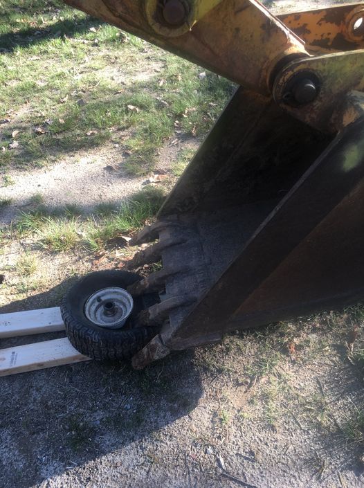

Don't need no stink'in Bead Buster ... Gots me a Tire Hoe...
   / want get rid of calcium in tires #33
I’ve tried that with old tires laying around just to see if it worked and I never got it to without damage. Maybe if the tires weren’t ancient it would have worked.
