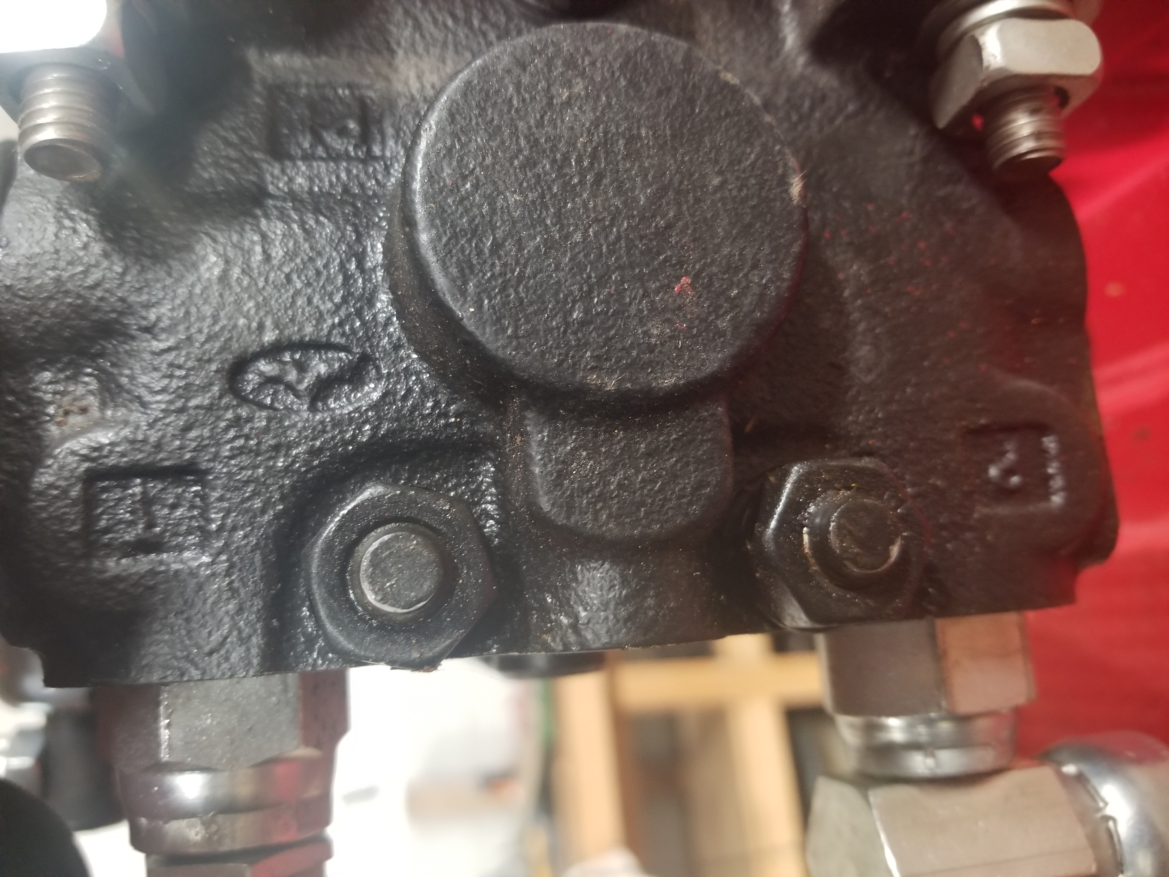

I am working on hydraulic plumbing for a 3pt bachoe. I am using a Walvoil 6 spool 16GPM backhoe valve i purchased from Surplus Center.
The supply/return ports are the same size and mounted above each other; so.....which is supply and which is the return?
[url=https://flic.kr/p/HE1E7y]Walvoil Valve by Ben Burwinkel, on Flickr[/URL]
/ Walvoil - Backhoe Valve
Once i got home, I pulled the serial number off and looked up the part on Walvoil's website. Supply is the bottom and the return is the top. Below is the cut sheet that shorts the port identification....hopefully this helps someone else out.
Walvoil Valve2 by Ben Burwinkel, on Flickr
Heres also an image of the casting marks "p" and "t" on the side of the valve.

Ok. Running off remotes is fine. Since you are returning through remotes and the remotes have PB to feed 3PH.
Just didnt want you trying to attach like a subframe (like if you didnt have remotes)....Because those dont use PB....since 3ph cannot be used at the same time with a subframe....there is no risk of pressurizing tank port. But with a heavy 3PH hoe....you absolutely DO NOT want to feed your 3PH off the T port on the backhoe valve.
Seems you got a good handle on what needs done.
