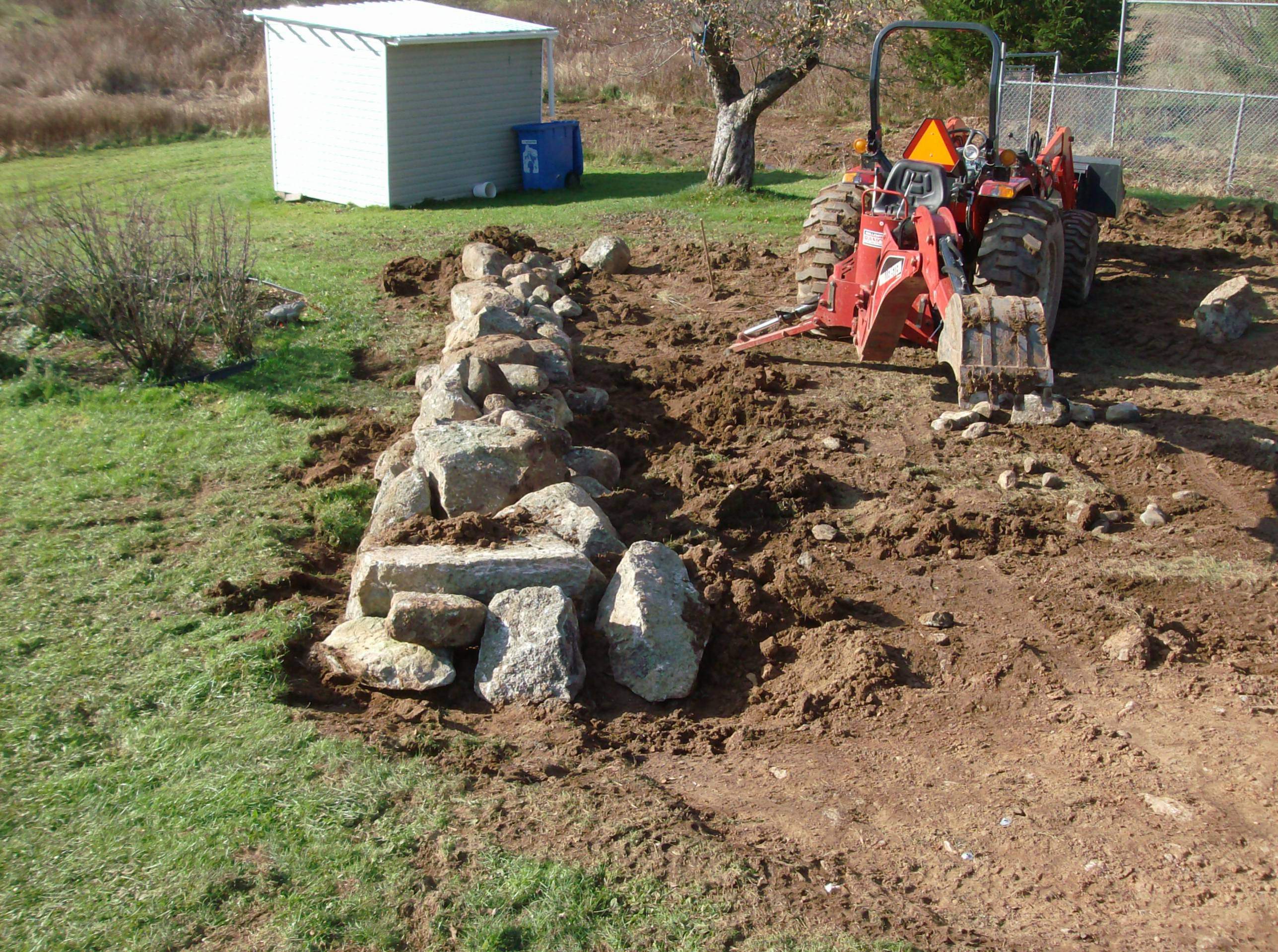

The other question is how would it work in the soil where I live? I am in Newfoundland Canada, known locally as The Rock. When clearing land for a greenhouse earlier I had to use a hammer and chisel to get out some of the rocks. They were about the same size a steering wheel and the ground around them was packed solid. Like digging in a roadway. Or would it be better to use a bigger piece of equipment.

Neffie dan..... I often have to dig out rocks that large and packed together Hardest part is to get the teeth in between . I like my BH bigtime.
I built a manual thumb for $100 because many rocks I play with are larger then the bucket.
