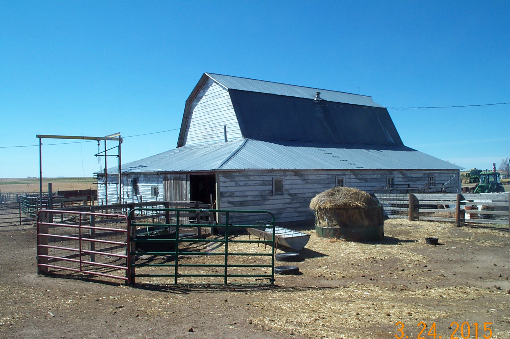

on my barn roof, where I have to get on it ocasionaly I took 2/3" EMT conduit, and used the double screw conduit clamps, and screw it on and in some places, I made a "ladder", since it is a old hay barn there are three roof levels, and the conduit is up by the top of the roof sections, and is such it will hold a ladder well on the middle which is close to a 9/12 pitch, the others are 4 or 5/12 pitch
it helps some on ice sliding off the roof as well,
If concerned one could place one at the bottom of the roof deck about 12" up from the bottom edge, that would keep one from sliding off, and or one could lay a ladder on the roof to navigate it if there was some thing to keep the ladder from sliding off. in some places I a couple of the conduits across the roof, it also keep the roof from lifting do to wind,
I usually place them about 2 foot apart where I have more than one,
not the greatest picture but one can see the ladders on the north and east side and some of the conduits on the east side (back)
