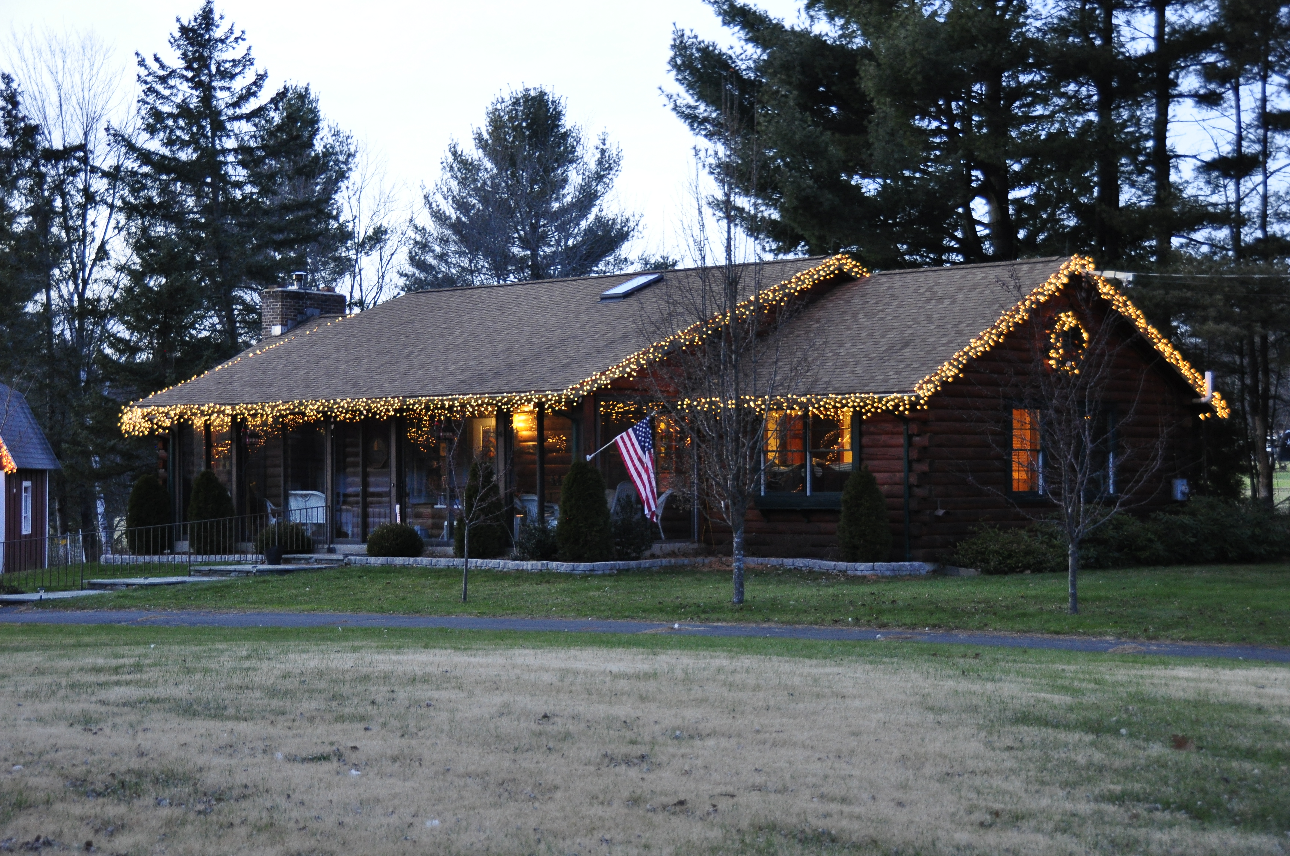

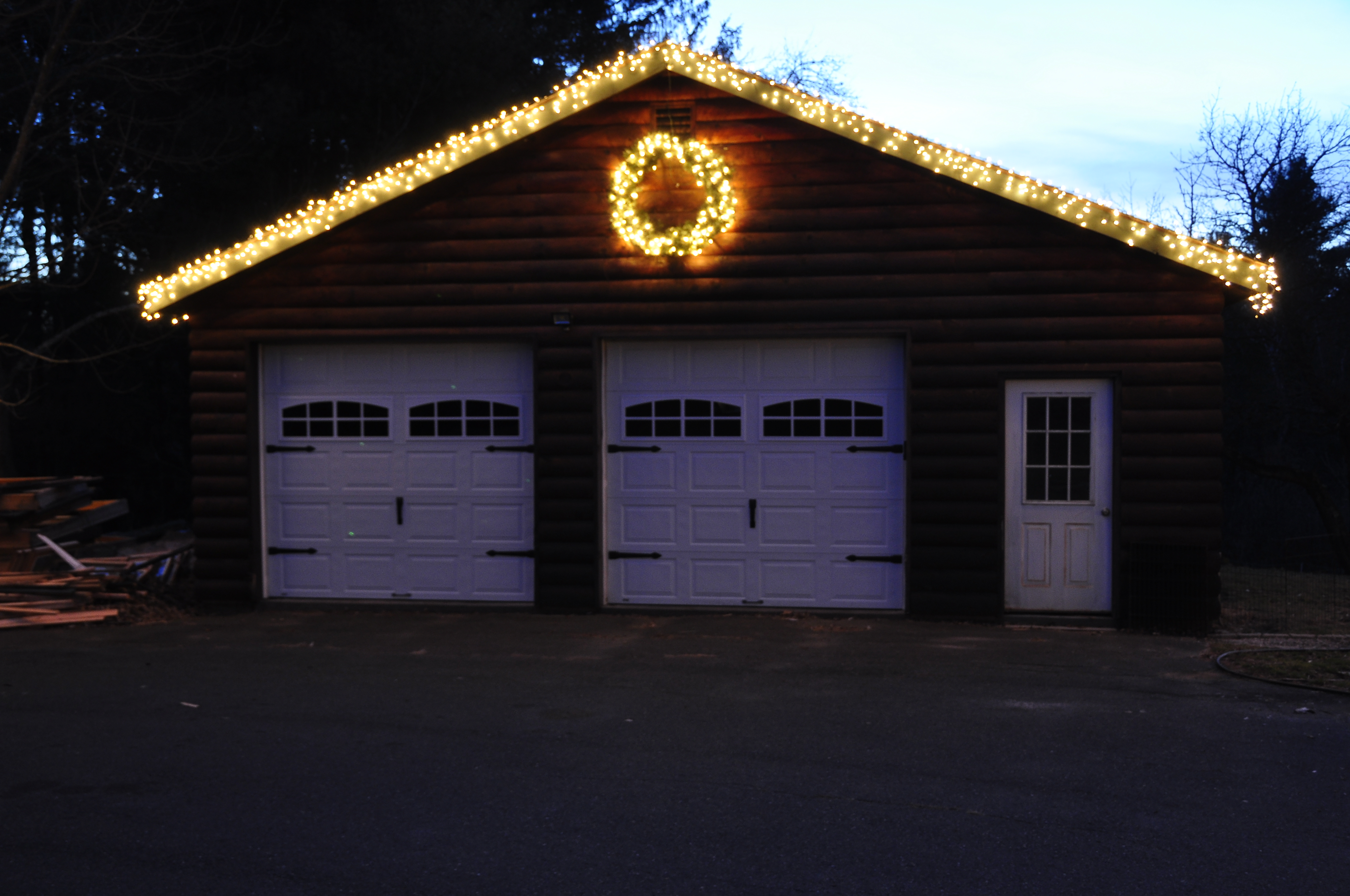

In May 2018, a severe thunderstorm rolled through NW Connecticut with tornadoes, high winds, hail and rain. At the time, I did not see any damage to my roof. At the advice of a family friend, I just had a roofer inspect my roof and he determined that I did have hail damage, and I should contact my insurance company. They sent out an inspector, and he agreed, and my insurance company approved $28K to remove and replace the shingles on my house, garage, barn and shed. Total roof is 65 squares. 30 on house, 24 on barn, 8 on garage and 3 on shed. Roofs on the house, barn and garage are all very simple open gable. No dormers and no valleys. Slope is shallow, I can easily walk on all of them. Shed is a gambrel roof. Insurance gave me $6K for tear off and $22K for materials and install.
I'd like to take the opportunity to do the re-roof right, and ideally get a roof that lasts 40 years or so. For the house, first choice is a dark green standing seam metal roof. I've been looking at ABC American Building Components SL-16 hidden fastener roofing. It has a 40 year paint warranty against cracking and peeling and 30 years on fading and chaulking. I like the hidden fasteners so there should be no opportunity for leaks. Has anyone had one installed or installed it themselves? I'd like your opinion.

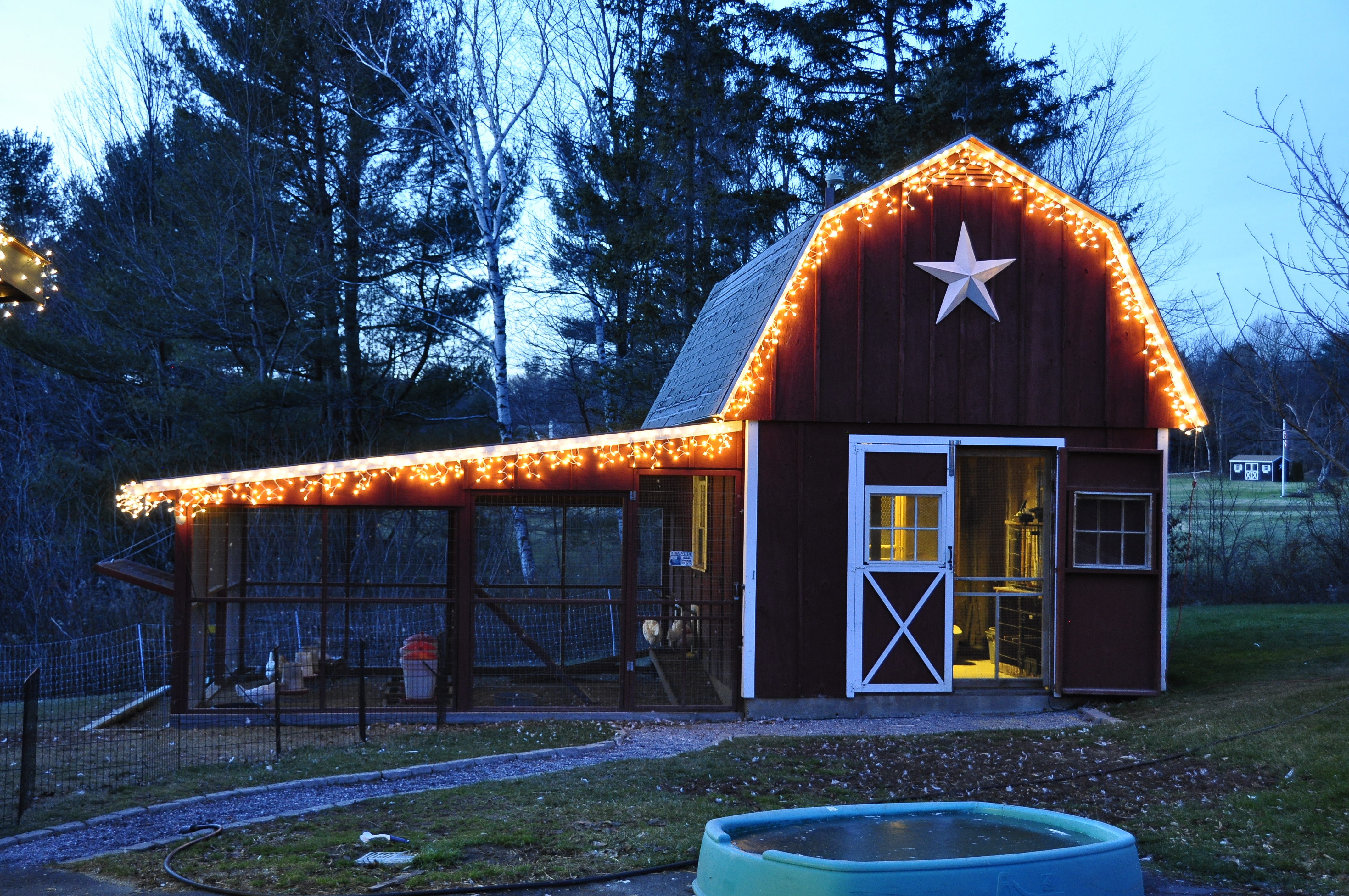

For the garage, shed and barn, I was thinking of an exposed fastener metal roof like ABC's Imperial Rib. I actually have that on my 15x15 chicken coop roof, and wouldn't you know it, it was the only roof on my property to have no hail damage! It also has the 40 year / 30 year warranty. I would plan to do the roof on the barn, garage and shed myself.
If I can't afford to do metal, I would consider a high quality architectural multi layer laminated asphalt shingle. I know they claim 40-50 years on some of the newer shingles. Was looking at GAF Timberline HD.
Would be interested in anyone's advice and recommendations, and specifically any experience with ABC's metal roofs and Timberline HD shingles. Thanks!
Here are the 4 roof lines. Note, we will be removing the skylight on the house. The barn roof is sagging. It was built in around 1800, and many of the rafters are sagging. They are chestnut and much smaller in size than we would use today, about 2"x5", so I hope to install a ridge beam and replace the rafters with whatever 2x? is appropriate for the span.

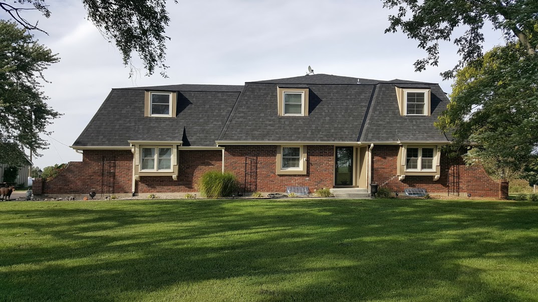

We have a Mansard Style roof, very steep pitch. My roofer I went with suggested Owens Corning for this type of roof because they have a reinforced nailing strip called Sure Nail Technology. We talked about metal but in the end he convinced me to go this route. Glad I did, it looks great.
