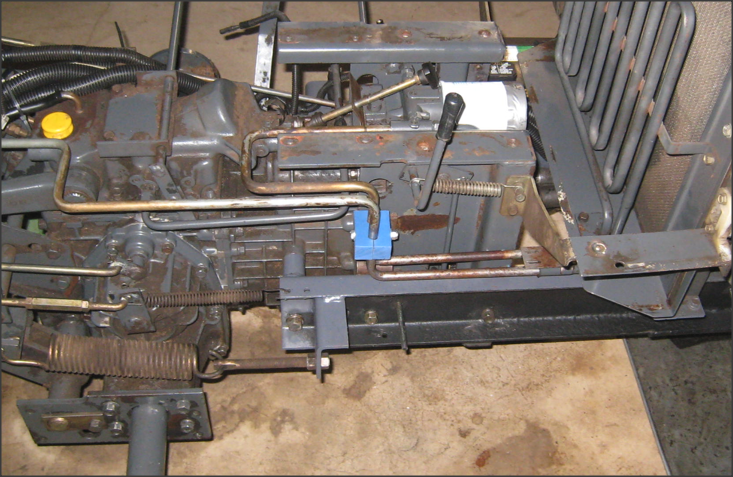

For anyone that may be reading this looking for info on removing the radiator.... do not remove the bolt circled below, that'll loosen the hydraulic lines and possibly disturb the o-ring. The radiator has to be removed with the shroud intact as well. It's not too bad, be sure to loosen the fuel tank and pull it out to the side as far as you can so you can reach behind it for 3 bolts. The rest are all relatively accessible.
You are doing good maintenance & repairs on your F mower, thank you - keep posting please!
About those two hydraulic oil cooler lines:
When I was reassembling my F3060 two years ago, in addition to all new HST seals, front differential seals, rear axle etc. seals I added small homemade plastic support for the cooling lines since especially one of them is a pretty long steel line and subject to vibration, which will wear out those little O-rings over time.
The plastic block is not attached to anything else, just connecting these two lines together.
Just to clarify: I am talking about a mower with 3600 hours of use when I did this little improvement!
Not a big deal.
Cheers

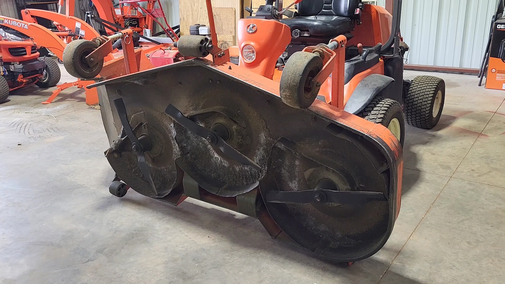

This machines nickname is "Cloud". That's because I'm usually in a cloud of dust or grass. I raised the mowing height and get a lot of blowout from the front of the deck. I have dome rubber I can make a skirt for the front out of. I also seen some kits for Deere mowers online the have a lip along the front bottom edge to prevent blowout. I can't be the only one experiencing this with the F. Since the deck is out front you end up driving right into the cloud...

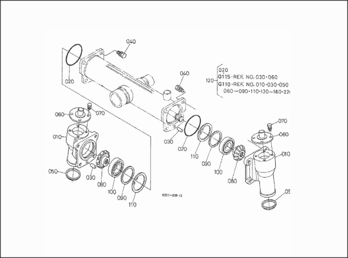

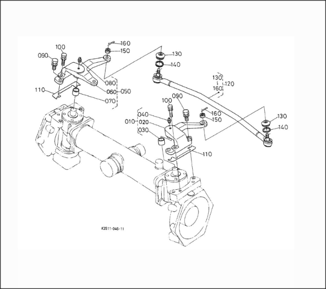

Regarding steering:
With over 2300 hours on your mower, you may want to check if there is any slack in parts 030 bushing, 120 tie rod joints & "support, knuckle" 060
Please note, these are from parts drawings for F3060 so the numbering may be different but I think the rear axles are built about the same.
(030 is a plastic bushing and should be lubricated fairly frequently I think)
I would also check for any slack in rear axle pivot point & adjust as per shop manual.

One thing I dislike about my F is when mowing lawns with lots of particulate mater (leaf bits, dirt, dust) the side discharge mower deck seems to blow quite a bit out the front edge and it ends up in my eyes or shirt.

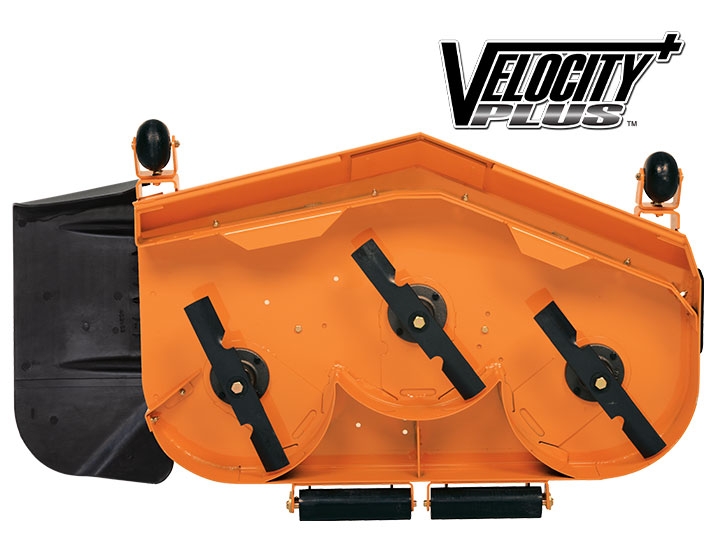

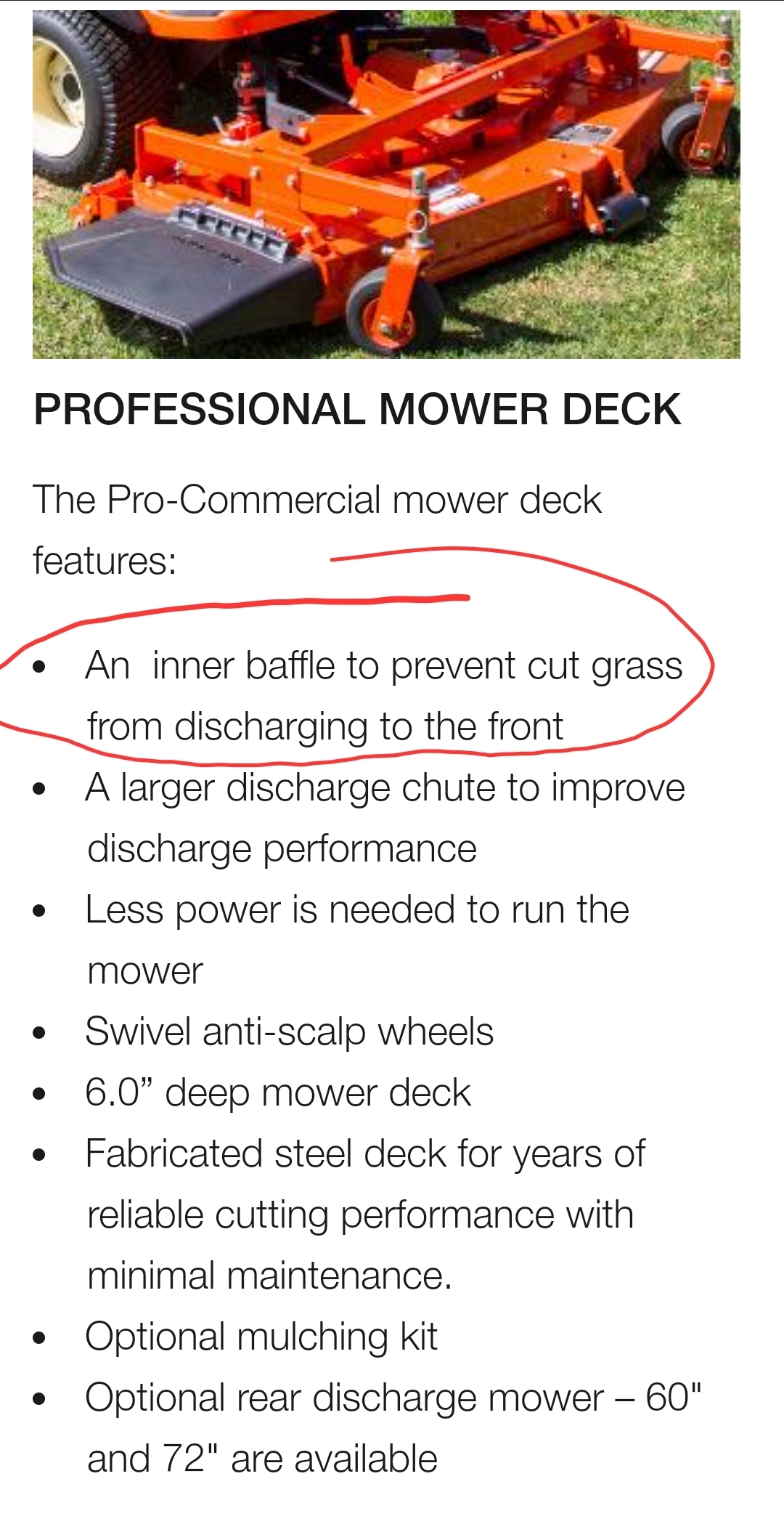

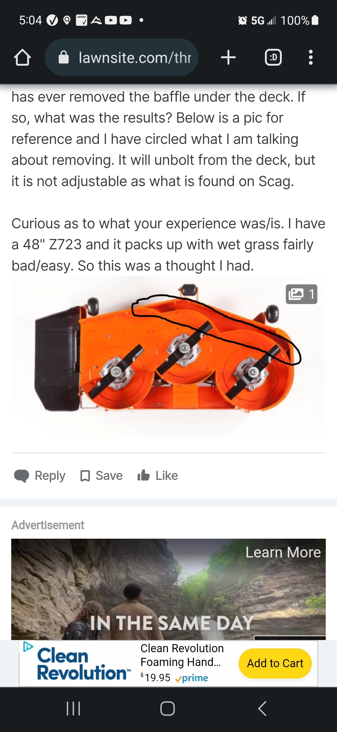

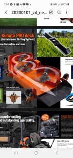

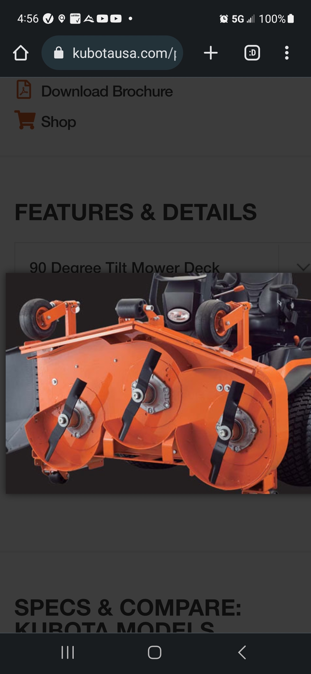

My deck is actually a side discharge. The main issue is blowing out from the front. I checked Kubotas site and they have this on the F series page: "An inner baffle to prevent cut grass from discharging to the front."

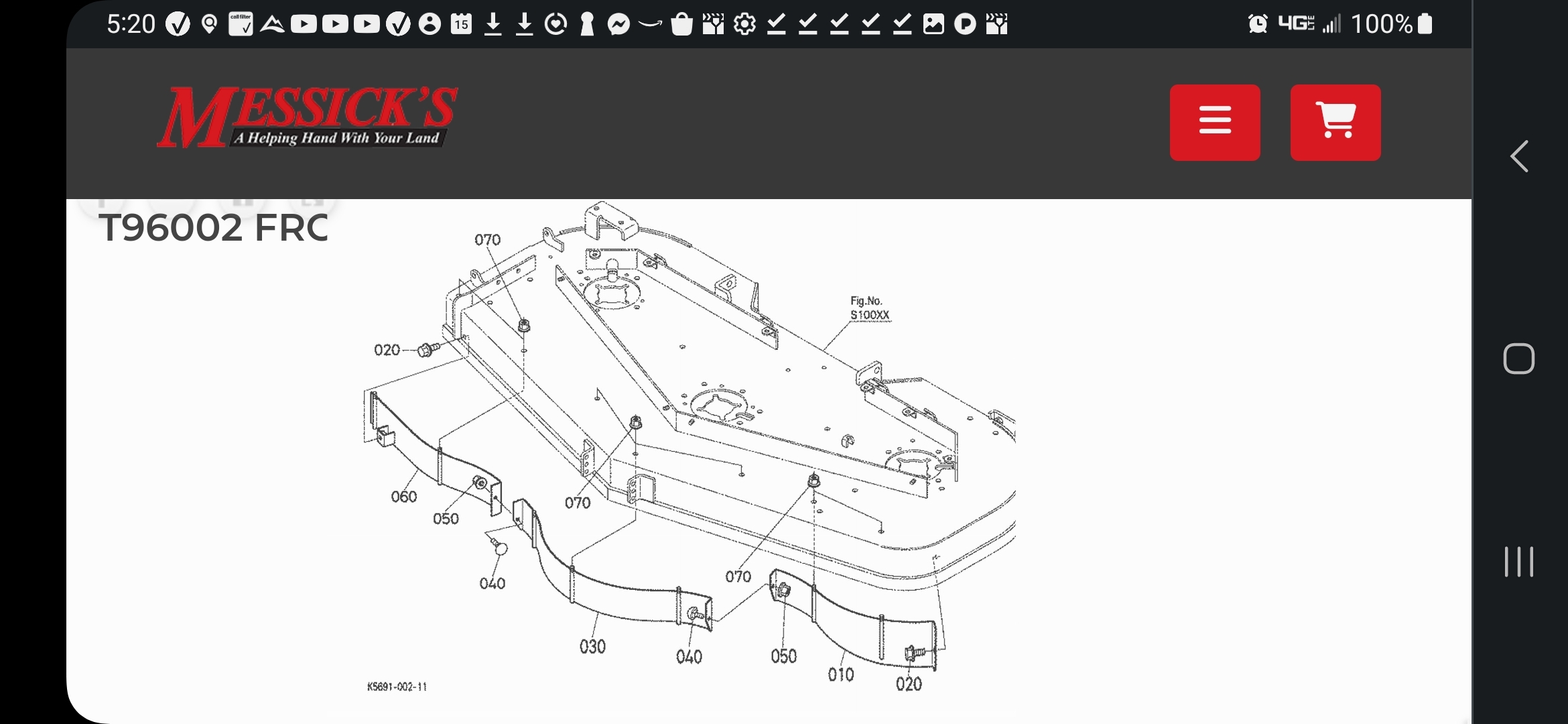

I searched several forums and it seems that a front baffle helps prevent blowout. Messicks has a "Front Kit" bagfle option but it would cost nearly $300 to try out.
I looked at Skags website and they have a protruded front on the deck and then an internal front baffle with some flat pieces that come back between the blades. I'll attach pictures of all this, hopefully it'll make sense.
I've also noticed that on Kubota's website the pictures of the ZD and F decks show a small lip along the leading edge, only about 3/4" long, I wonder of that is for airflow or something else? Mine does not have that lip.
I believe I'm going to have to spend some time fabricating in the shop to get this thing working better so I'm not eating dirt every time I go over areas with thin grass. :)
One attached screenshot is of a post on a different forum where a guy took off the front baffles if a Kubota deck and it caused a lot of blowout so he out them back on.
