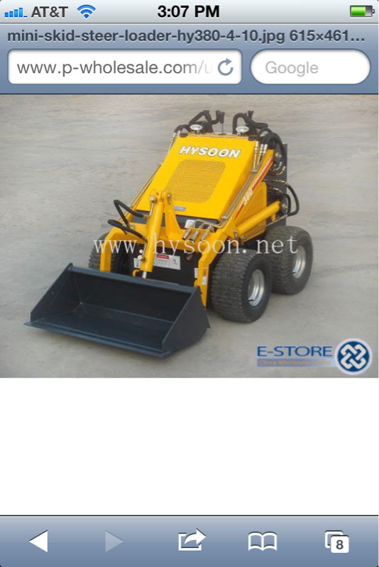

This is kind of what I'm going for

Do you think the hydro motors on the mower can handle the weight
I don't think your Lesco will handle the weight. If you design it right, the hydro motors aren't actually supporting any weight.
I think you have a good start with an engine, etc., but I'd plan on build the frame out of heavier stuff than that mower is made from.

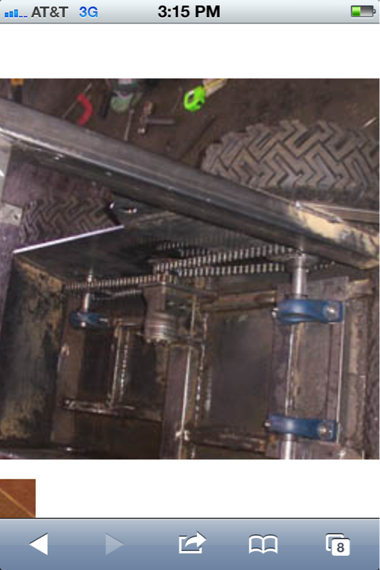

Thank you all for your responses they are very helpful Does anyone know what size sprockets and how many teeth this is what I'm thinking with the wheel Motor in the center

So after pricing all the sprockets and chains and pillow blocks etc I think I'm gonna buy 4 wheel motors and attach them directly to the wheels any suggestions on low speed high torque and is 10cu enough I'm new to hydro motors and don't know what to look for
/ Walk behind skidsteer #14
Go to your nearest golf course. Somewhere out in the weeds behind the rough there are a few old reel mowers. Probably orange. Offer the guy a few bucks for everything there and take the wheel motors off those. There are likely two per mower.
