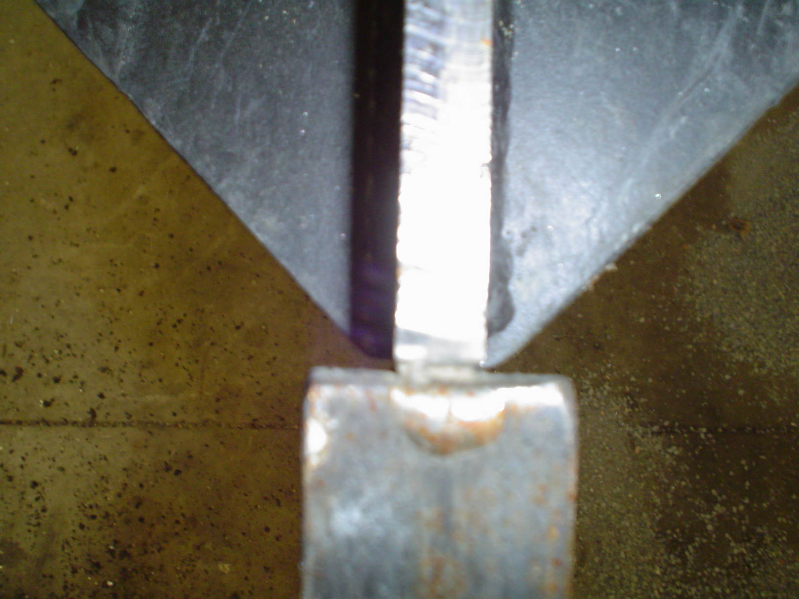

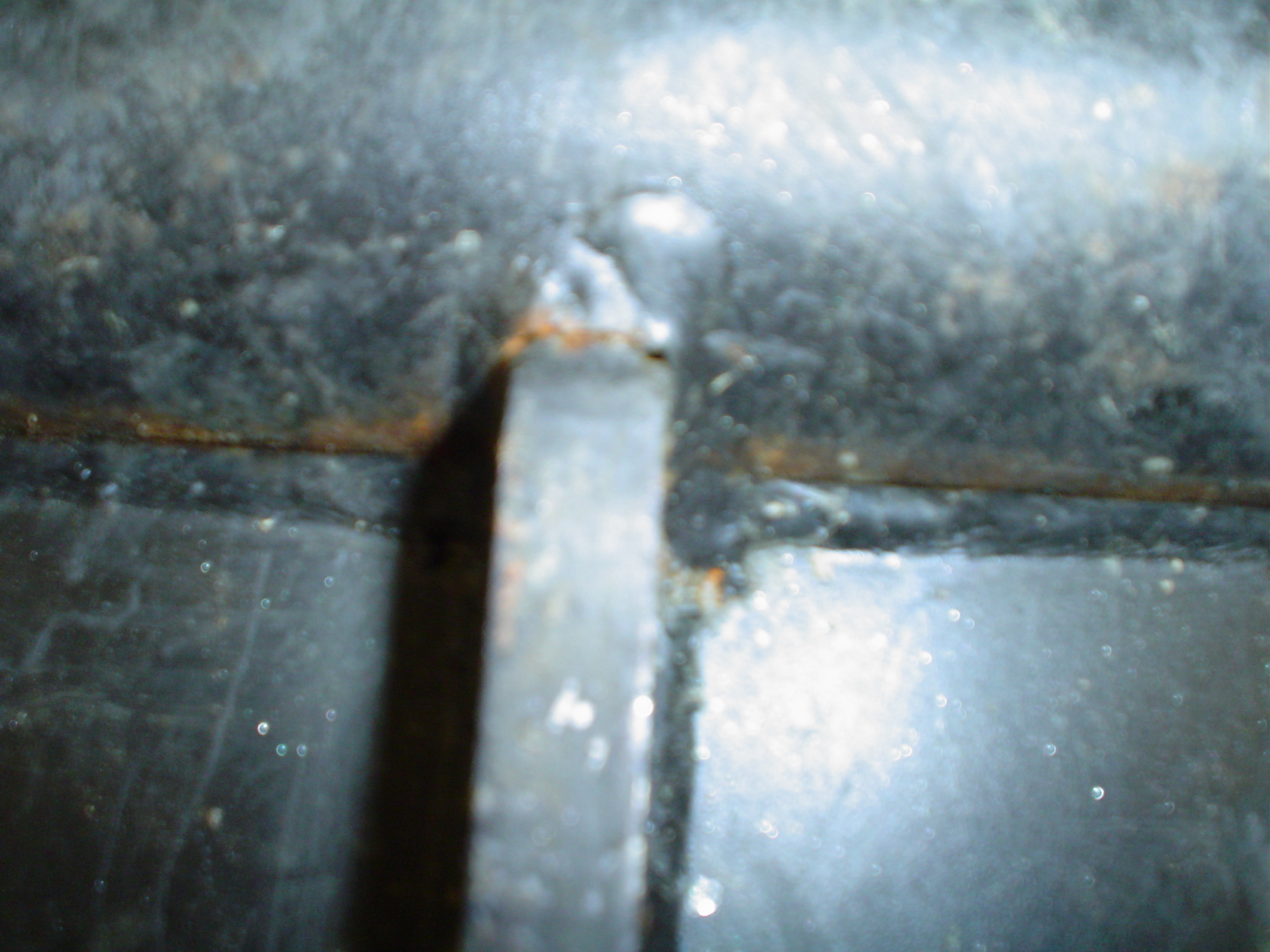

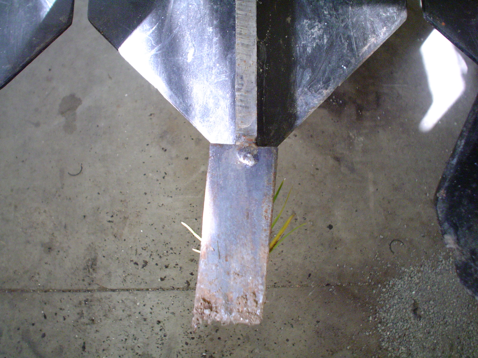

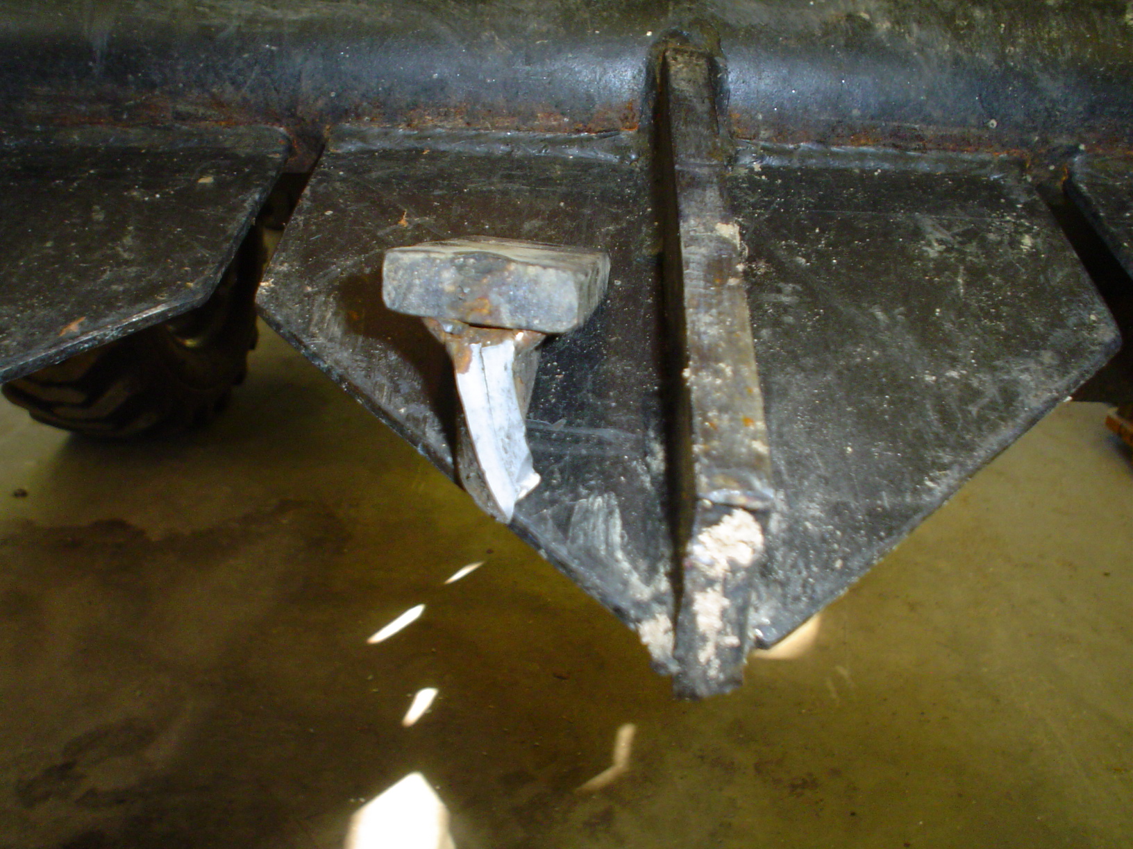

I finally got some down time and was able to get the grapple welded back together, and some pictures of the damage. The welding shop said it appeared as though no one looked at the finished welds, because 5 of the seven teeth were not welded at the top. There was a bead, but it missed the shank completely on those five teeth. The second picture from the left shows the cracked weld at the top of the shank with the broken tooth. The welding shop also said it seems as though some of the welds Had very poor penetration, and some were perfect. Don Sloan informed me that the entire grapple is computer welded with flux core wire. So the inconsistency doesn't make any sense to me.
