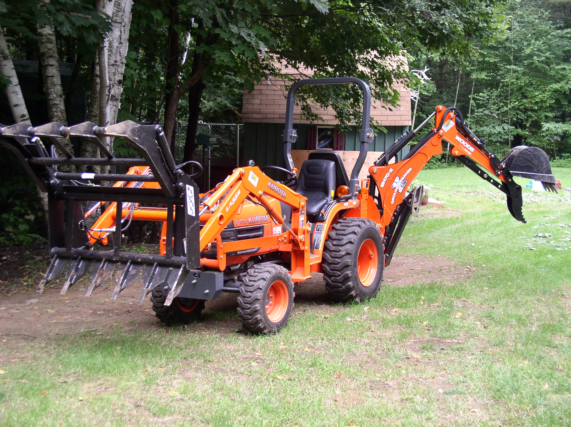

I too, have the RGB2-48 on my B7610. I love it. I know I lose some lifting power, but it does not weigh too much more than the Millonzi (40#?). I really like the fact that it opens 48". The clamshell design has been nice in removing small stumps as I can curl the grapple completely around it. You won't be dissappointed with it!
I think I attached a pic of it??
