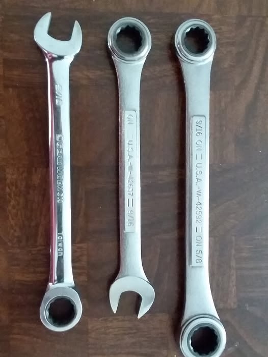

/ Vintage tools
#16
Interesting that I have all of these wrenches and was this many years old today when I learned any of this... :rolleyes:
