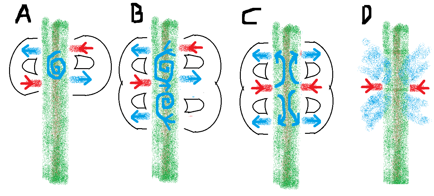

/ Vineyard Foliar sprayer - Design, ideas. #8
why not a recovery system? or rather a vortexting / whirl pool like air currents.... all i see is a pressure washer, with a wide fan spray pattern. were most of the stuff is being lost to everything else around the rows... if it does not hit and touch a given spot in first pass of the nozzles. it is wasted it looks like to me. it is kinda like trying to use a can of spray paint, and trying to get it all covered with a single thick one time pass of the spray paint. it does not happen that way. you normally need to apply a couple passes of spray paint to get a full coverage when painting something. there is not a single difference between a can of spray paint, and sprayers used. exception more spray cans used at a one time errr spray heads/nozzles. but even then i am still only seeing a single pass, that is going to create more of a droplet / runs in paint, vs a very thin fine layer of mist on things.
i guess what i am thinking of is more of a mini containment system. were you have a couple set of different rows of spray heads and row of fans. that blows the mists back and forth across the fence row/vine row, multi times. and in different directions through the row. other words "spray once", route wind direction back and forth a few different times via whirl pooling / vortexing like air currents.
see attach diagram...
TOP VIEWS
A = single vortexing current created. spray heads on each side (red), are not directly across from each other. but are separated... say 4 to 6 feet apart. each set of spray heads also has a "fan"'s more likely multi smaller fans. to create additional air current.
--not much of a recovering system here. simply spins the air through the row
B = same set of spray heads and fans right next to the spray heads, BUT!! a bit more complicated containment system to "route" air flow back through the row a couple times.
C = putting spray heads directly across from each other... this is kinda like 2 cars doing 100MPH in a head on collision. very violent wind currents as they both meet up and crash together. guessing not a very good actual coverage. most gets it but very sparadtic coverage. vs B diagram.
D = currently what i am seeing. no recovery system, no multi passes. the only thing that actually connects with and stays on the leaves and vines, is what is at the very outer edges of the mini chaotic currents as stuff gets blown. leaving a good amount of the rest to disperse else were.
B diagram = mini containment system. could be some metal pipe frame, draped with some cheap 6 mil or like plastic. maybe even using some of the various pvc like fittings for custom / diy green houses.
--guessing frame work and plastic would more resemble a long small shed, that you could drive through with a riding lawn mower. and 4 columns (plastic covered) to help direct and create vortexing air currents within the center area.
trail testing... get yourself some cheap box fans. some cheap plastic, some duct tape, and what ever you have laying around to make a duct tape up frame with. and then a couple cans of spray paint. see about using some branches / trimmings that you did, and toss into a pile (long wise) and see how and were the spray paint ends up at.
--err second thought spray paint and electricity don't really mix together to well, there might be a rather large BOOM! and you died. maybe a spot sprayer / hand pump 1 gallon type, and a can of red paint. and see were the paint ends up at.
you don't need super wind of a tornado, but something little bit stronger than a genital breeze, that keeps the chemicals/water suspended within the air, and let the leaves flutter a little bit. let the air currents do the work. vs trying to force the air current (get the bigger tool / what ever out) to get the job done.
a can of spray paint doesn't have a huge amount of air pressure in it. nor do sprayers, granted pending on chemical using, and spray head, you may need extra to atomize and break things down to smallest size possible. but once you get to that point, you do not need to keep adding on the pressure. nor do you need to / want to jet the mist. but simply genitally blow it around. so the smaller particals of stuff do not crash into each other and create larger droplets of rain / runs in paint / droplets coming off of leaves.
or am i completely off my rocker?
to original poster, i am sorry, it seems i took over your thread, it was not meant to be that way.

You're off your rocker. :) Not really, but the whole point of an airblast sprayer is to spray both sides of the leaves in one pass. That airblast gets the leaves moving and flopping around for more complete spray coverage and doesn't hurt the vines at all. It has nothing to do with creating air droplets or anything like that. Its about moving the leaves and about penetrating the canopy to get spray coverage into the center of the vines and to get spray on the fruit (fruit can be hidden behind leaves).
Don't overthink this guys....just get yourself an airblast sprayer or make one.

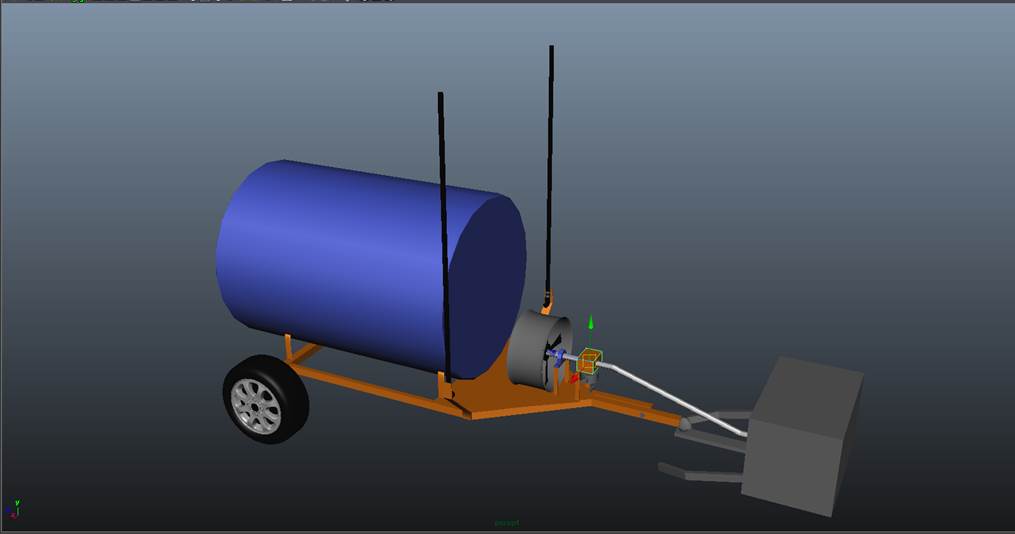

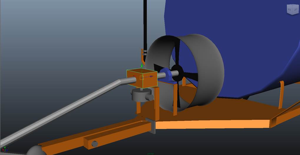

#18
Alright I did up a quick sketch for where I'm headed. No plumbing included. Basically it's a trailer styler, with the PTO driving a three way gear to power the fan and the roller pump. The fan would be shaft driven with a pillow block offset from the gearbox for wobble support. I did not include the air venting in there yet. Was thinking 50 gal plastic drum for the container. Pics attached.
This would be all build no buy basically besides the pump and the gearbox.
