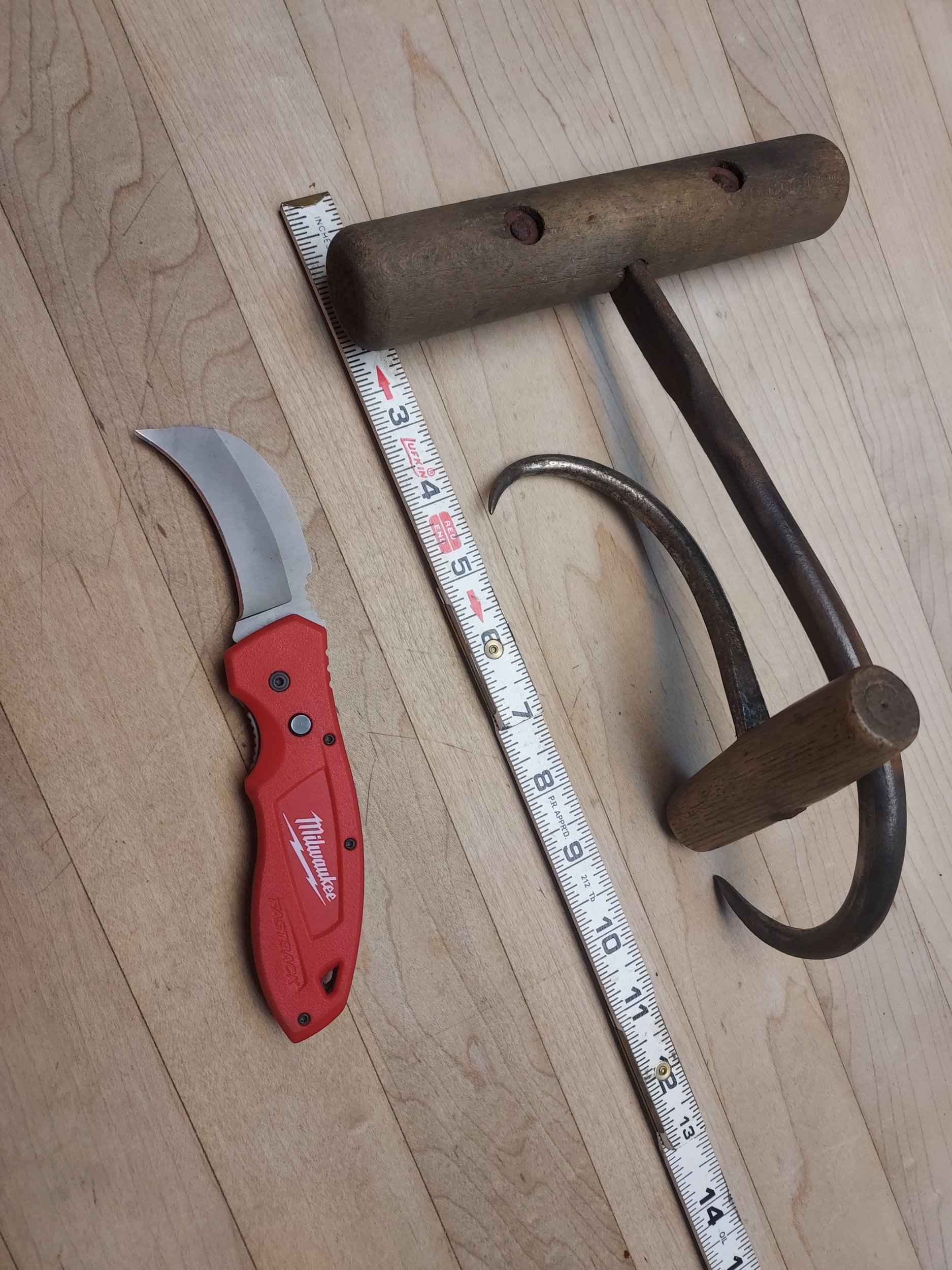

In addition to the parrot's beak (linoleum or pruning knives) I use longshoreman's hooks (bale, large or bag, small)
