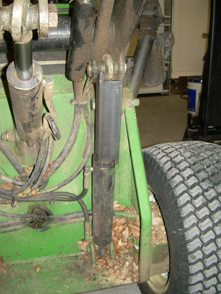

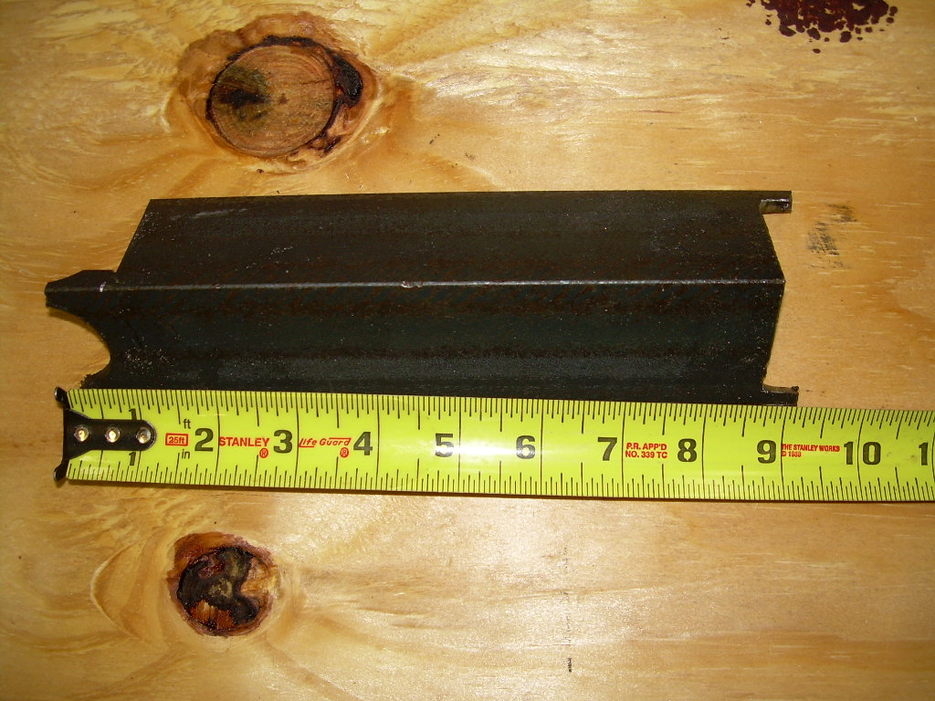

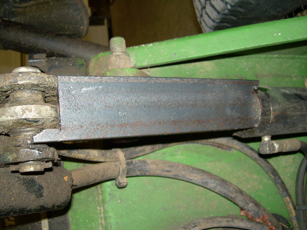

One of the members on here a long time ago mentioned that he was going to do something to the front of his pt with the loader arms raised and he put a stick under the arms to support it while he worked. The stick that he used he never tried out first to see if it would support the weight. When the weight of the loader arms and whatever he had attached to it settled down on the stick the stick broke. Lesson if you are going to prop the lift arms up for some reason to work on your machine make sure your blocking material will for sure hold the weight of the loader arms and that it can't slip out from under the arms while working on it.
   / Videos of New PT425 Arriving/Unloading #84
Attached are pictures of my "sticks".

Bob I remember seeing your system of blocking and I thought it was a good idea. The member that I am talking about never posted pictures I don't believe, instead his post was meant to be a warning to save one of us from making a similar mistake. Anyway I appreciate anyone that posts a warning of something that they have encountered that may cause harm to someone, even if I already knew proper blocking techniques it never hurts to bring something back to our attention before the need arises to do a project. Glade you got the winch figured out.

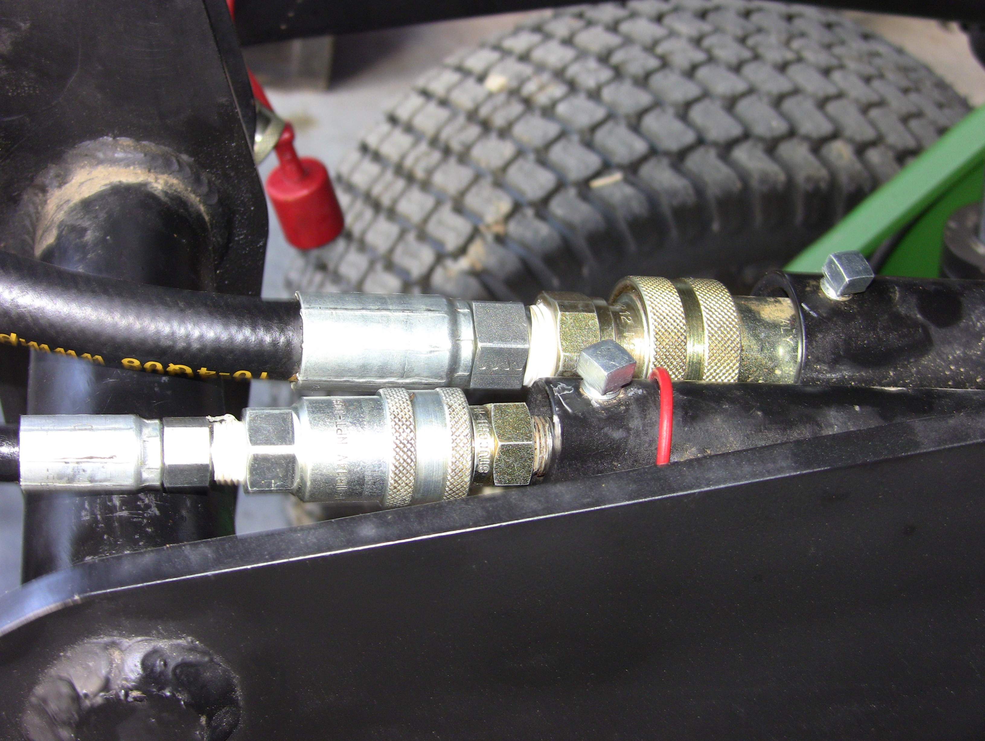

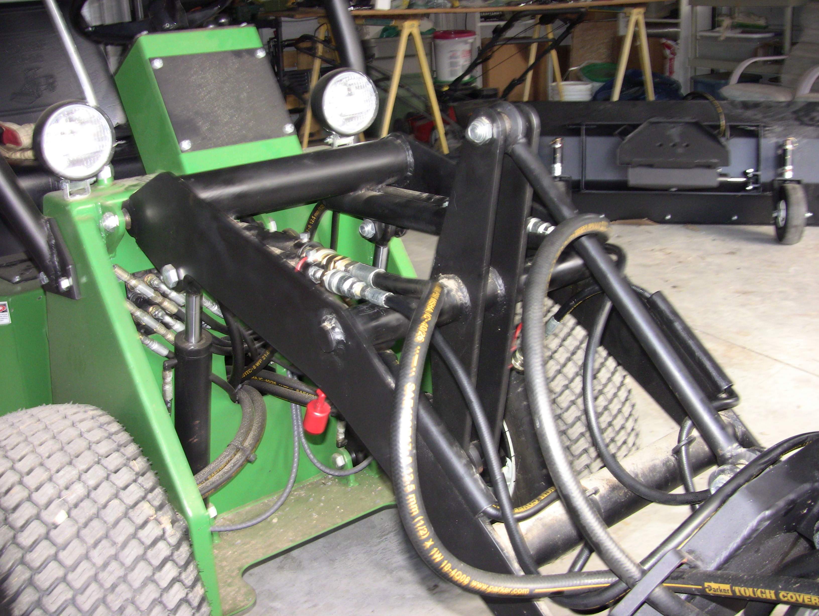

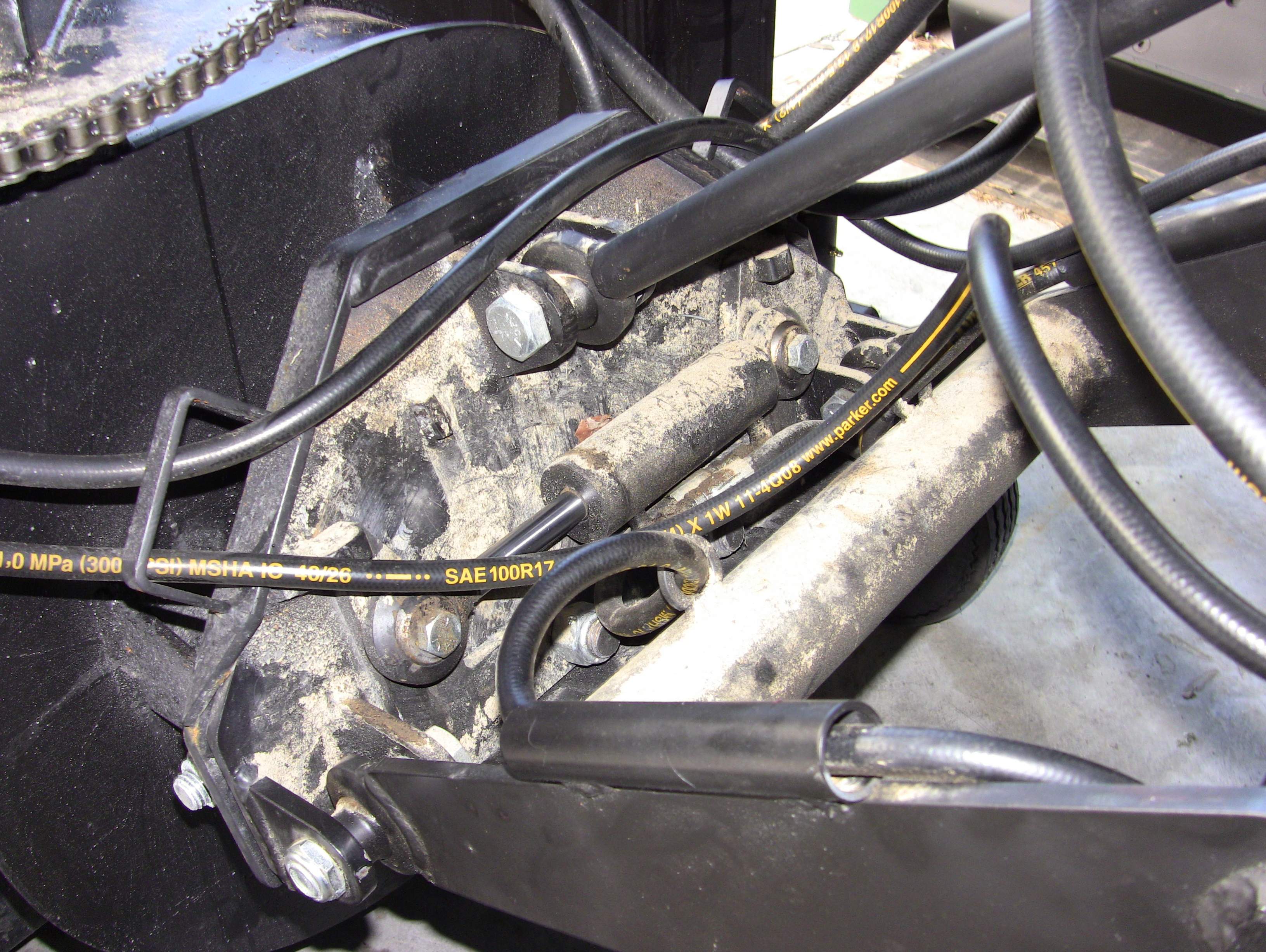

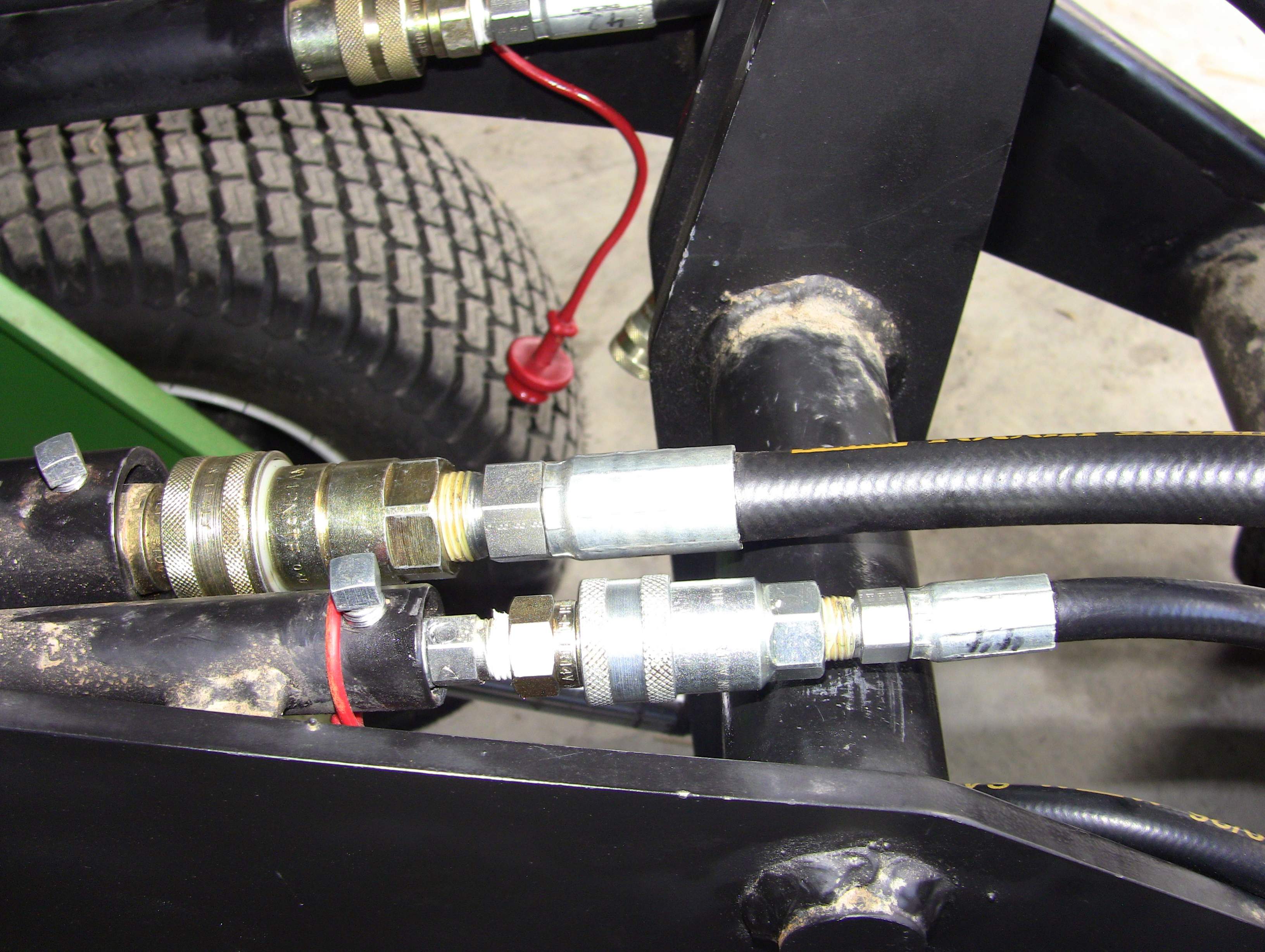

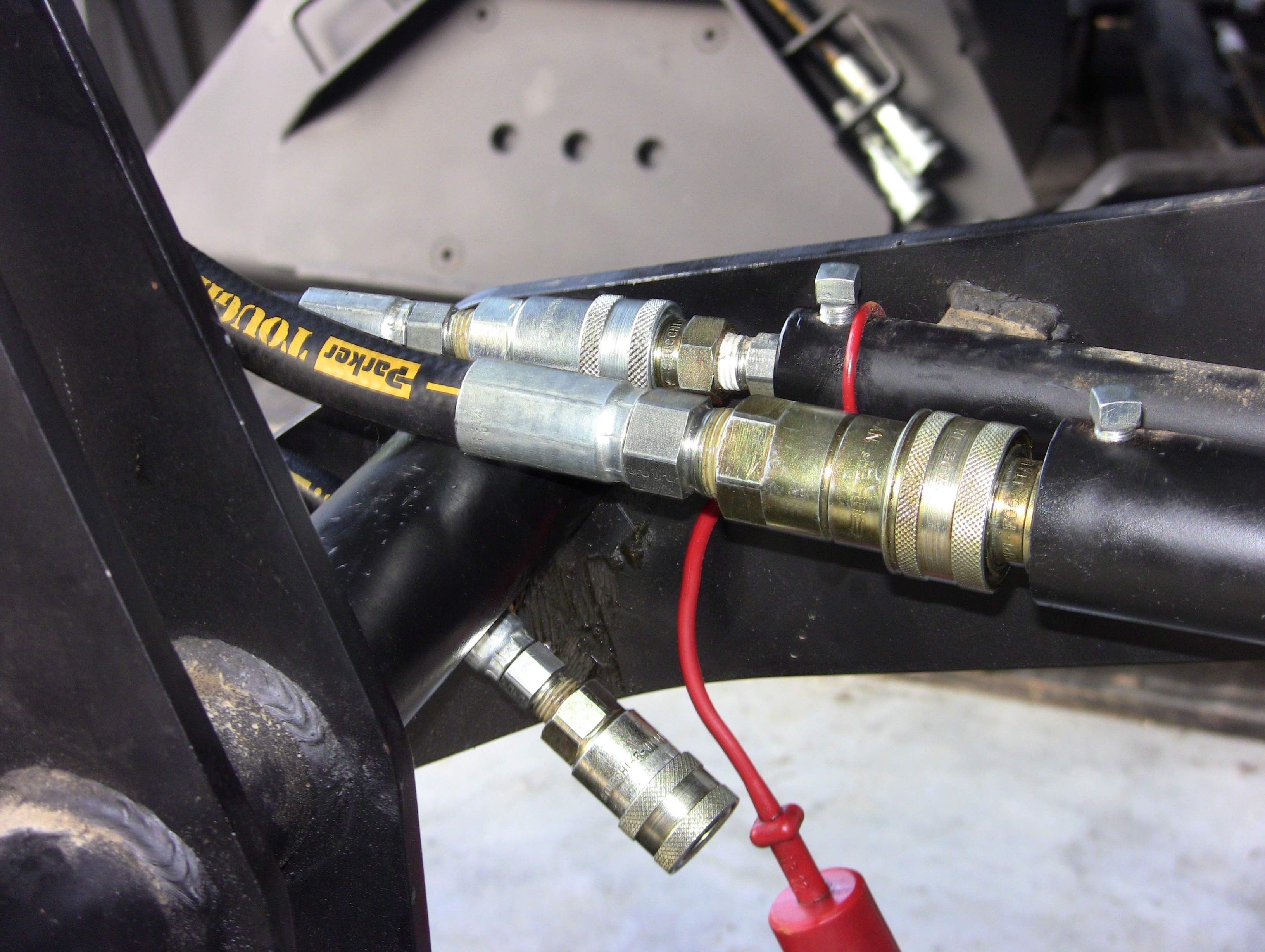

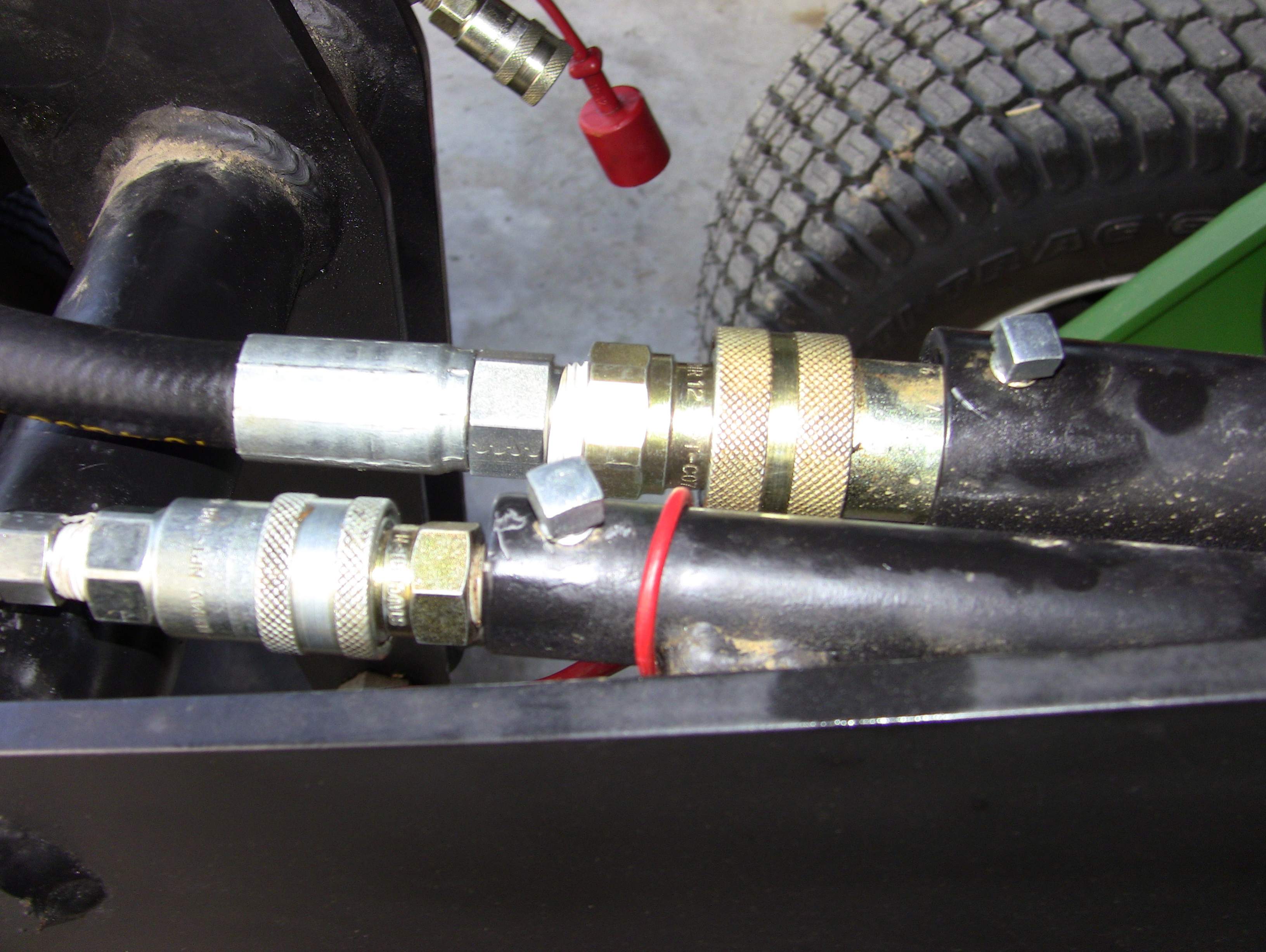

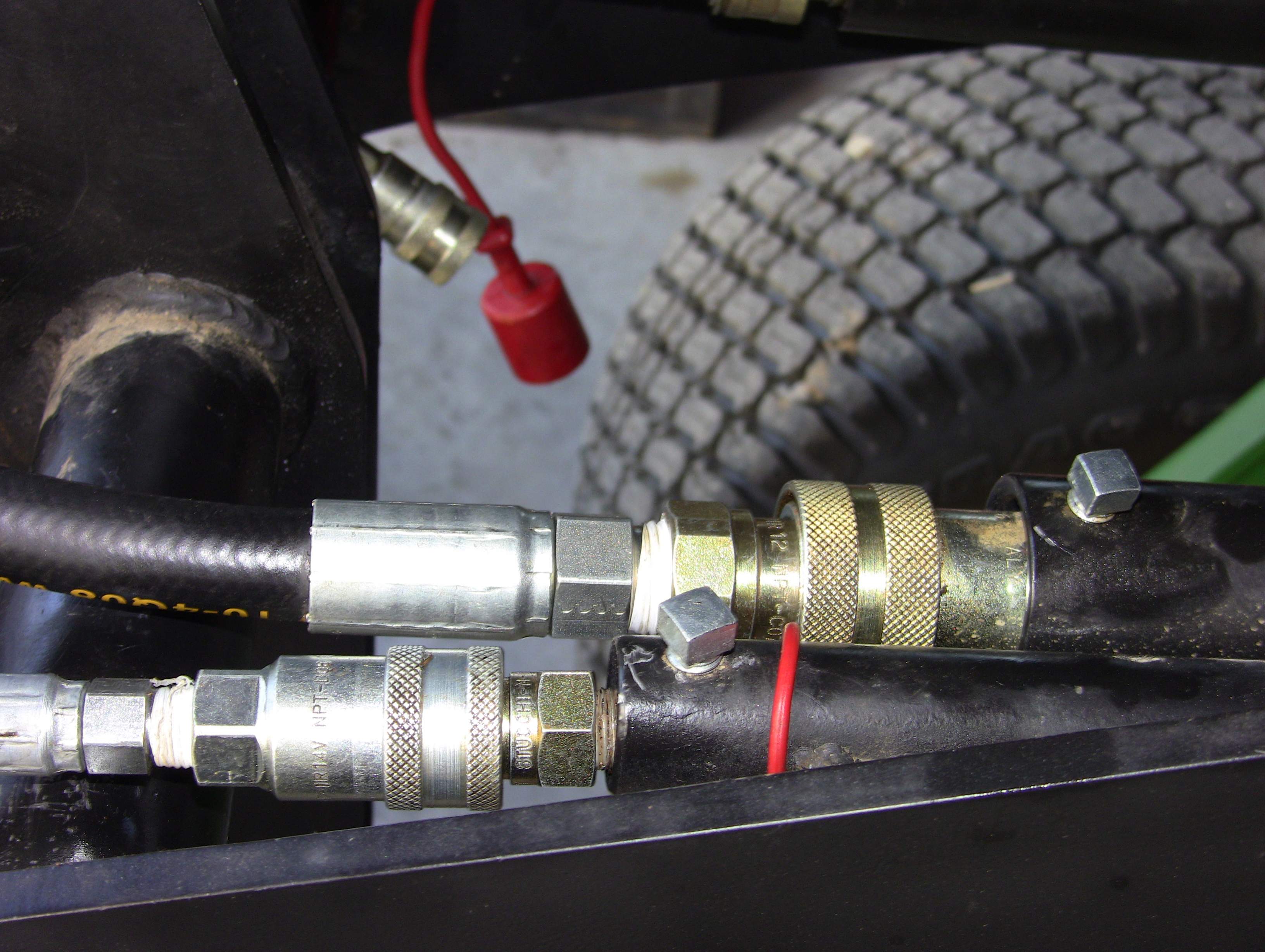

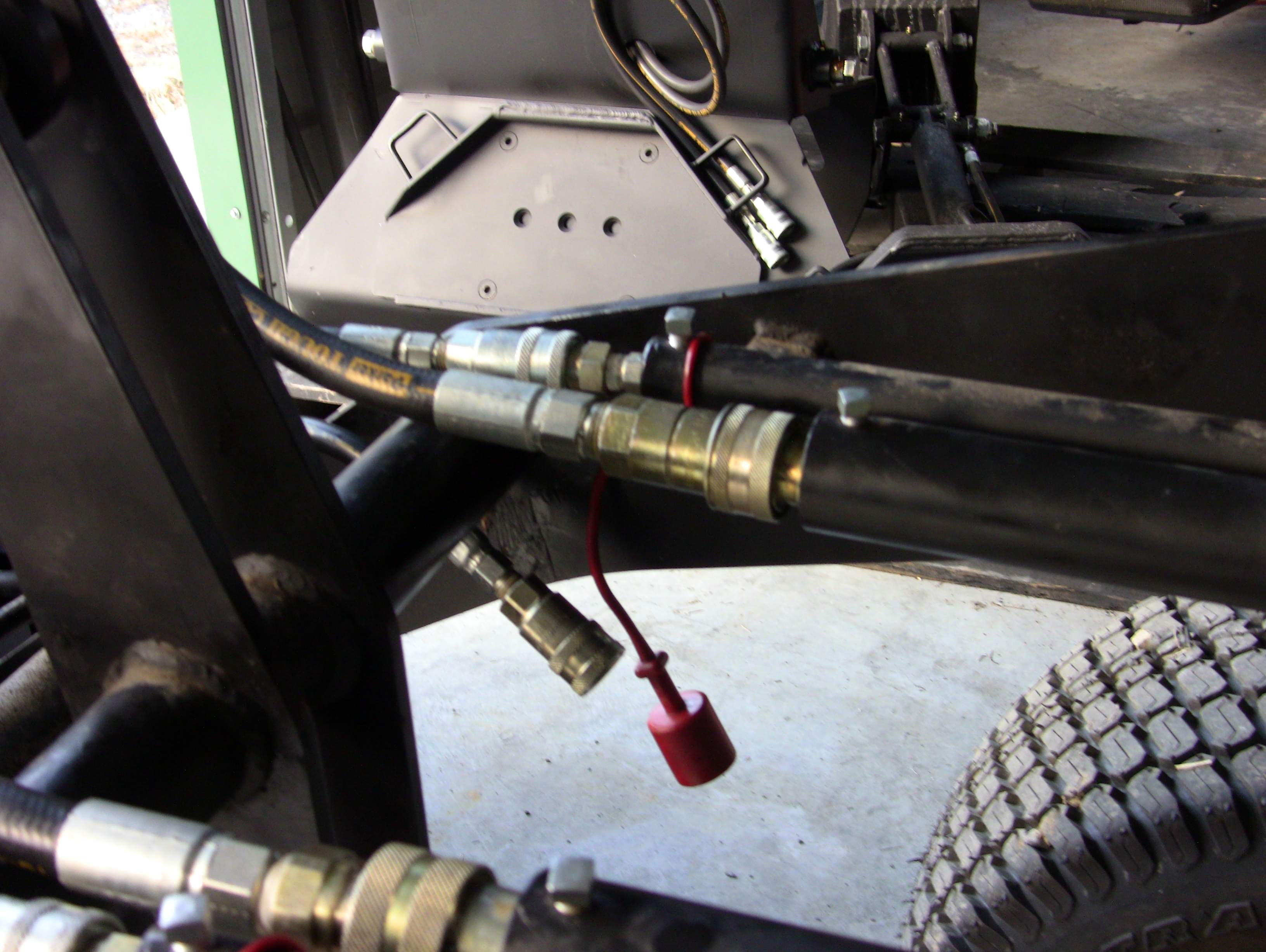

Folks, after a couple of hours blowing snow yesterday I decided to unattached the thrower and attach the sweeper. The 1/4 quick connectors came off easily. But I could not re-connect the QA coupler -- it just would not connect. My neighbor dropped by and he could not connect it either. We tried all the techniques discussed in the thread to no avail. To be brief, the next day we were finally able to connect it only by one person holding down the Aux handle while the other pushed the connector on. That is a new technique that I could never do by myself. Frustrating! I did try the tap tap method to relieve the pressure in the hoses. Cycling the Aux level did not seem to work.
Below are some photos of the couplers.

Hi Patrick,
I posted earlier about using a rubber hook strap or bungee cord to hold the lever up or down. That is what I have to do on mine every so often. I just store it wrapped around the ROPS. I also find that it works best for me to attach the "return" first then the supply. So looking at the PT from the front, I attach the right hand one first.
