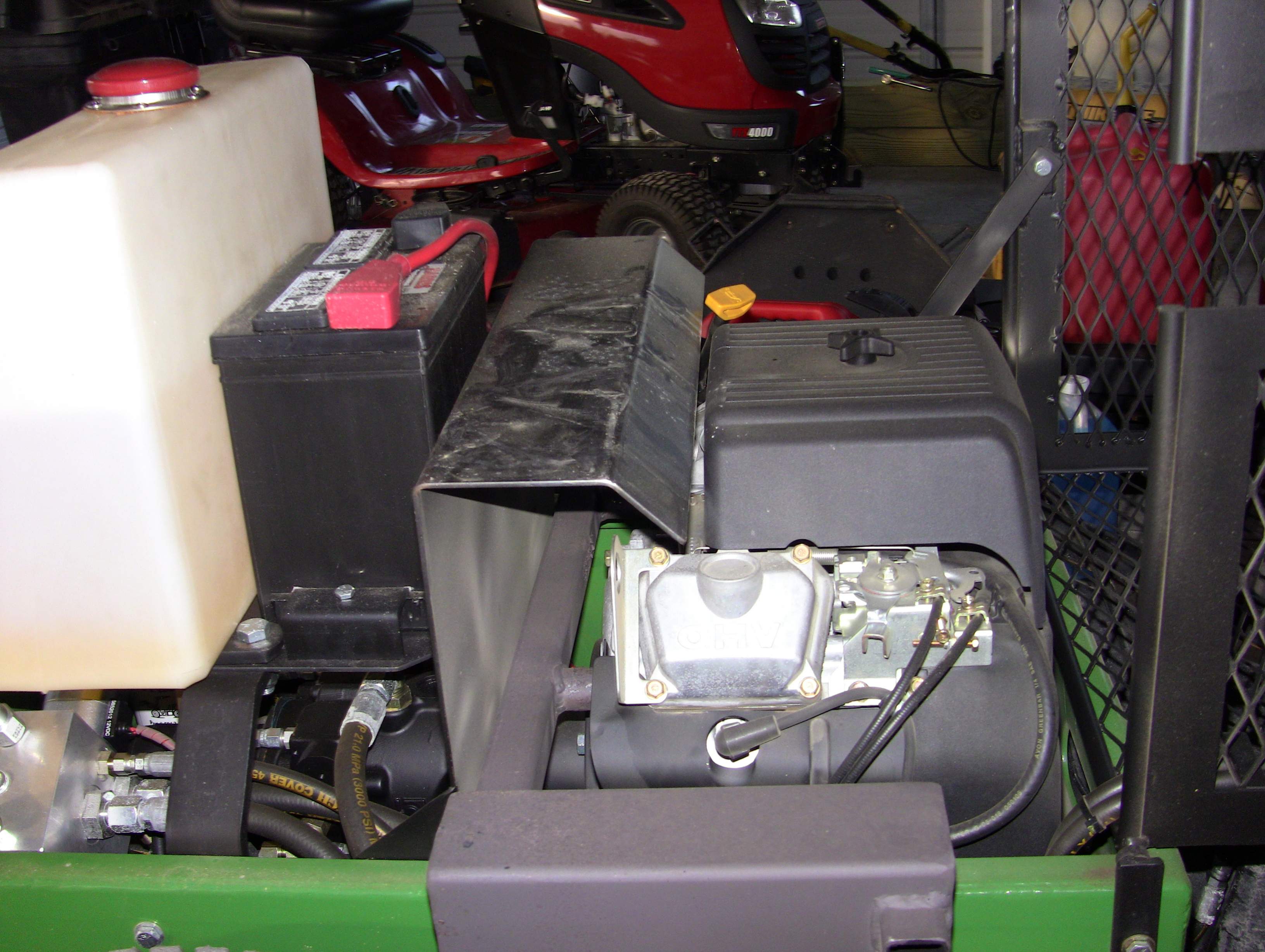

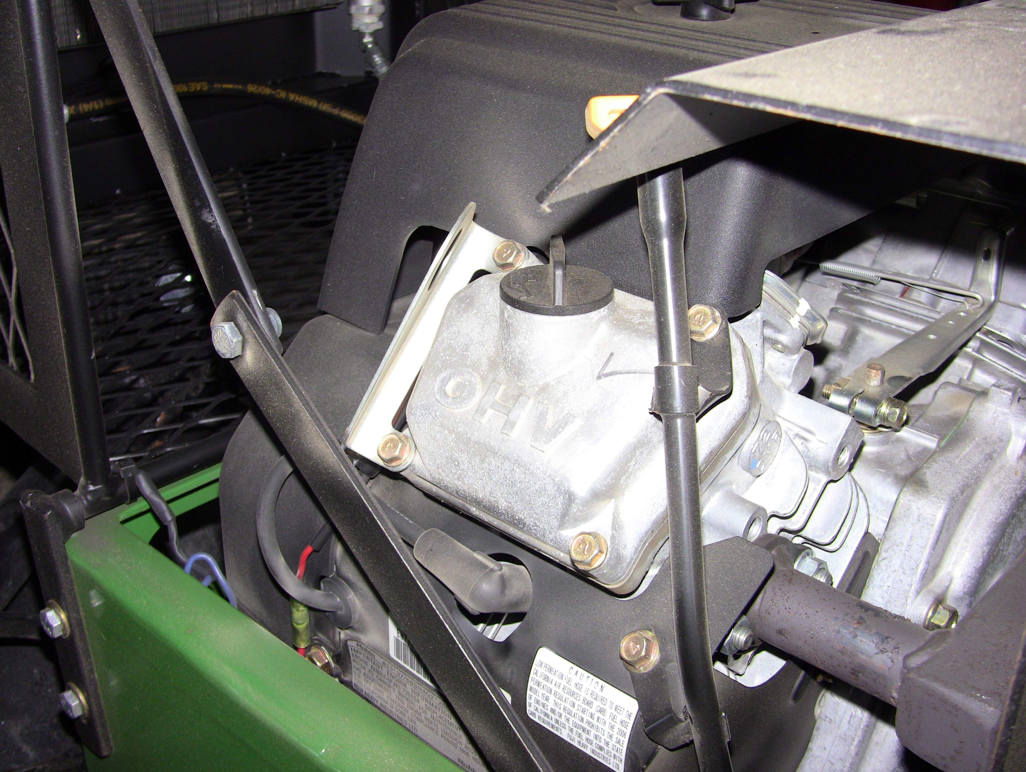

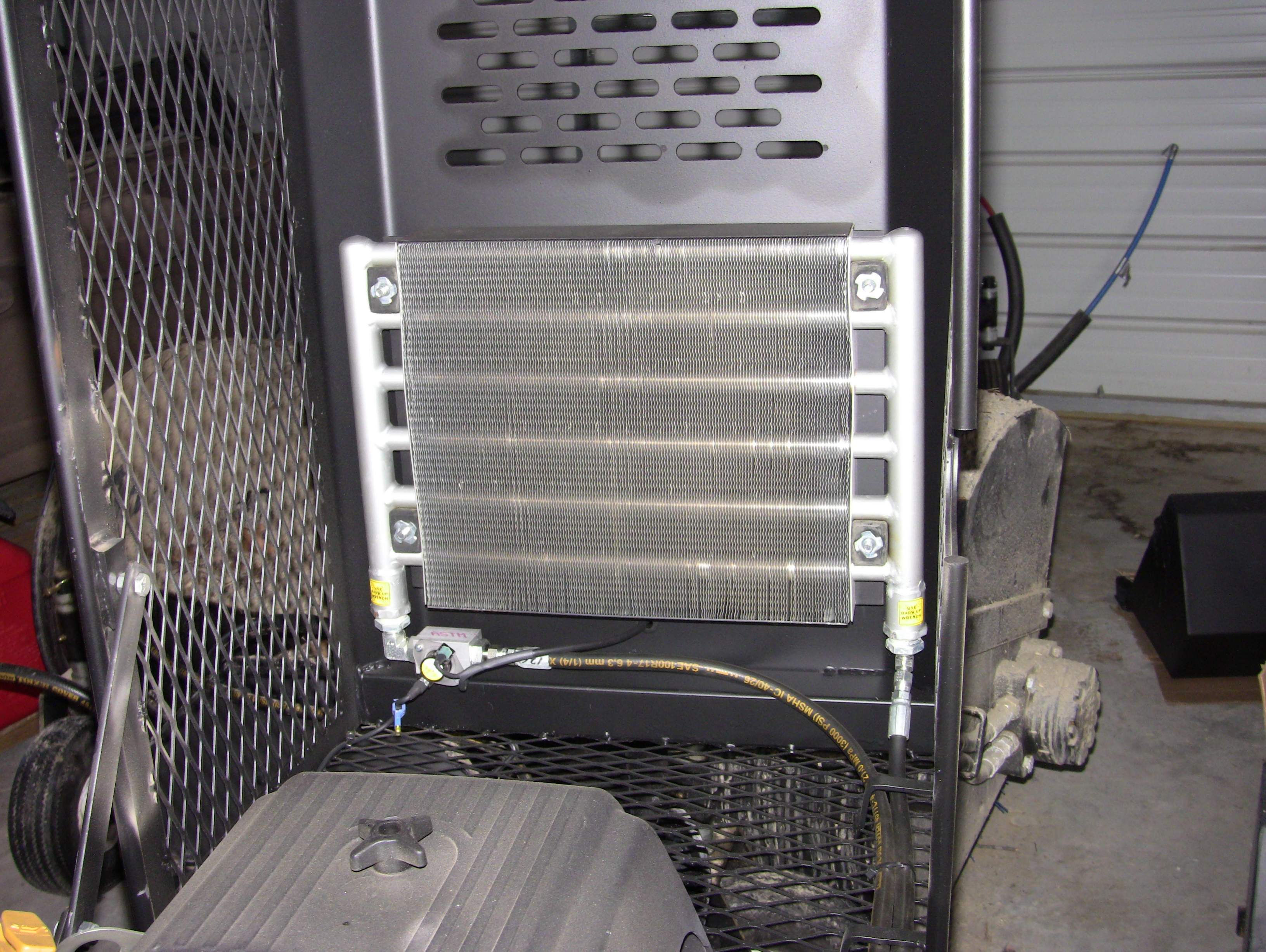

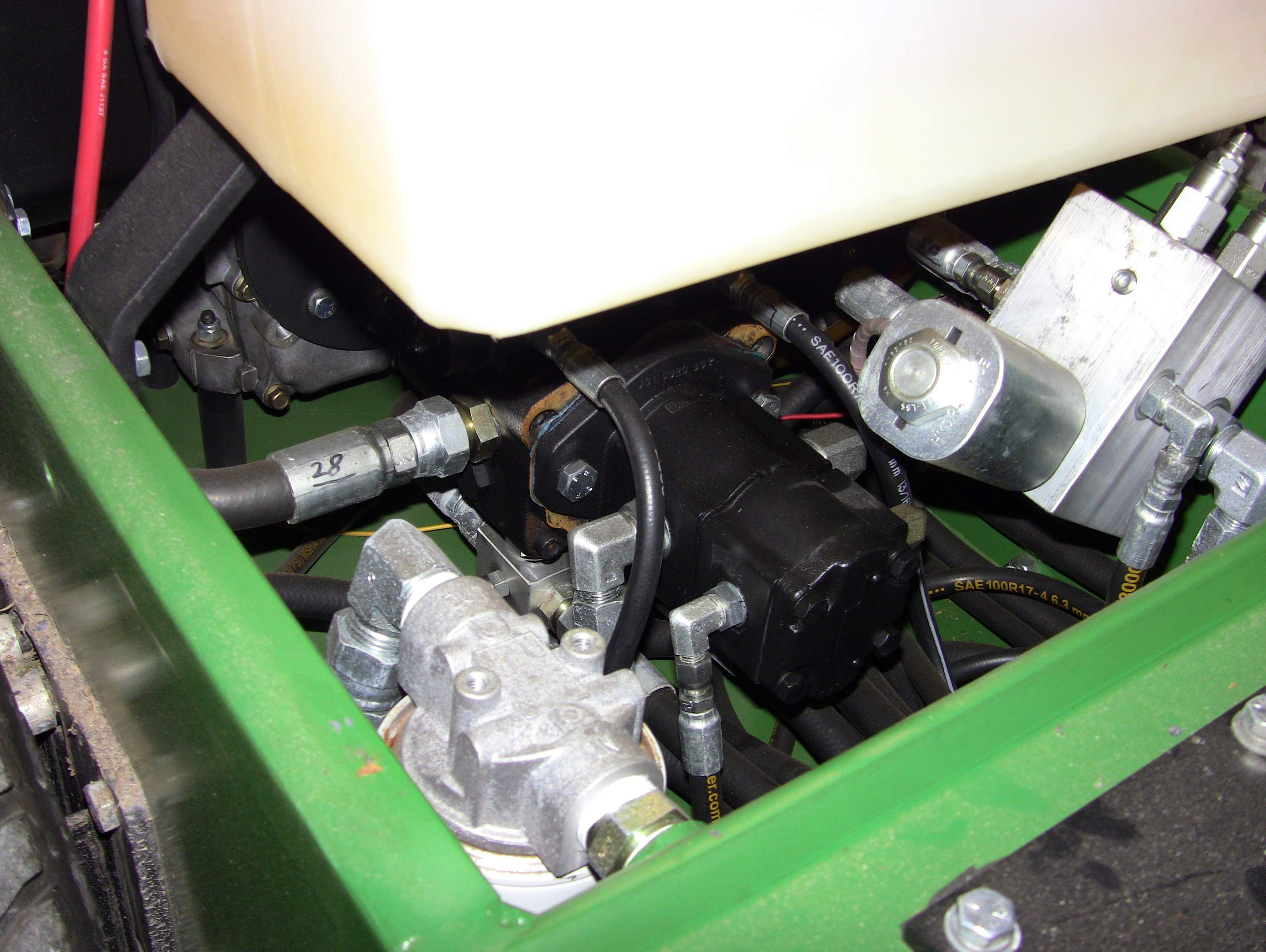

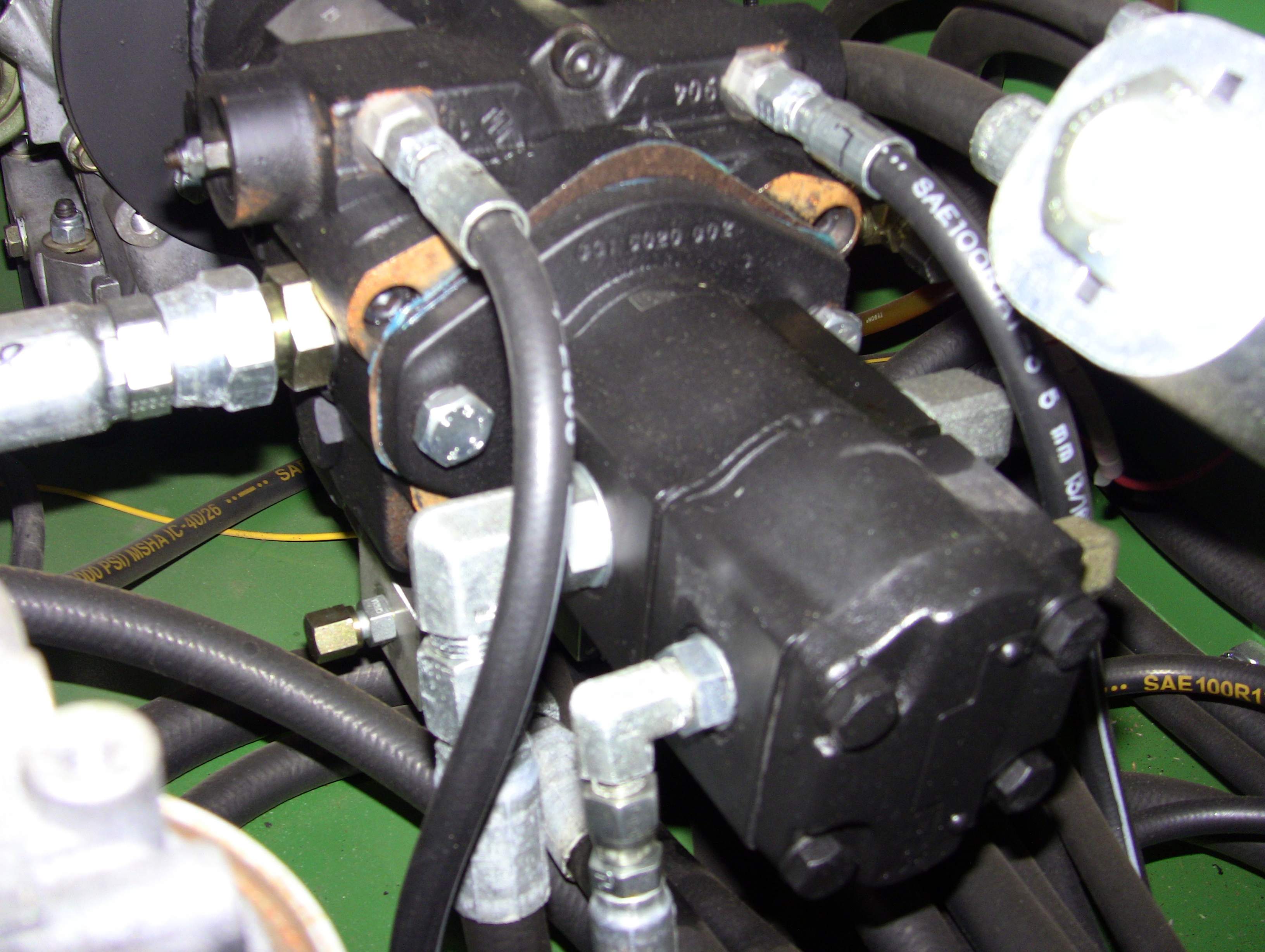

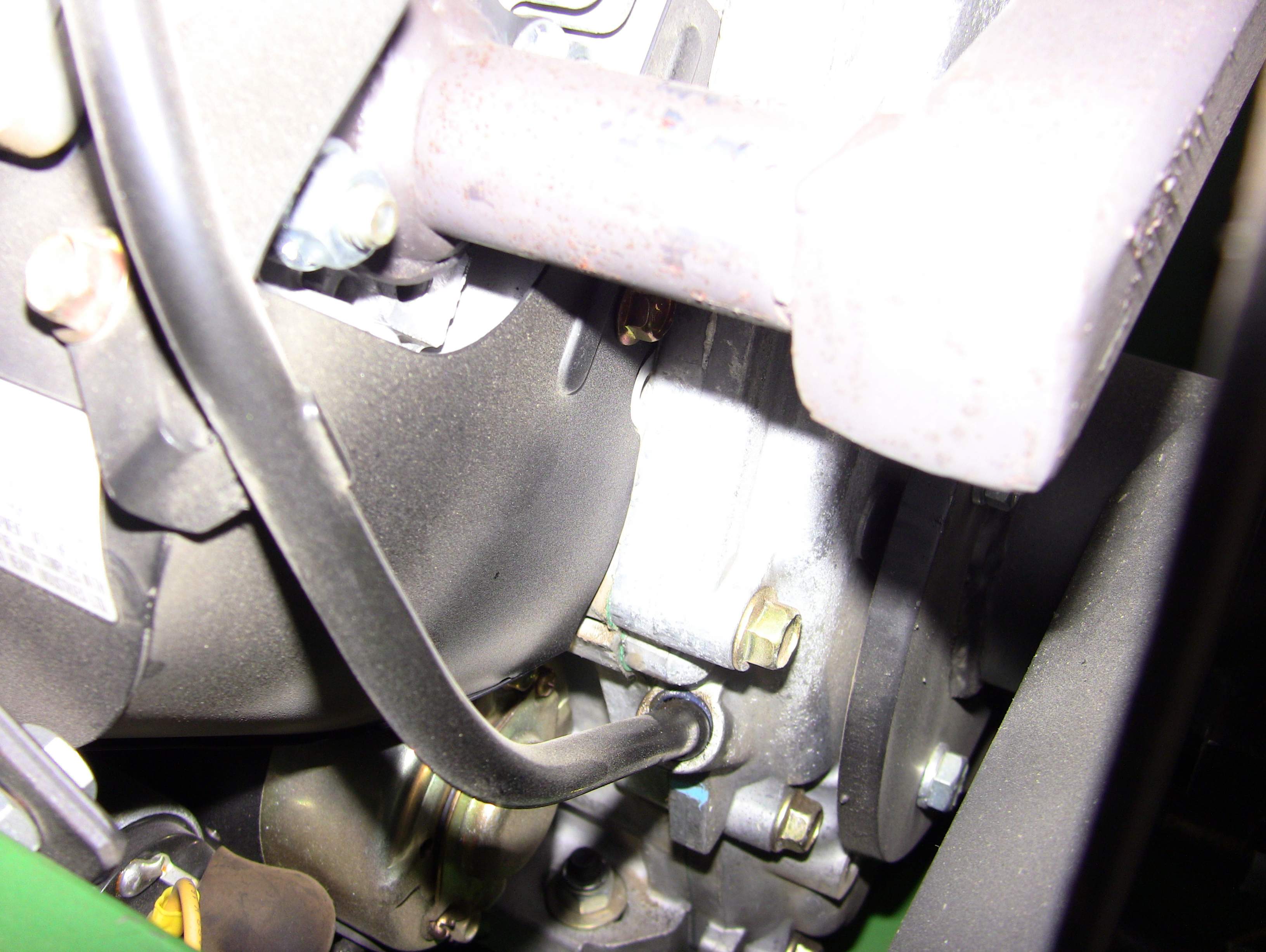

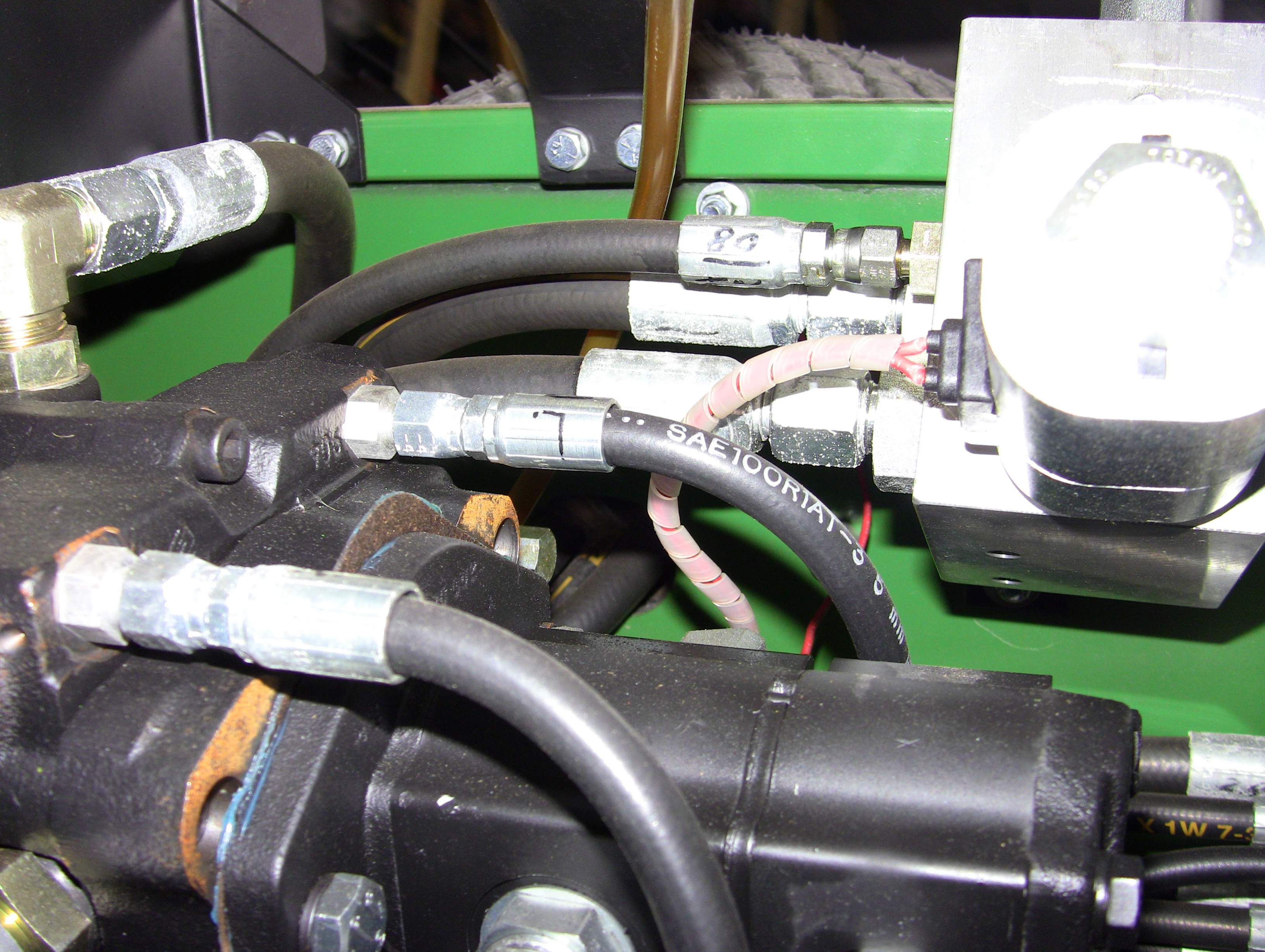

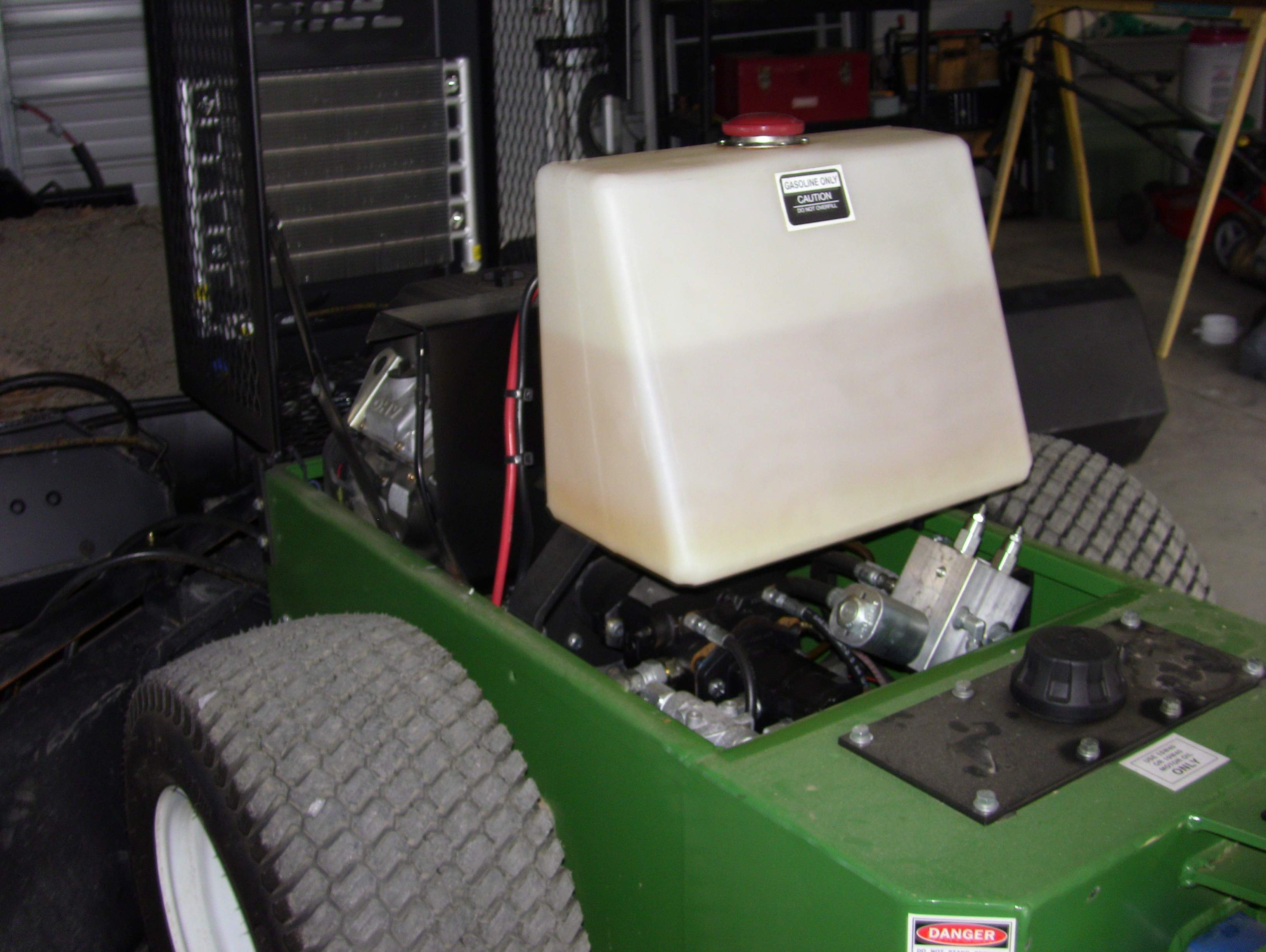

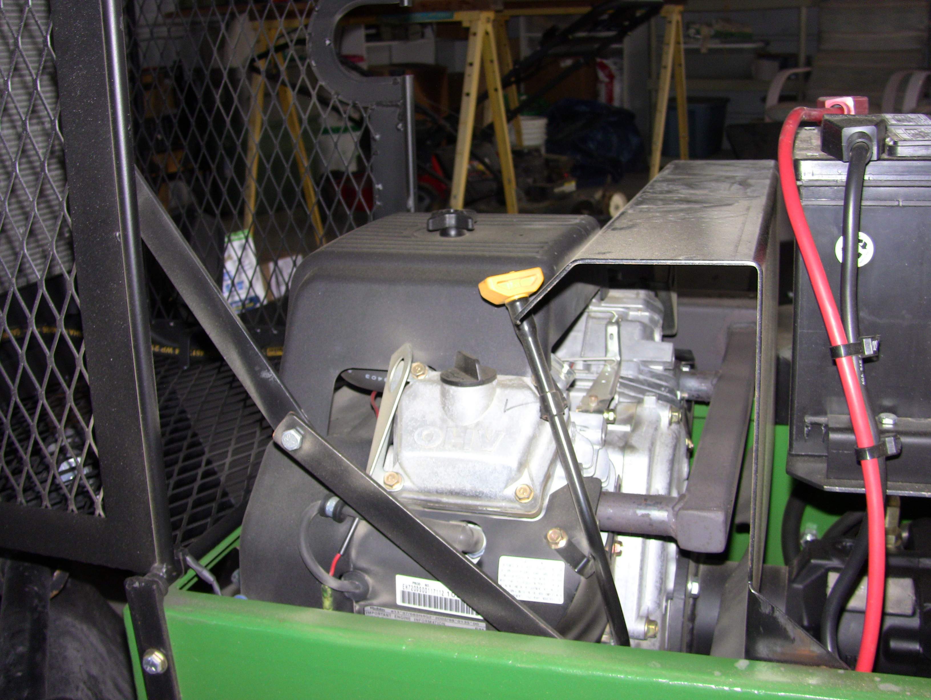

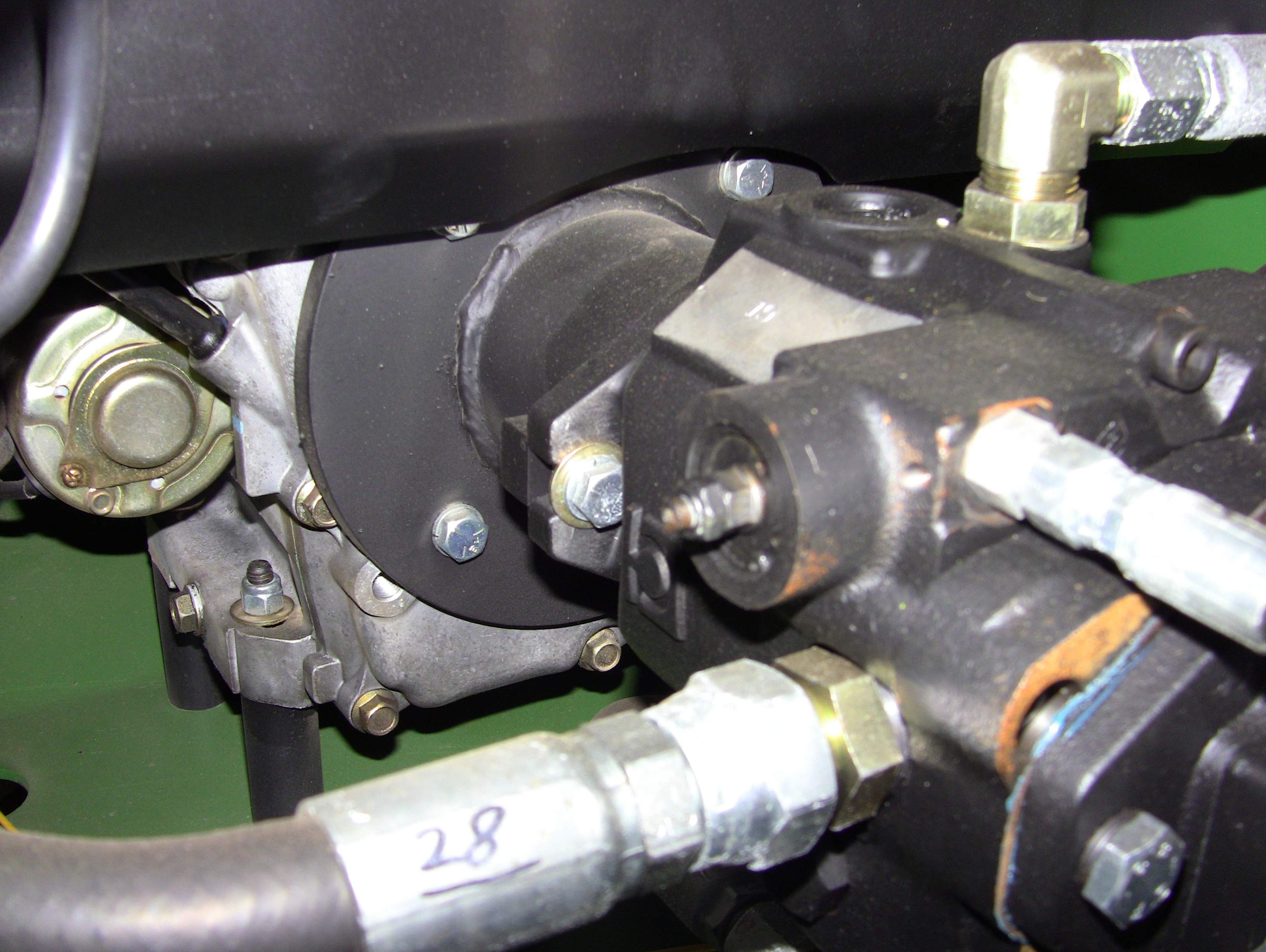

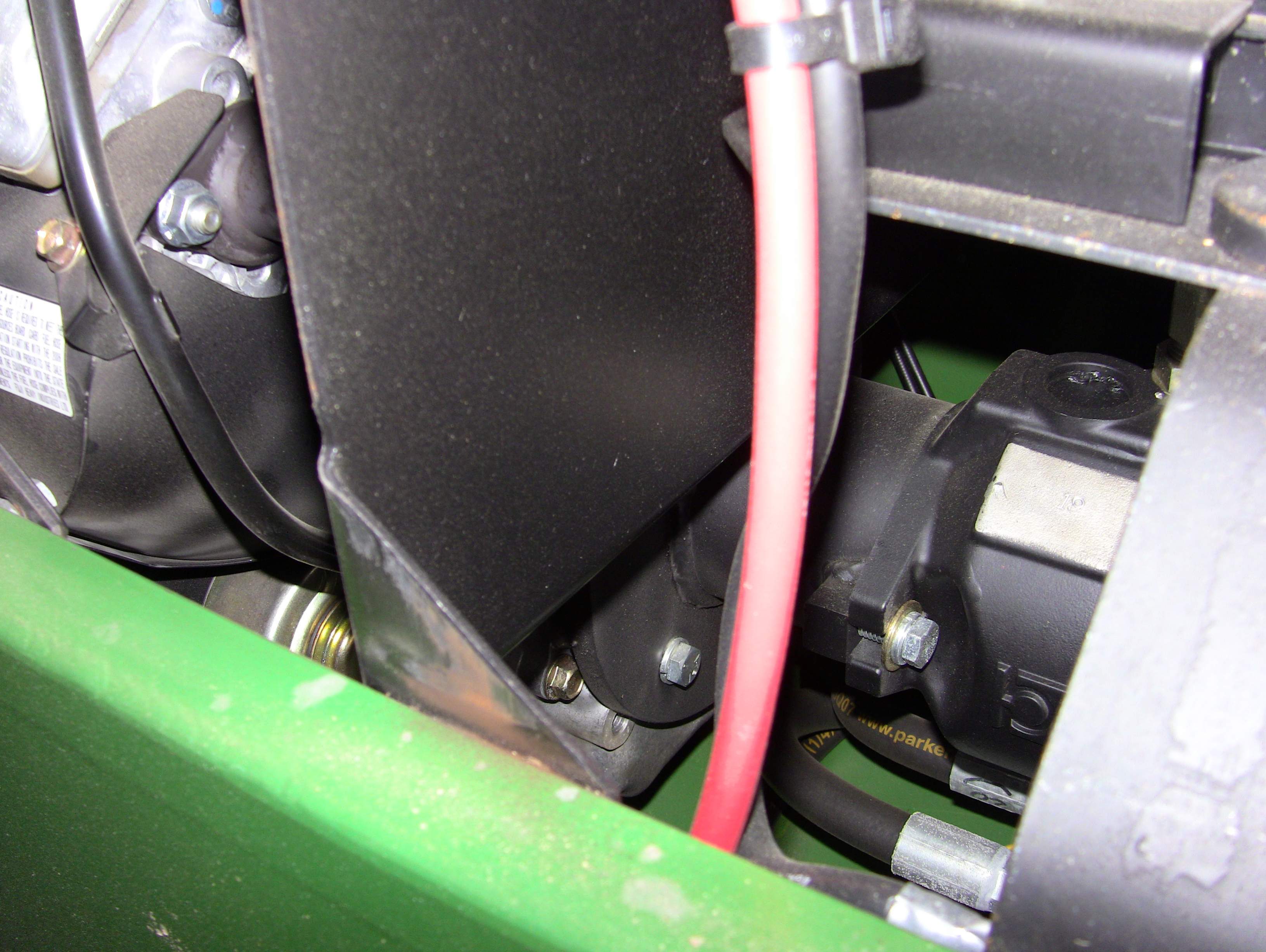

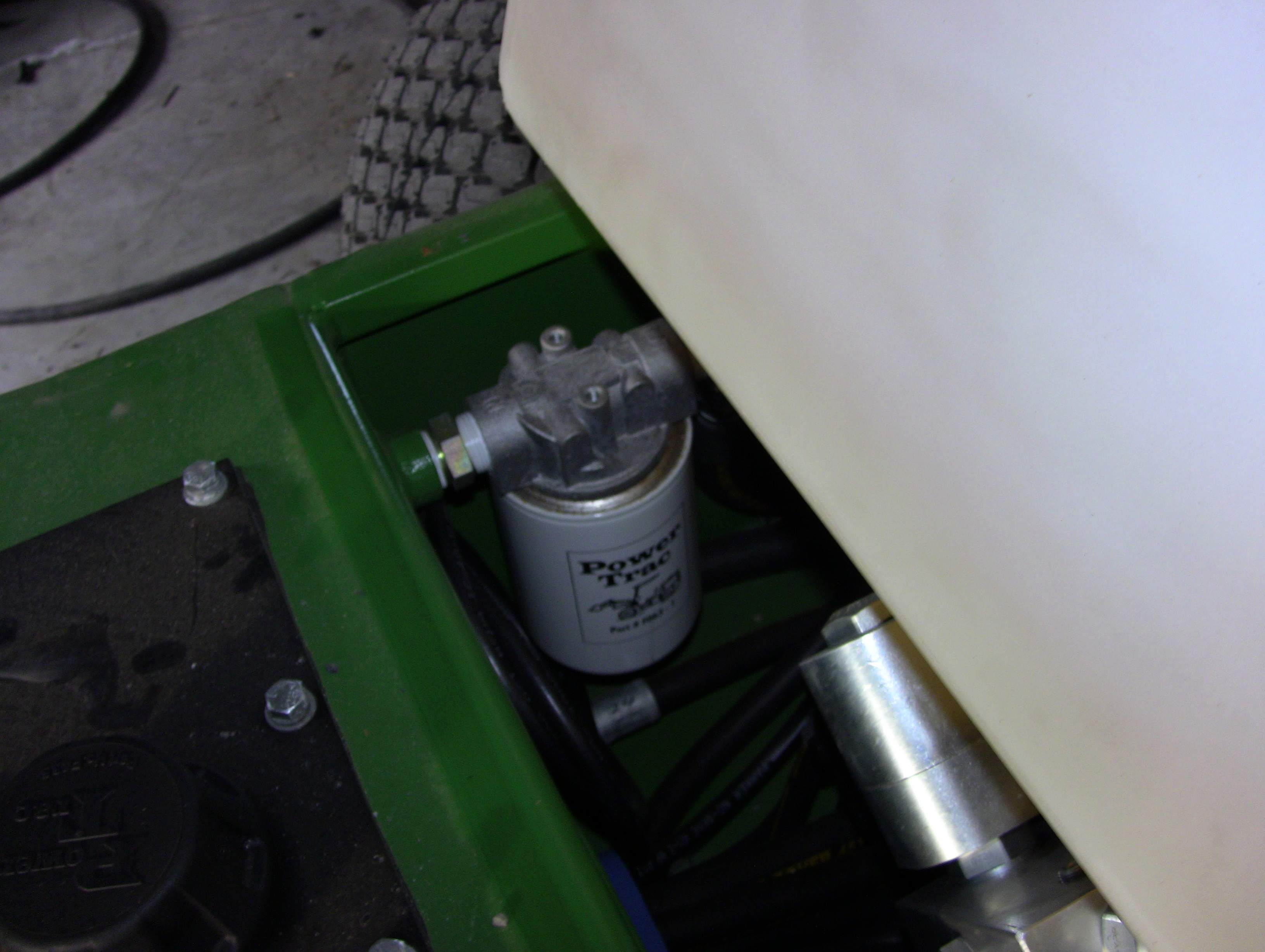

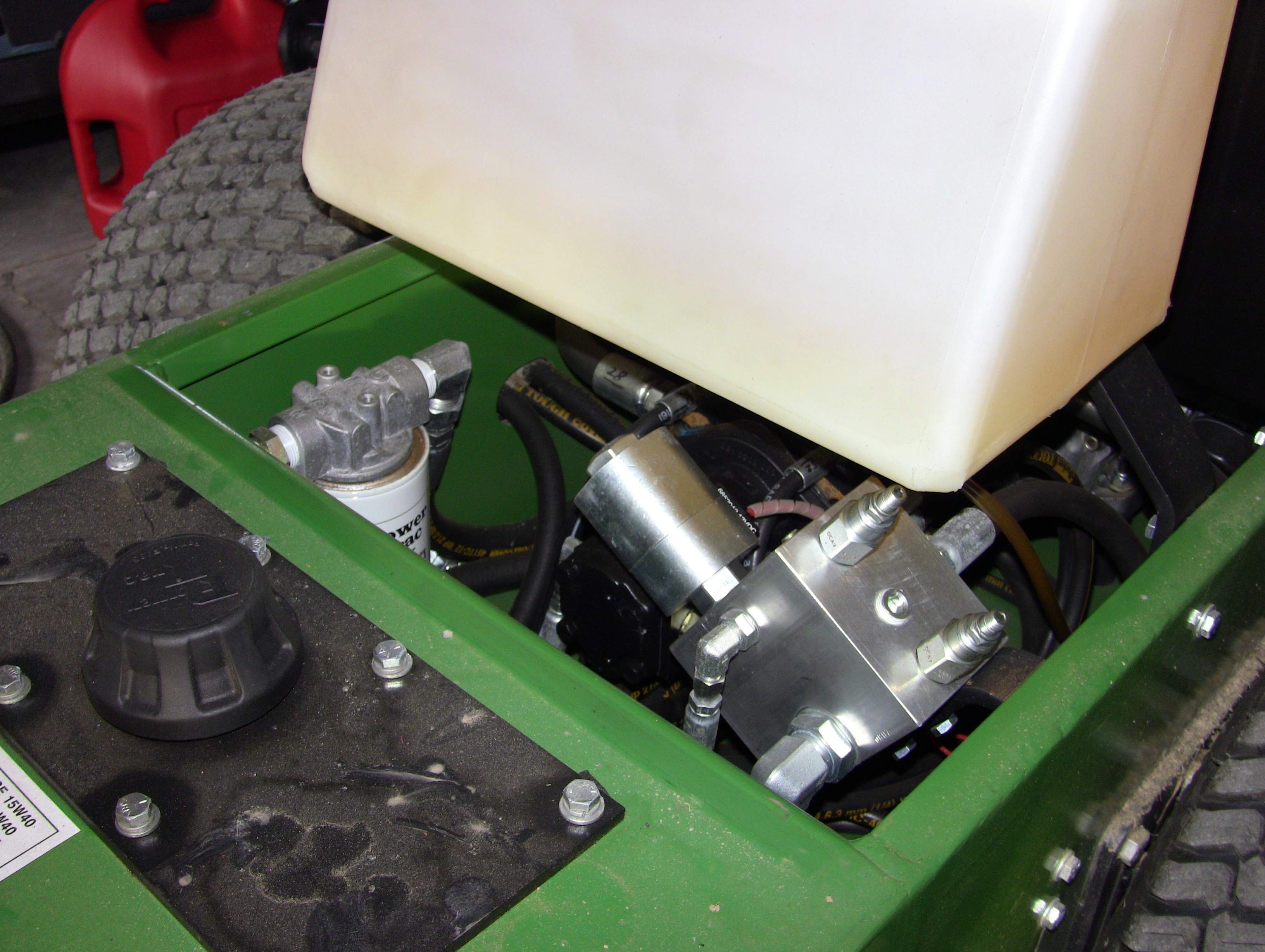

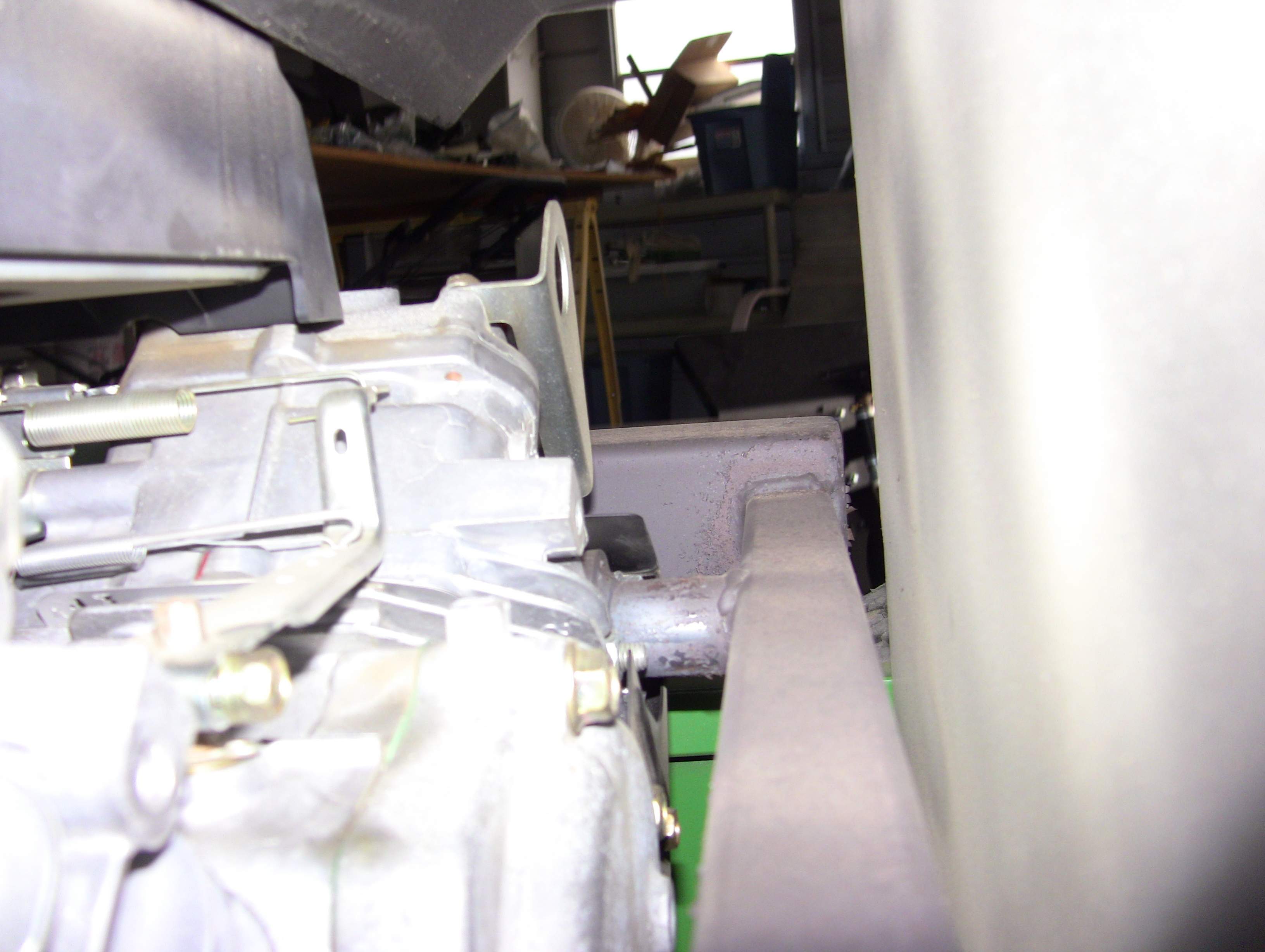

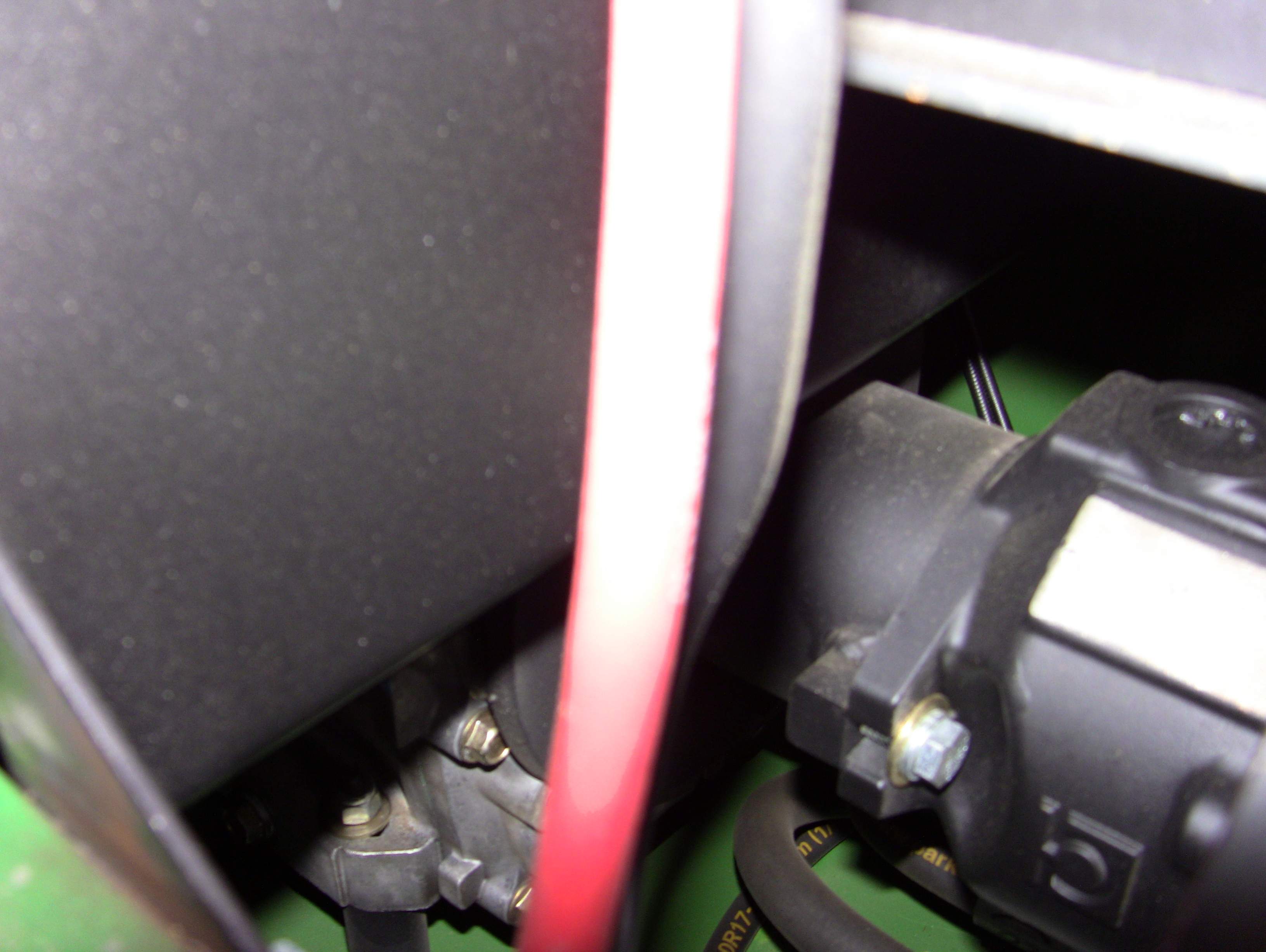

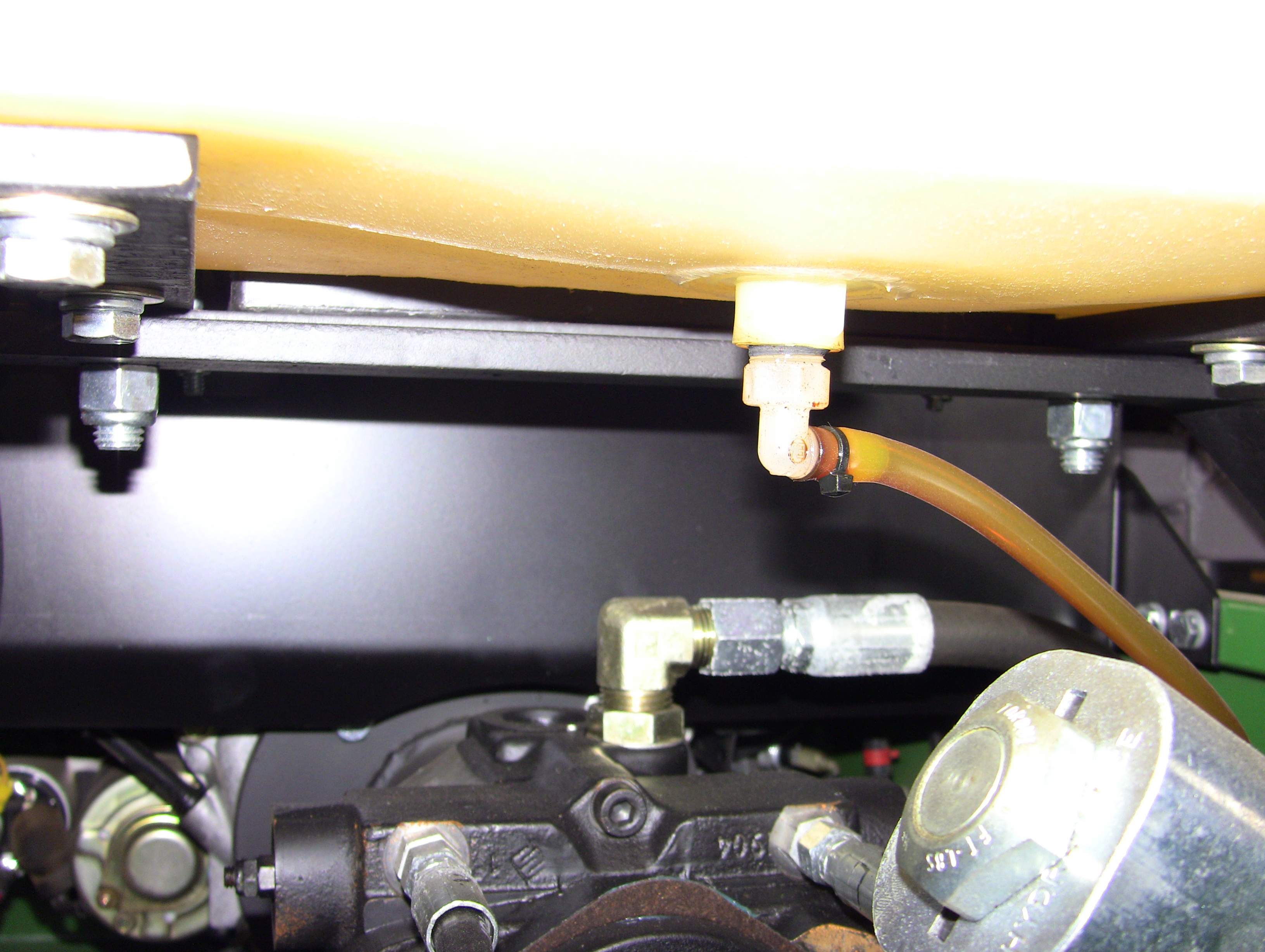

Here are some quick photos of the engine tub of tne new machine. I thought it might be interesting to compare with earlier 425s.
