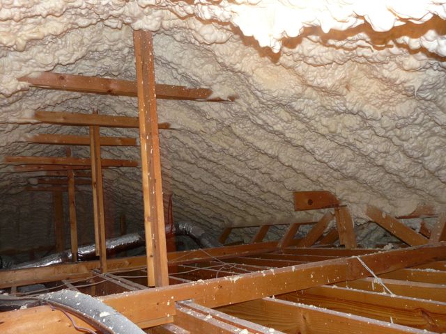

As you can tell from the pictures below I have about 5' of insulated attic space (30 ft. to TV) and I also have an outdoor junction box with a tube to run cable (50 ft.) to the living room mounted on the brick on the side of the house facing Austin. I have a metal roof, will that eliminate attic installation?
I was hoping to get a smaller antenna (3') and a S mount on the wall junction box, but I don't know if that is workable.
Thanks for you help, I have a lot of research to do.

/ VHF Gain Antenna #14
I don't think that trying to receive through the metal roof will work. I have a metal roof, but it's a shed roof and I'm pointing out through the wall, not through the metal. So it comes down to how your roof is set up and where the transmitters are.
Even though the 4 and 8 bay (or bow tie if you will) antennas are flat, they are directional and need to be pointed at the transmitter area. I think you'd have to try it and see. I'd try it with the big 8 bay antenna and some mount that will let you point the flat part toward the transmitter.
If it's close (some stations OK, some drop out), you could fashion a box for the amp and run both a coax and the 12V power for the amp in your conduit to overcome the cable loss. Of course you can try the amp out 1st and see if it helps (at a lot of bucks to buy the amp and "try" it).
In a sense with all this stuff, cable and satellite have "spoiled" us. We are used to environments where we just wire it up and it works. But with this off air stuff, there is some trial and error and none of the tries are free.

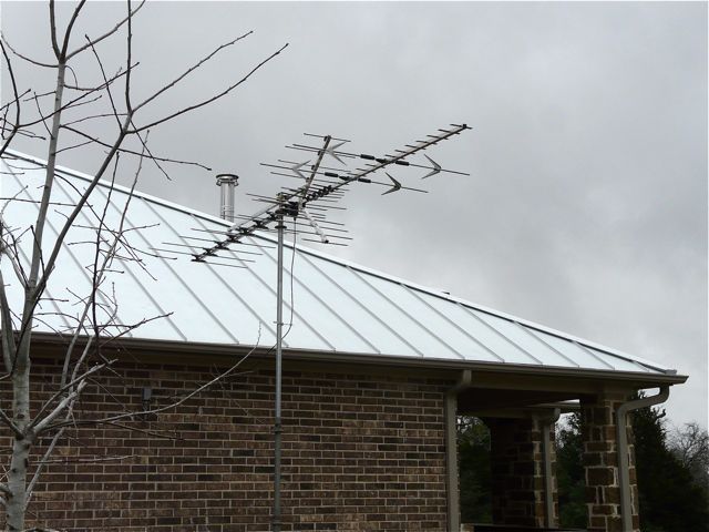

Thanks again to TBN for the guided antenna research. I chose the Winegard antenna.
Winegard Direct.com - Winegard HD 7698P High Definition VHF/UHF HD769 Series TV Antenna (HD7698P) | Winegard [HD7698P] HD769 Series 769 7-69 high band hi band hi-band HD7698 HD 7698P HD7698P HD-7698 HD-7698P
I now get VHF Fox7 and the other nine UHF Austin channels on HD at full signal strength!
I got the full signal when I first hooked up the antenna on the porch so a high elevation was not necessary. I mounted it at ten feet. I did not have a gable facing Austin (metal roof) so I had to mount it on a pole on the west side of the house.
The antenna was larger than I wanted at 14 ft. but at least I didn't waste any time or money going through small antennas like my neighbor did.
What surprised me the most was the variance in prices, and shipping charges.
Sears shipping charge was $175 ($304+tax) and Ritz Camera had no shipping charge for the same antenna for the same price $129.
