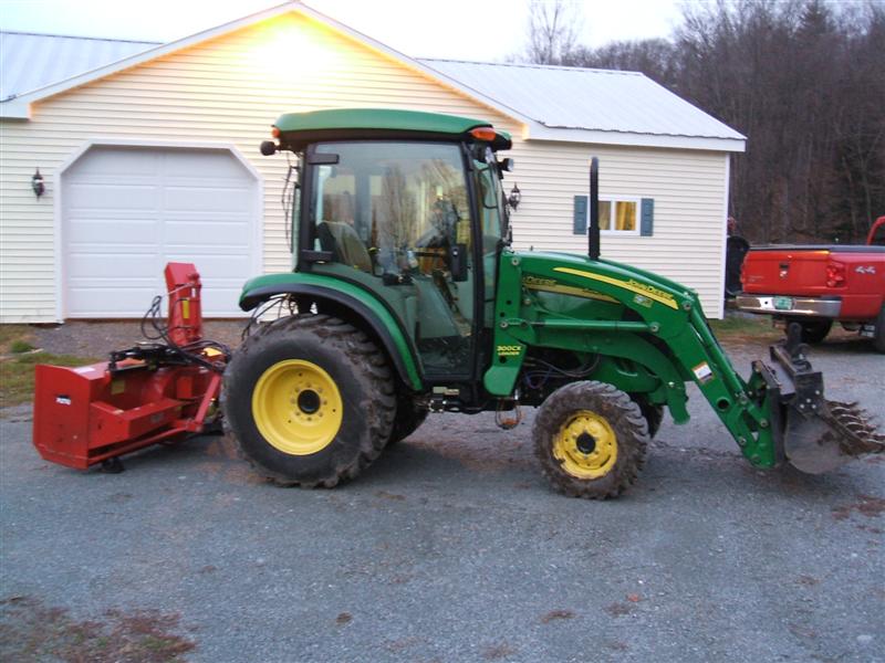

I bought the vertical exhaust when I purchased my 3520. It took a while for the kit to arrive so I told the dealer that I would install it myself. The dealer's shop people asked if I wanted them to drill the hole for me. They showed me where to drill but I had them do the work. If you look under the hood over the exhaust area you will see two circles molded into the hood. The holes overlap. The circles are the guides for drilling. Caution...note two circles. They said one set is for the 3X20 series and the other is for the 4X20 series. They must use the same hood. Go to your dealers and have them show you which is which before you dill. Once drilled you own the hole where ever it is and that is an expensive hood to replace.
However, once you are sure of the correct hole placement use a regular hole saw of the right diameter and drill away. The kit contains a rubber gasket to cover the edge of the hole. After that there is one bolt on the bottom pipe to remove and the u-joint to back off to remove the pipe. The kit also contains a new u-joint for some reason. Once the pipe is installed and the hood is closed the top piece drops down through the hole onto the pipe stub. The pipe stub is cone shaped and the top pipe is very secure.
You can point it in four directions. Ahead, back, left or right. I really like the vertical exhaust. The loader stays clean and it seems to me that there is a little less noise. (That could just be me telling myself that, but it makes me happy to belive that :D :D )
I attached a picture of my tractor with the vertical exhaust kit installed.
Al

The top piece simply sits down over the bottom piece. The bottom piece is tapered and has a indexing tab on it. The top piece has four slots at 90 degrees that go down over the tab. These slots give the four positions the top pipe can be directed to. Straight forward, left, right or straight back. Since it sits on this cone shape bottom pipe it does not need clamps. It just lifts off when you want to open the hood. And you just drop it back on the cone after you close the hood.

Chris,on my 3520 top piece of the exhaust pipe itself is 29 inches. When on the tractor it is 27-1/2 inches above the hood. Ground to top of exhaust when installed is 76 inches.I have the smaller R-4's. Your tire size and type will make some difference. Hope that helps. I know what your saying about forgeting to take it off before pulling into the garage.
