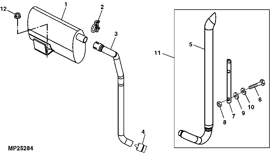

Thanks for the pictures, I went out to the barn to look at mine (4310) and there are no markings on the underside of the hood like your pictures show.
Maybe mine can't be switched over.
   / Vertical Exhaust on a 4520..?? #12
Sure it can, Kit # LVB25106
See picture below from JDParts.
   / Vertical Exhaust on a 4520..?? #13
Hi kennyd: It looks like the exhaust exits out the side panel on the 4310. I have been considering putting a vertical straight pipe on my 4300 but it would have to exit via the side panel or I wouldn't be able to raise the hood.

Not 100% sure on the 43xx machines, but the newer ones for the 3x20 series that exit through the hood the "stack" just lift's off to allow the hood to open.
   / Vertical Exhaust on a 4520..?? #15
Yep. The 4x20 is the same as 3x20, ie, up thru the top of the hood, but the hole position to drill is slightly different between the two as marked on the underside of the hood.

Just curious to know if anyone has vertical exhaust on their 4x20 series tractors. Just got my 4520 delivered and I normally like the smell of diesel exhaust but after a couple of hours in the seat my eyes say they have had enough of the fumes. Wonder if vertical exhaust would solve the problem? If anyone has vert. exhaust did your tractor come that way or did you retro-fit it?
Thank you and have a great evening!
Jim
The diesel fume problem is history, just finished installing the vertical exhaust kit then used it for a couple of hours moving mulch. Fume problem is non- existant. Does anyone know why JD would not run the exhaust out the rear of the tractor?
