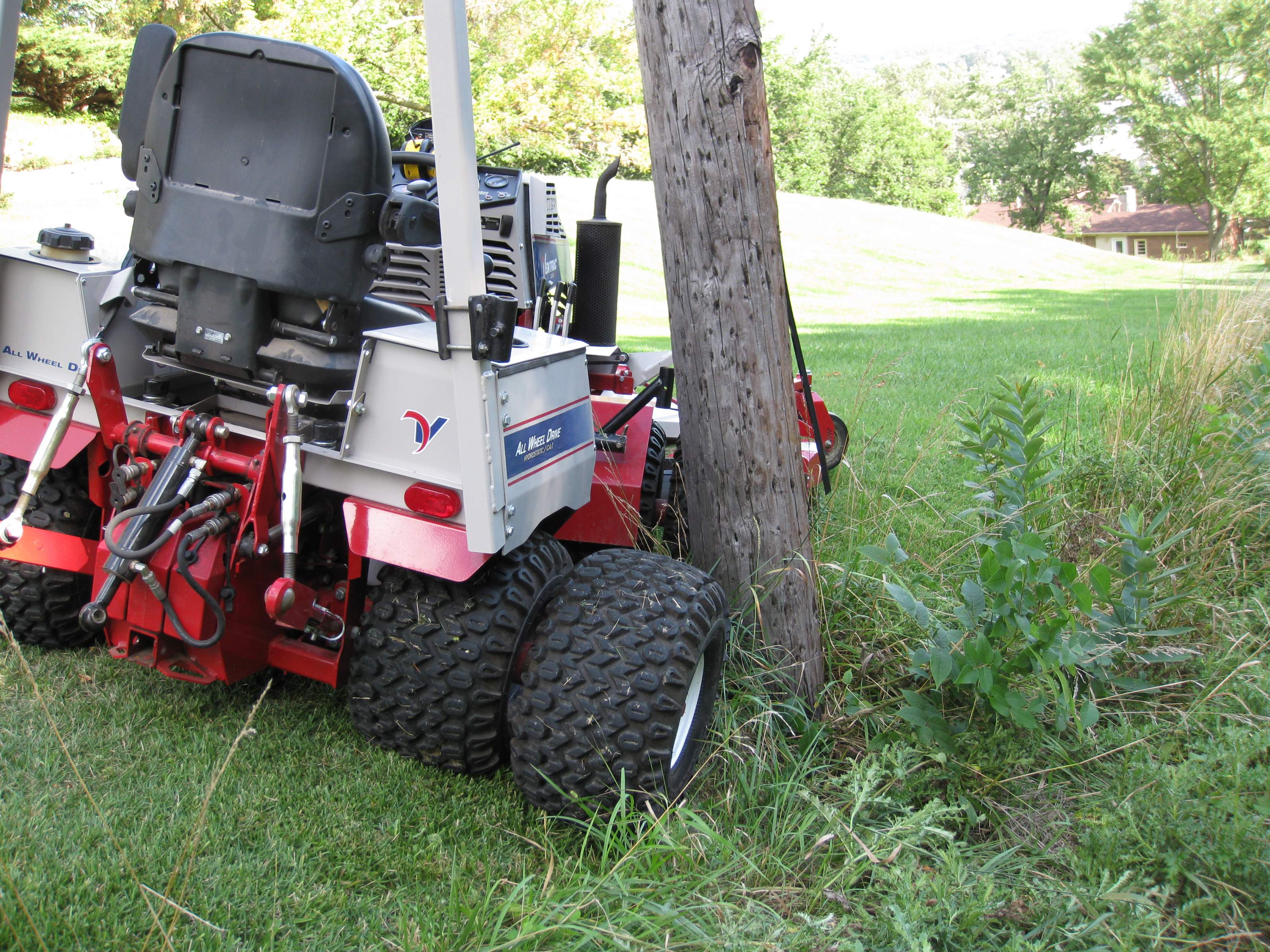

If you pick it up by pushing down on the attachment then articulate it away then set it down and keep doing it till you are free. don't try to use the travel at the same time. Jim

So when my wife wrapped it around the corner post of a newly installed high tension fence, the machine only had 5 hours on it. I was too paranoid to pull the machine laterally (only because I have terrible luck and figured I would end up damaging the unit somehow someway). So....I cut the corner post off with a chainsaw and drove the Ventrac off. Eh, $15 corner post and an hour of work later, everything was back to normal.
I chalked it up to a great $15 lesson to learn - don't articulate against gravity and a tight spot.
Wish I had learned in just one lesson.

I can tell you guys never run equipment ....... I know the hydraulics are kind of anemic but it will still work. I guess if you had a 992 that slid in against you would cut the tree down ? you walk it away with the articulation ...... Jim

Not sure I get this. If you are on the side of a hill and you push down on a mower as soon as the tractor front wheels lift off the ground the mower guide wheels pivot and turn into casters and the tractor slides further down the hill. How do you keep the front guide wheels from pivoting? Thanks.

I don't get how you get hung up on a tree or pole either 28 years now of running steiners and Ventrac and never once did that, I still don't know what the issue is , just lack of seat time is my guess.

I will try again for the last time. Do not try to travel........ pick it up with the hydraulic. and articulate the center pin away from the problem, then set it down pickup the implement and articulate the other way and repeat till you are free or straight up and down on the hill and travel away...... if you try to travel while doing it you just aggravate the situation ....... Jim
