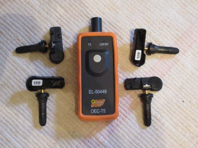

I just use my hand held re-set tool whenever I rotate tires or swap winter/summer tires.
